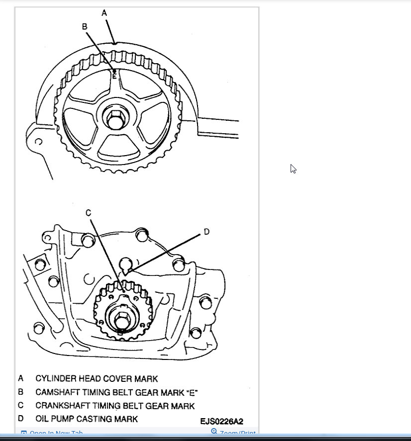

I changed the timing belt. Found the old one had skipped. I have set the cam the notch that has the E on it to the specified mark on the top of the motor and the crank is set to TDC on the number 1 cylinder. Tried to test fire it and all it does is backfire. Can you help?

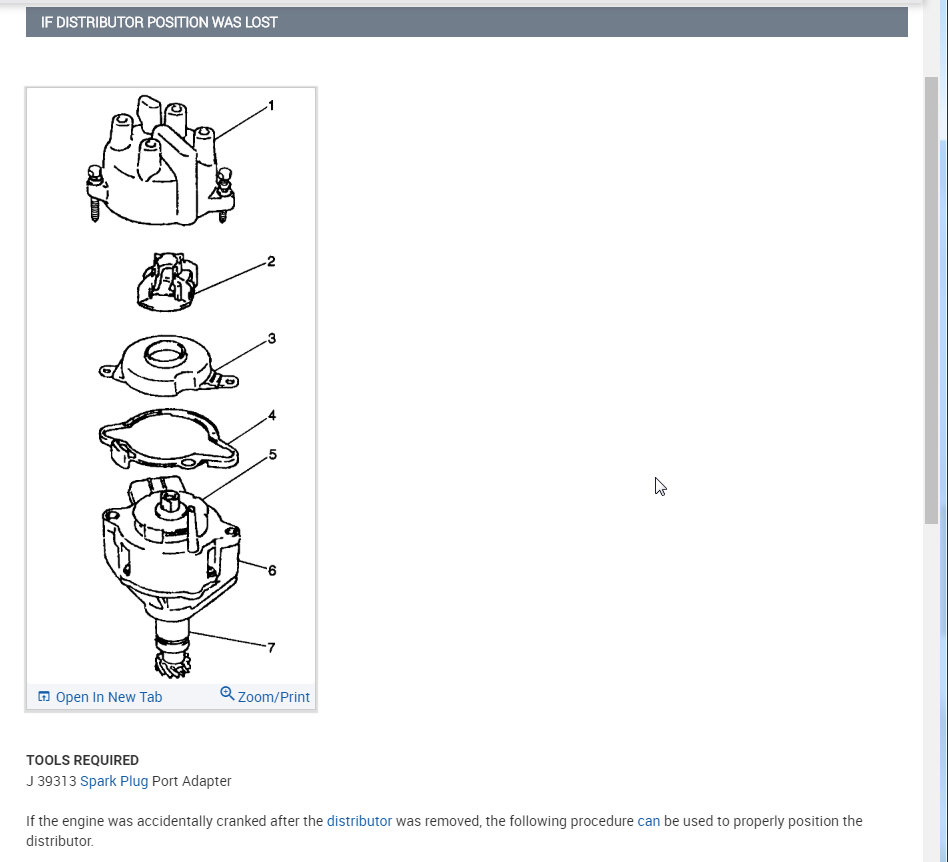

To add some more information. When I received the vehicle in a trade it was not running and some flooding issues. I have purchased all the necessary things to correct that but in my pursuit noticed the distributor didn't look right. so I have pulled it had set it back with the rotor button pointing to the the number one plug wire.

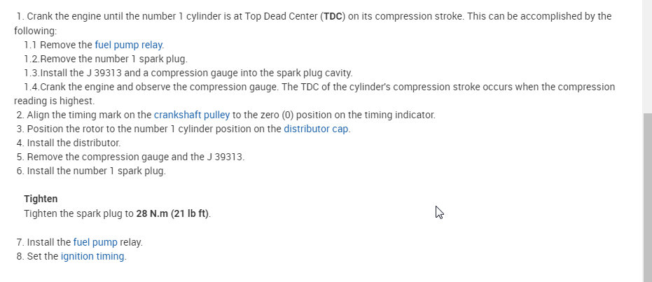

Before we address the timing belt, I am concern that you may just have the distributor 180 off. If you follow this process you can at least confirm it is correct.

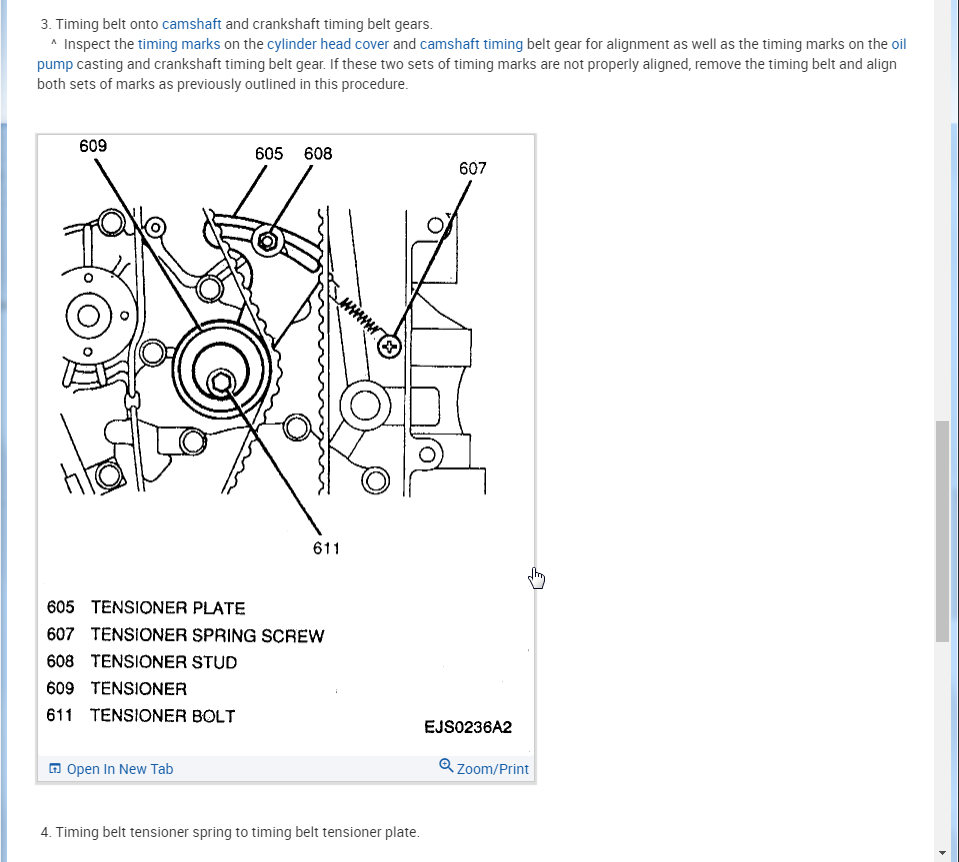

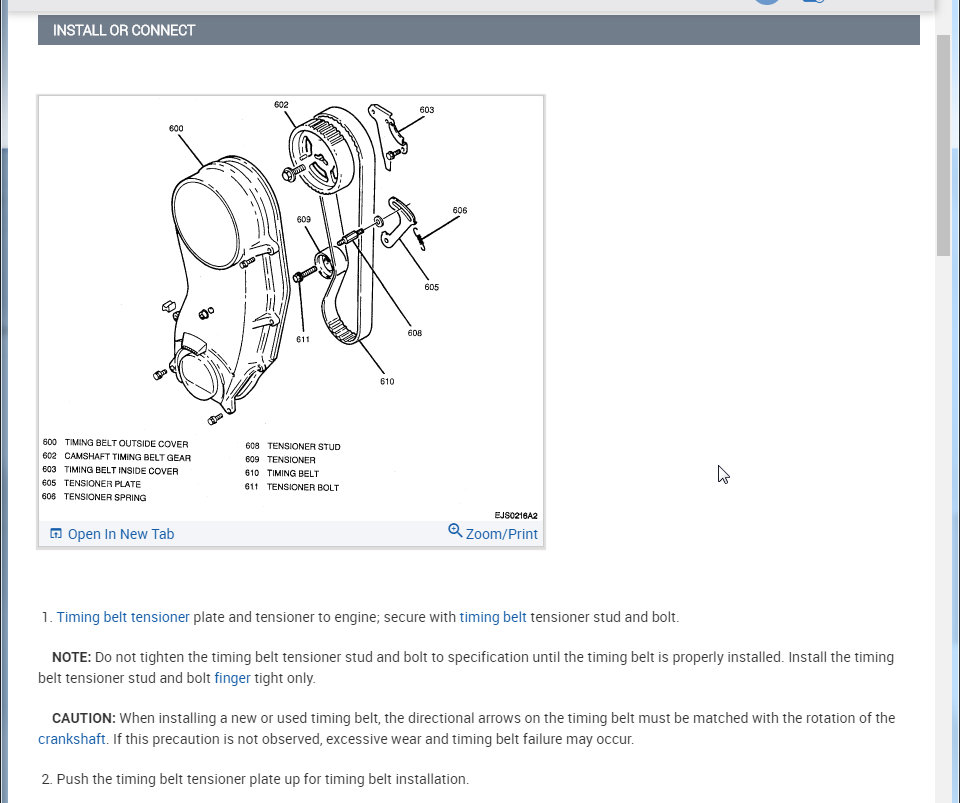

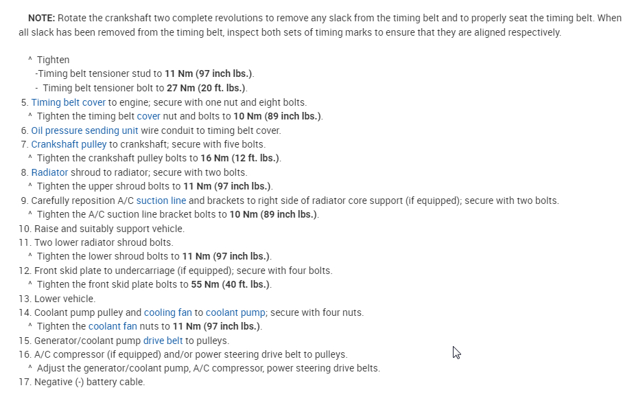

I then attached the process for the timing belt is that checks out for you to review.
Take a look at this info and let us know what you find. Thanks

You are correct but when you install a distributor number 1 cylinder needs to be on TDC of the compression stroke. If you set it up with number one on the exhaust stroke by mistake then the timing will be off 180 degrees because your distributor is off not the cam/crank. It is easy to do because I have done it.
Does that make sense?
