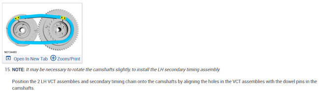

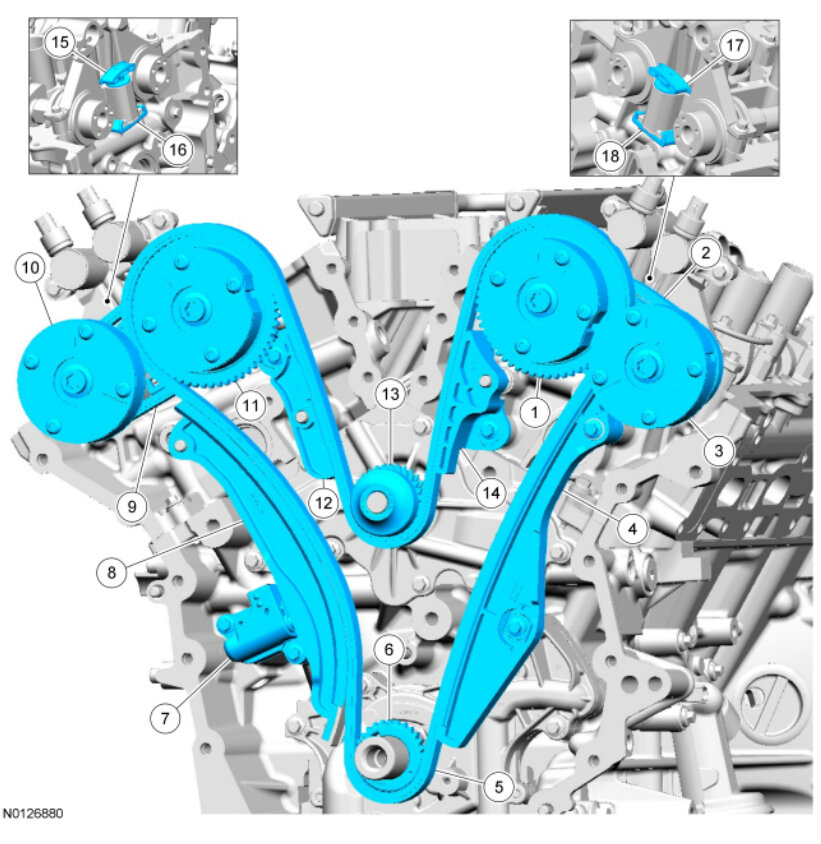

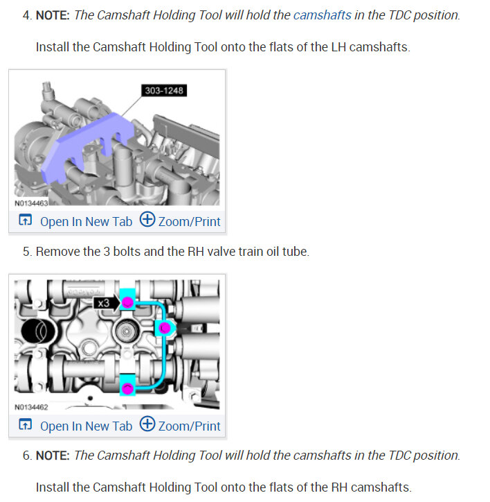

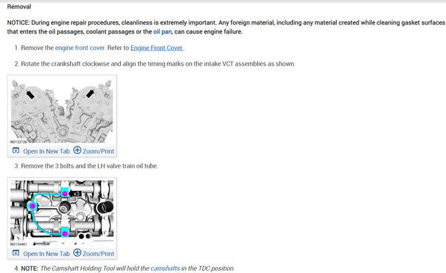

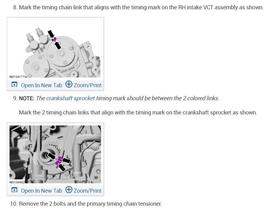

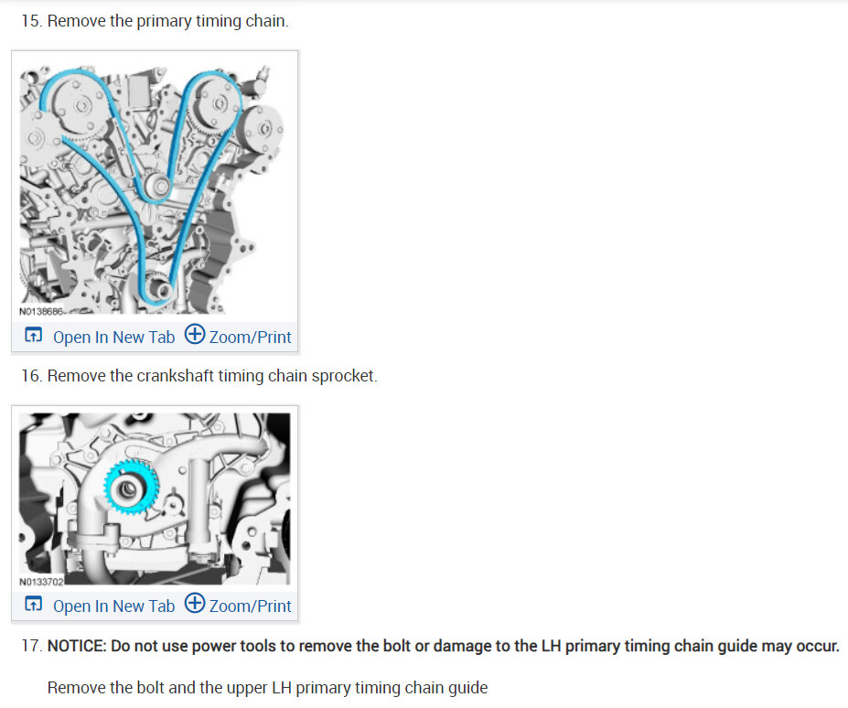

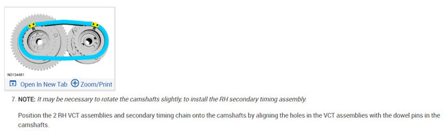

The vehicle water pump is bad, it has been replaced but I am having a problem in setting the Timing of the engine correctly. Please could I know the procedure to follow. I would be very grateful if you could be of help. I know that I disturb a lot.

Yes, I mean the timing of the cramkshaft to the crankshaft.

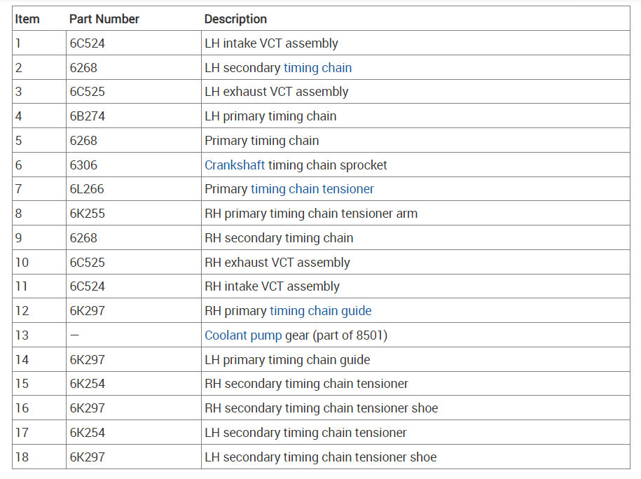

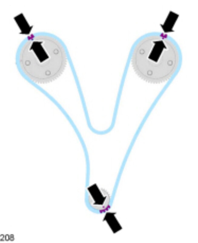

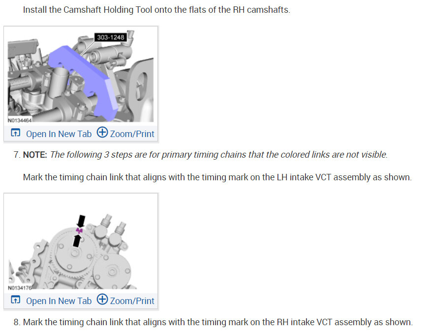

Sure, here are the timing chain marks for the camshaft and crankshaft. They look pretty straight forward with marks on the timing chain to align with the marks on the sprockets. Check out the images (below). Let us know if you need anything else.
