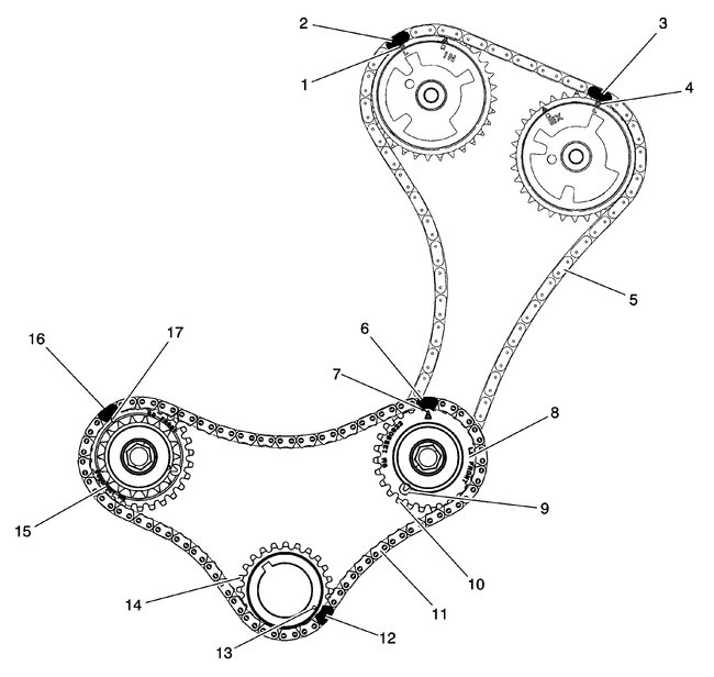

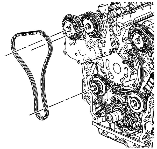

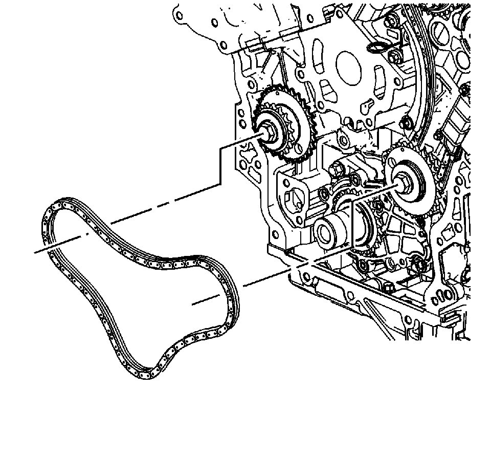

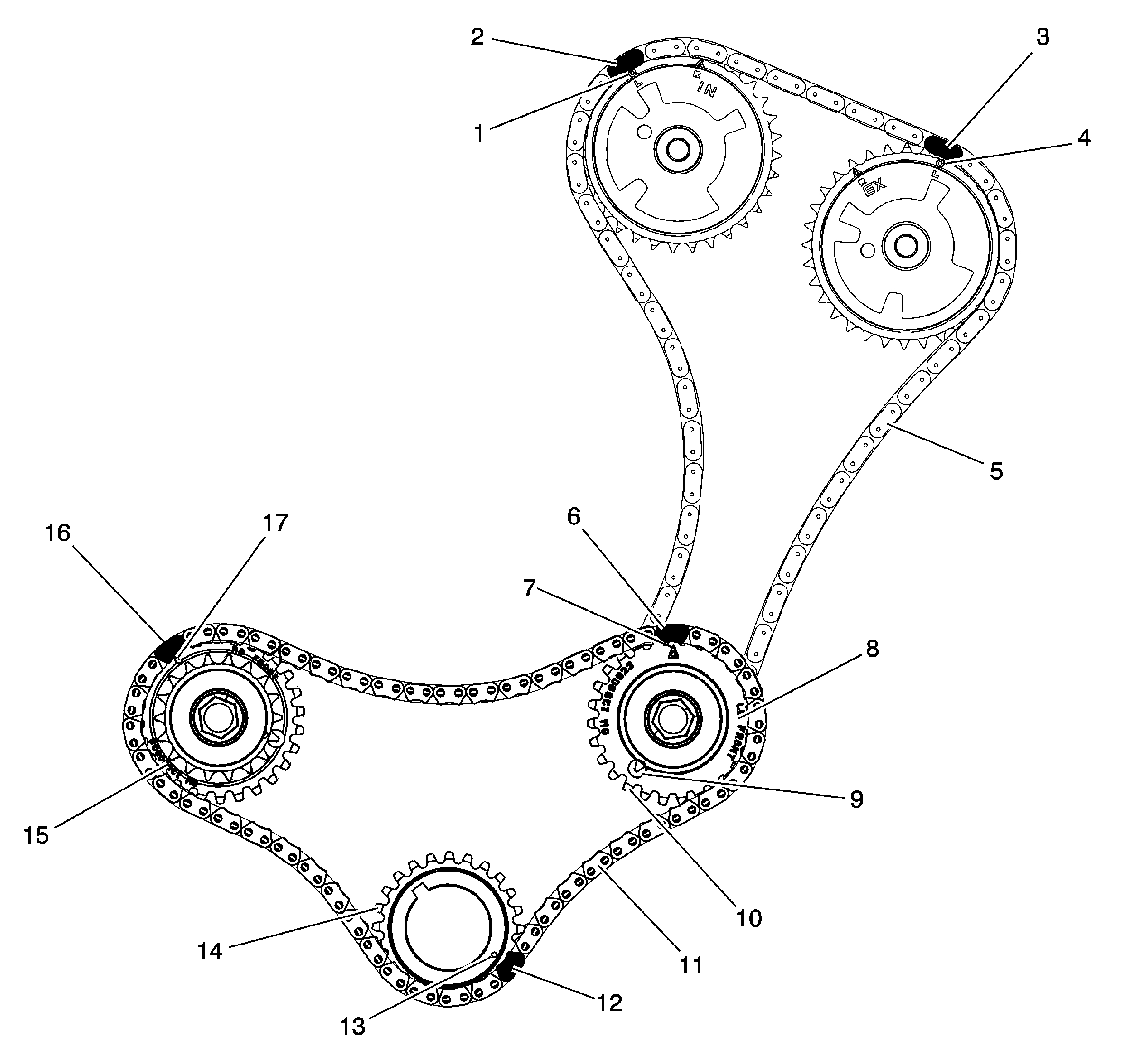

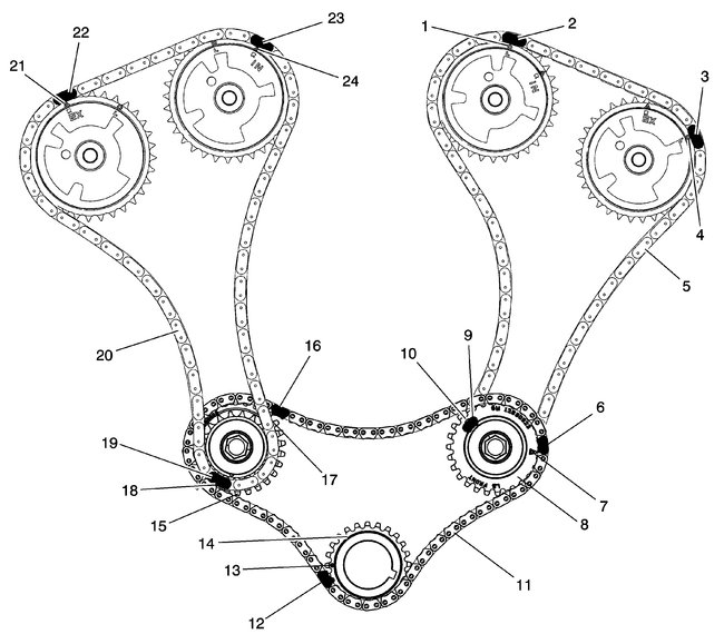

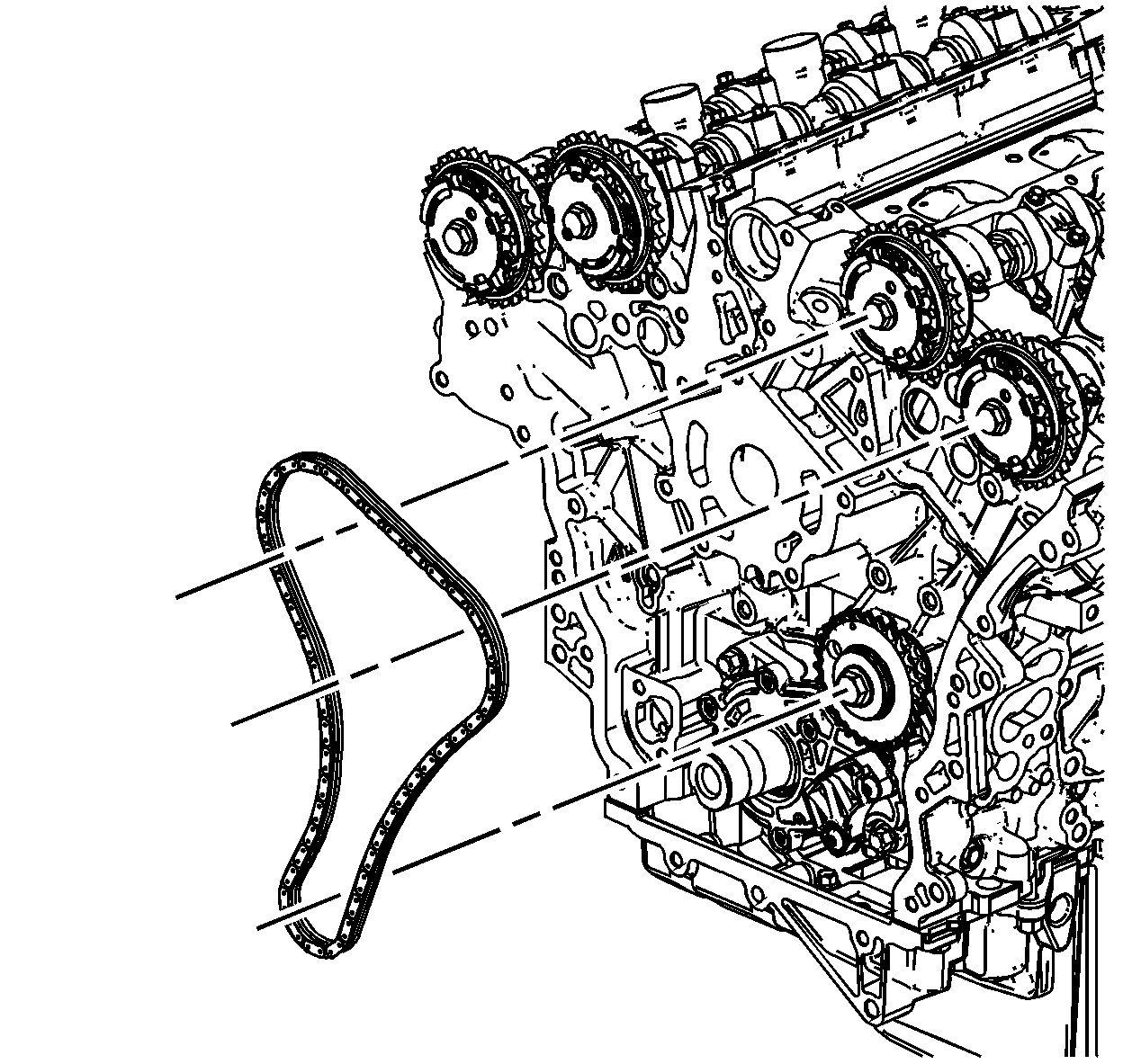

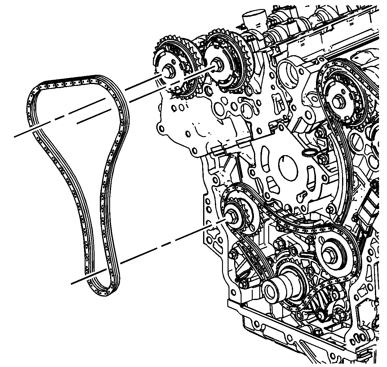

Chain wants to come up when setting the timing.
Apr 30, 2020 at 4:18 AM
  • 110,240 POSTS
I'm not sure which chain or exactly what is happening. Here are the basic directions for the primary and both left and right cam chains. Take a look through them to see if something was missed and if they help. The attached pics correlate with the directions.

6. Remove the primary camshaft drive chain tensioner. See: Engine > Overhaul > 27. Primary Camshaft Drive Chain Tensioner Removal
7. Remove the primary camshaft drive chain upper guide. See: Engine > Overhaul > 28. Primary Camshaft Drive Chain Guide Removal - Upper
pic 1
8. Remove the primary camshaft timing chain. See: Engine > Overhaul > 30. Primary Camshaft Drive Chain Removal
Installation Procedure
pic 2
1. Install the primary camshaft timing chain. See: Engine > Overhaul > 121. Primary Camshaft Drive Chain Installation

13. Remove the left bank camshaft intermediate drive chain idler. See: Engine > Overhaul > 36. Camshaft Intermediate Drive Chain Idler Removal - Left Side
pic 3
14. Remove the left bank secondary camshaft drive chain. See: Engine > Overhaul > 35. Secondary Camshaft Drive Chain Removal - Left Side
15. Clean and inspect all of the camshaft timing drive components. Replace components as necessary. See: Engine > Overhaul > 71. Camshaft Timing Chain and Sprocket Cleaning and Inspection
pic 4
1. Install the left bank secondary camshaft drive chain. See: Engine > Overhaul > 116. Secondary Camshaft Drive Chain Installation - Left Side

4. Remove the right bank secondary camshaft drive chain guide. See: Engine > Overhaul > 25. Secondary Camshaft Drive Chain Guide Removal - Right Side
pic 5
5. Remove the right bank secondary camshaft drive chain. See: Engine > Overhaul > 26. Secondary Camshaft Drive Chain Removal - Right Side
pic 6
1. Ensure the stage 1 camshaft timing is correct. See: Timing Component Alignment Marks > Components
2. Install the right bank secondary camshaft drive chain. See: Engine > Overhaul > 125. Secondary Camshaft Drive Chain Installation - Right Side

I hope something here helps.
Let me know,
