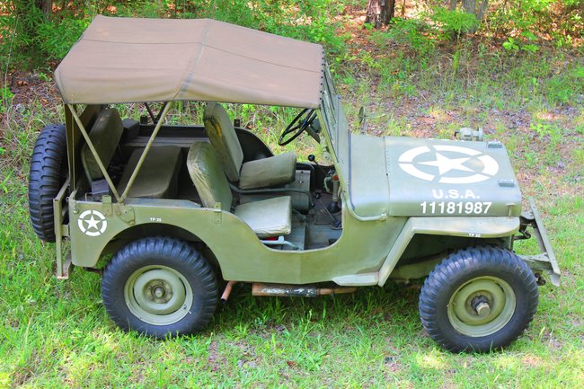

Disregard the pictures oriented towards the Jeep repair.
Not only video, but if you read on through this you will see the way I prefer to do it using a wrench or ratchet instead of bumping the starter.
https://www.2carpros.com/questions/1978-jeep-cj5-engine-wont-start/page/3
Even though this was written to a Jeep guy, the procedure is still the same.
