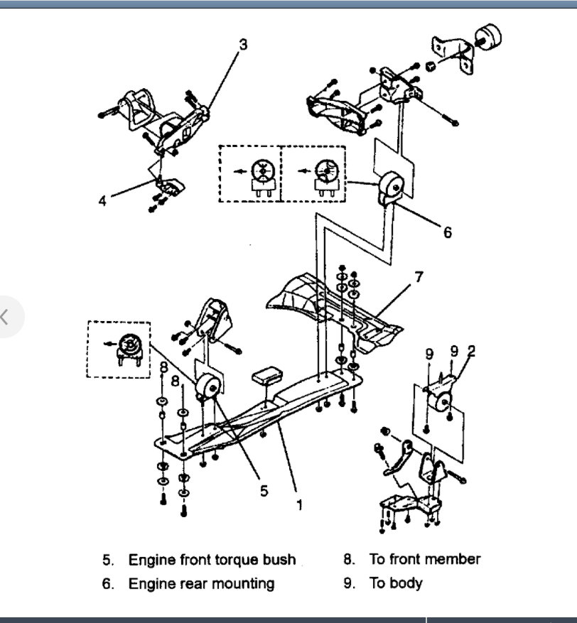

Want to install rear engine mount.
Engine is up by jack.
Cannot install the mount because not enough room.
When jack up engine, the car is up as well.
Should I loosen the other mounts?
Could I damage the car/engine if I will increase the jack up?
link to the 4th underbelly mount:
https://drive.google.com/file/d/1aQgnpihvYa8GNGt7bkfawapTBZYVBFAH/view?usp=sharing
schema of whole engine
https://drive.google.com/file/d/1b5yCyFofnrGKjPkcuFd5pXpFHvogjFMr/view?usp=sharing
schema of right and left mount
https://drive.google.com/file/d/1AYGKejHEOVNLbpWvUakN65KE3kmNuAgx/view?usp=sharing
pic of rear mount (not installed yet)
https://drive.google.com/file/d/1b3xl2bYuXZ2XPvBUC_yGQXEbVita8FkP/view?usp=sharing

That is correct. You will want to loosen the other mounts so that you can get some separation in order to gain access.
Here is a guide that will help with this in general:
https://www.2carpros.com/articles/replace-motor-mounts
However, you will not damage anything at all by loosening them. Just be very careful that you make sure you have them still with holding with at least a few threads so that you don't drop it on the ground or worse, on yourself.
Please let us know what other questions you have on this. Thanks
