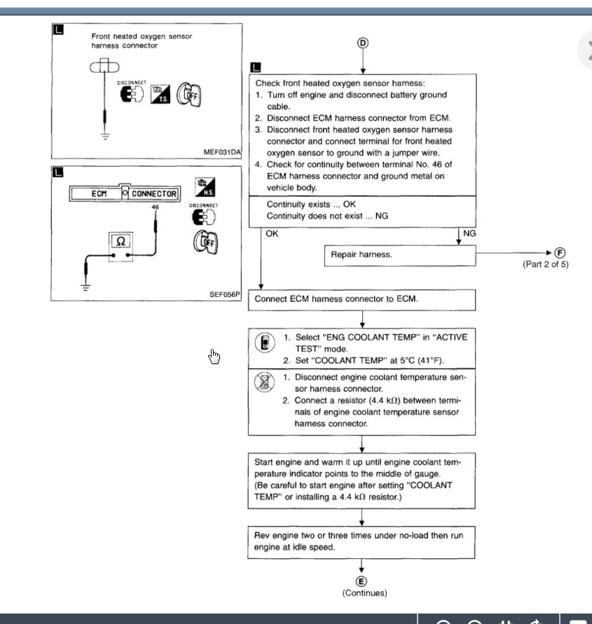

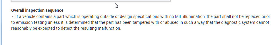

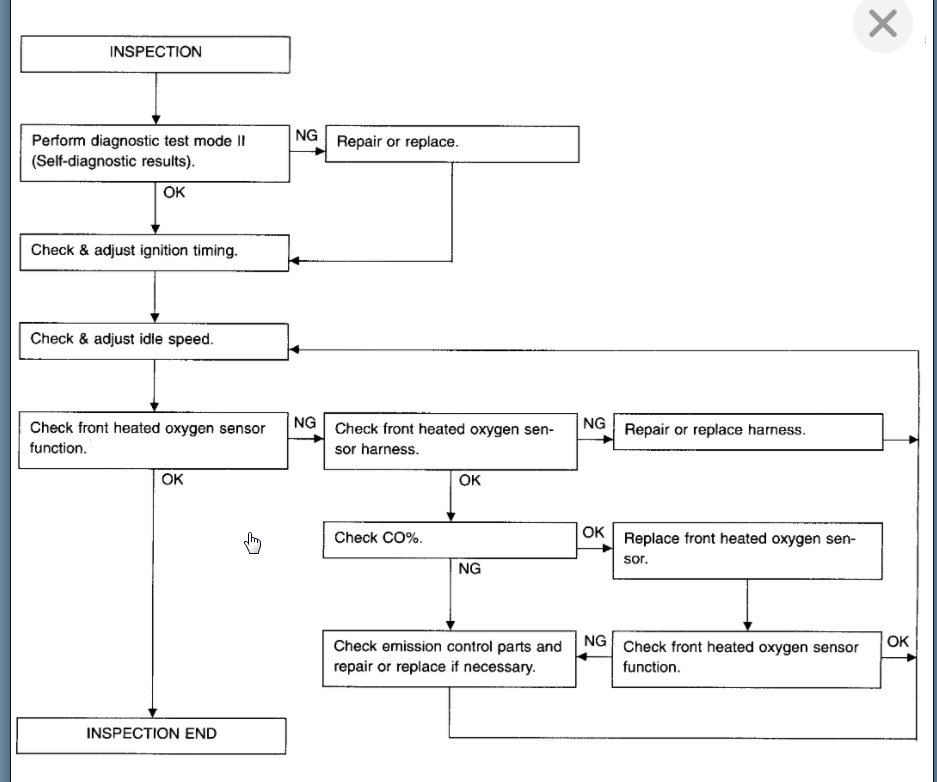

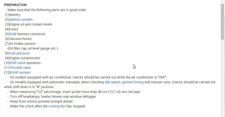

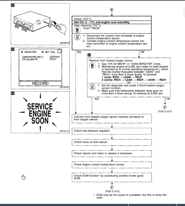

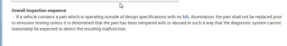

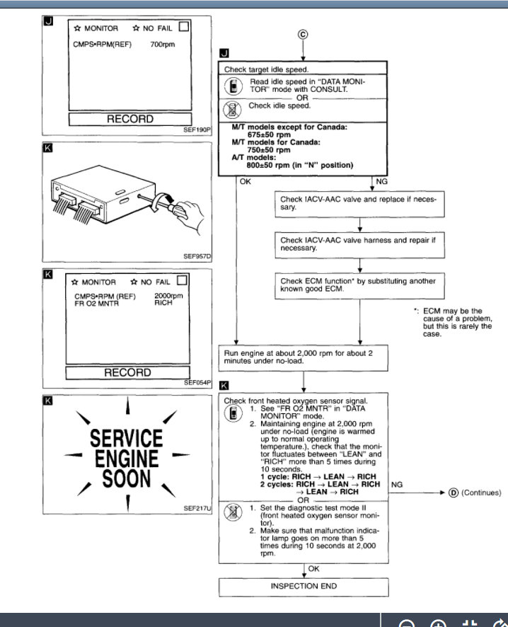

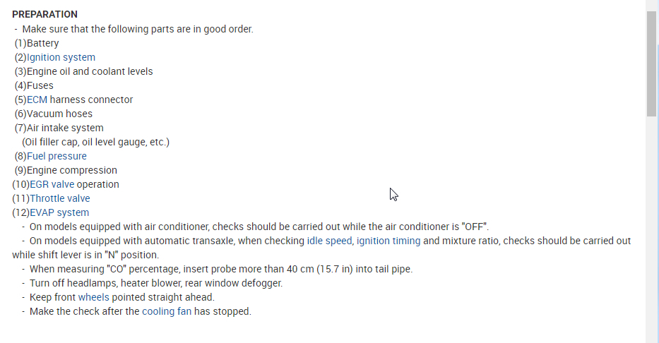

I am attaching the inspection process and info that you should need. So let's run through this and let us know if you need more info. Check out the diagrams (below). Please let us know if you need anything else to get the problem fixed. Thanks

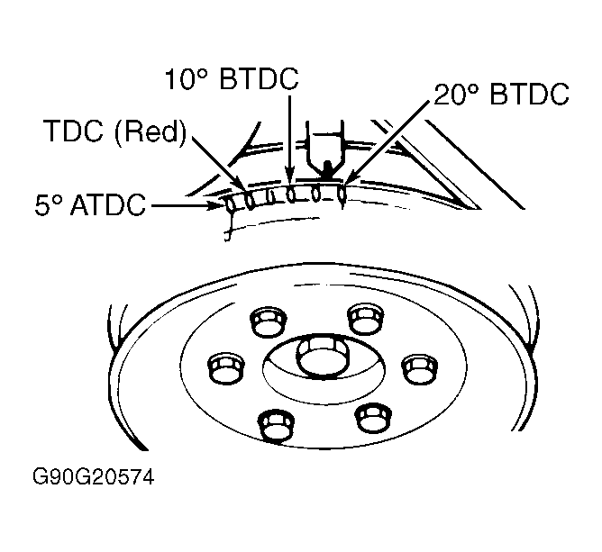

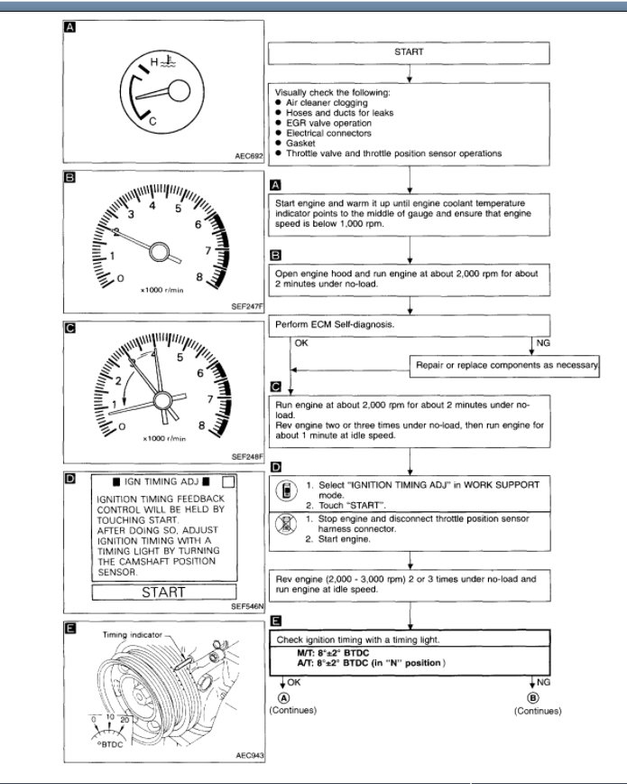

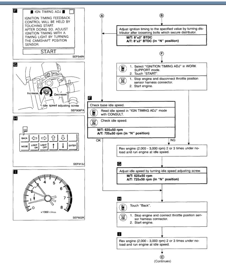

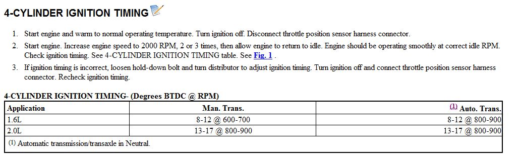

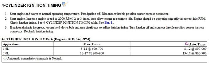

how do I check the base timing on a 94 sentra 1.6 DOHC

To set the ignition timing follow the diagrams below. Check out the diagrams (Below). Please let us know if you need anything else to get the problem fixed.
