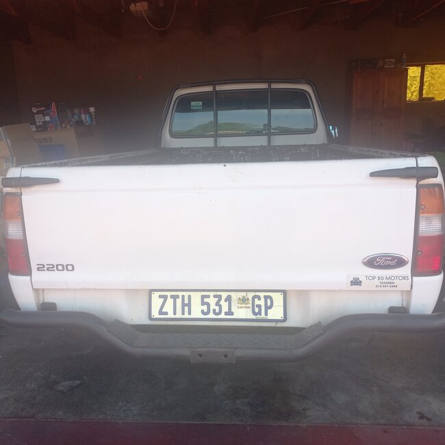

2001 FORD RANGER
263,456 MILES • 2.2L • 4 CYL • MANUAL
SAMUEL BUTIKI KULA
As I am not a mechanic, and my motor mechanic stays far away and left when we had a problem with a starter after he set the timing, and I had to get an auto-mechanic after the Christmas vacation to fix the starter and now the car is cranking and idling.
The motor mechanic once taught me that if the timing is set accurately the distributor must be at the center. But now to ignite the car the auto-electrician has put the distributor at the far end of clockwise corner if he brings it towards the center, it switches off. He said it requires a motor mechanic to fine tune the timing.
So, I want to fine tune the timing.
This is a Ford Ranger 2200 F2 Engine (petrol).

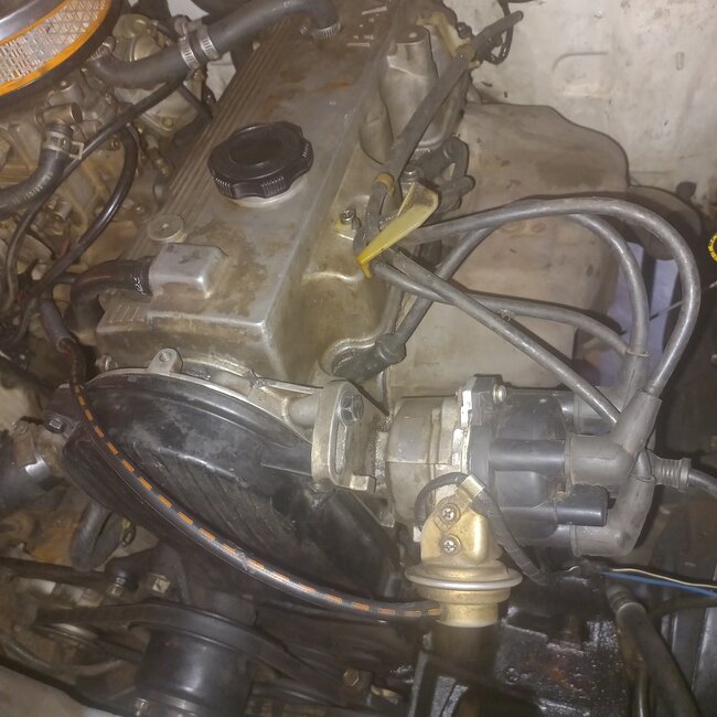

There is no 2.2-liter engine for this truck, does it have a different engine? Can you please upload an image of the engine so I can confirm? There is a 2.3-liter engine, but it does not have an ignition distributor.
Jan 15, 2025 at 10:43 AM
SAMUEL BUTIKI KULA
Yes there is, it is 2200 (2.2) see attached photos.
Jan 15, 2025 at 3:53 PM
  • 55,412 POSTS
Yep, that is not a Ford engine, it looks like a Mazda. The timing can be correct even though the timing adjustment is not in the center, is this the only problem you are having?

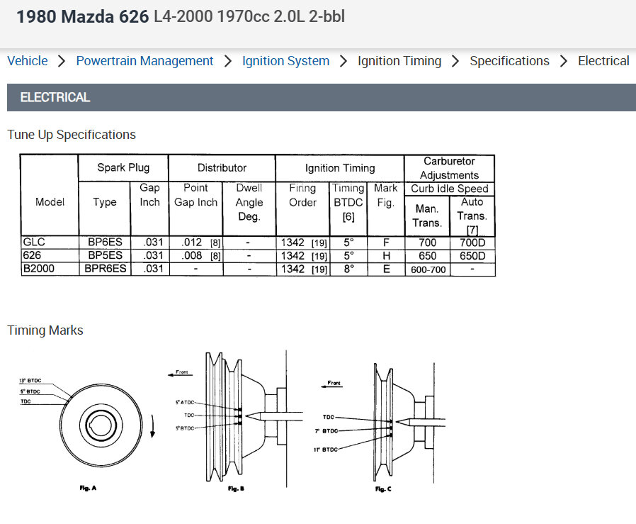

Yes, this might be. You will need a timing light to set the timing at 8 degrees TDC. Please go over this guide as well:
Check out the images (below). Let us know what you find.
