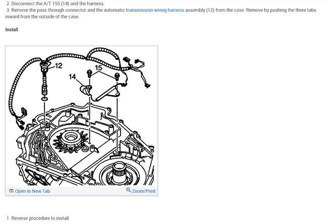

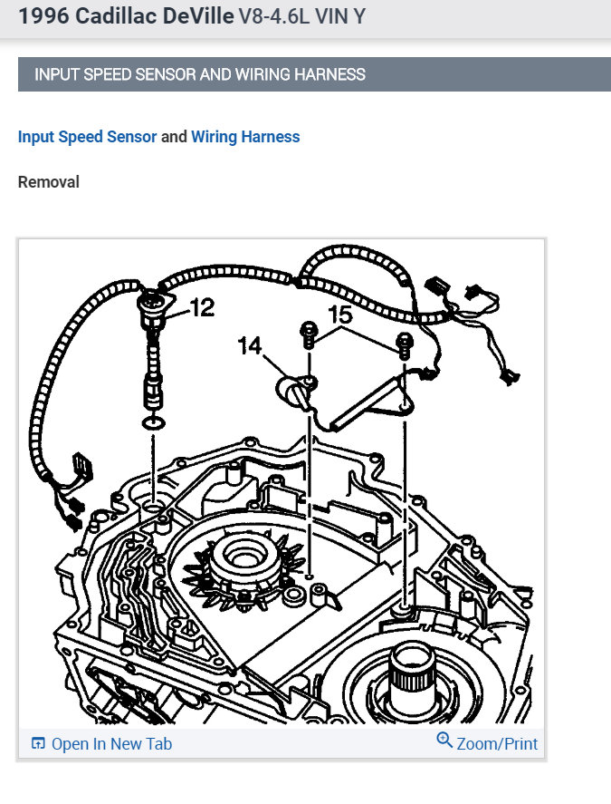

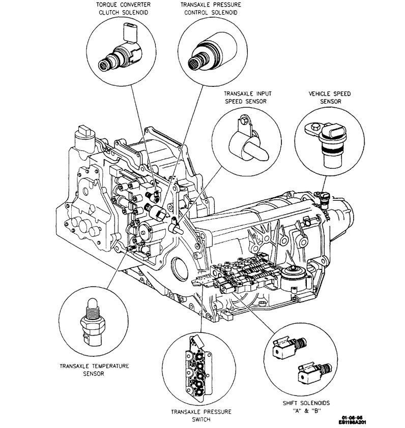

P0717 was the code I'm seeing from the printout last time. Probably will try and run it again today.
May 7, 2019 at 1:15 AM
  • 55,433 POSTS
That code is for the turbine shaft speed sensor (trans-axle). here is a the location and institutions on how to change it. Check out the diagrams (below). Please let us know what happens.
