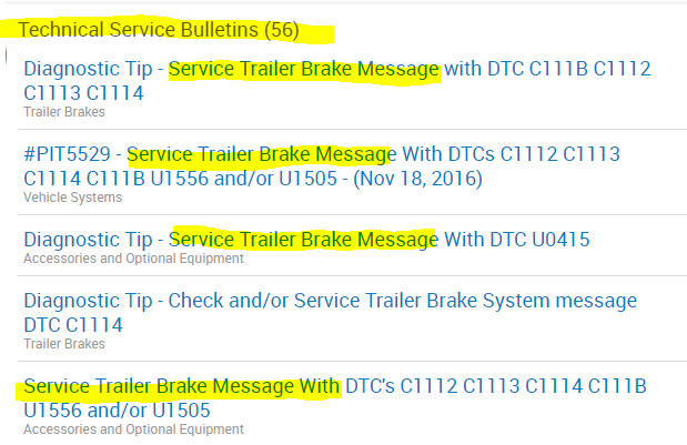

Interestingly, there are multiple technical service bulletins related to the "Service Trailer Brake System." See pic below. Note that there are several other bulletins for this message.
I looked through a couple of them. Just to let you know, one of the things was a weak battery. However, what you are doing is a perfect test. I'm interested in knowing what you find.
If the battery isn't the issue, we need to scan the can-bus to see if there are specific codes related to the issue. You'll notice that there are codes listed in the pic below. Without knowing which one or ones are present, it becomes a guessing game.
CAN stands for controller area network. Basically, the different modules are tied together via a few wires. This type of scan will retrieve codes regardless of the module storing them.
Here is a link that shows how it is done:
Let me know if that is something you can do or have done. Also, let me know the outcome of the battery test.

Well, it was the battery after all. After pulling the fuse and charging the battery fully, it started for the next two days until he carried it to the dealer concerning the "Trailer Brake" message displayed. Dealer tested battery and said it had low voltage and that was what was causing the message to appear (just like you said you saw in a Factory Service Bulletin). When questioned about why it tested OK at Advance Auto Parts , they stated their equipment was much more sensitive. Anyway, dealer replaced battery, message went away and has not reappeared. Maybe this experience will help others if they get the "Trailer Brake" message. First order of business if to check battery voltage.
