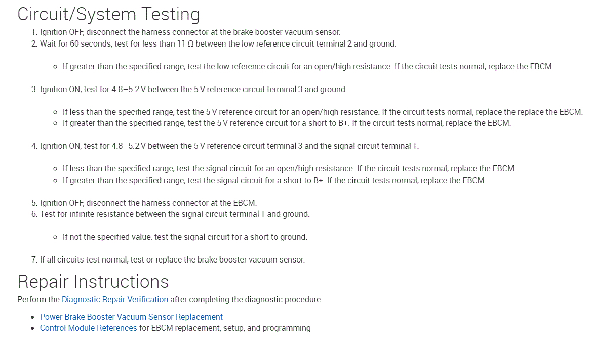

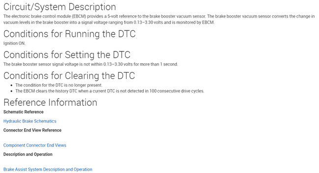

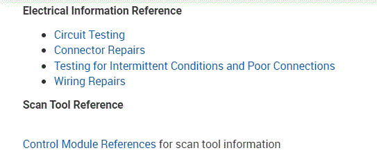

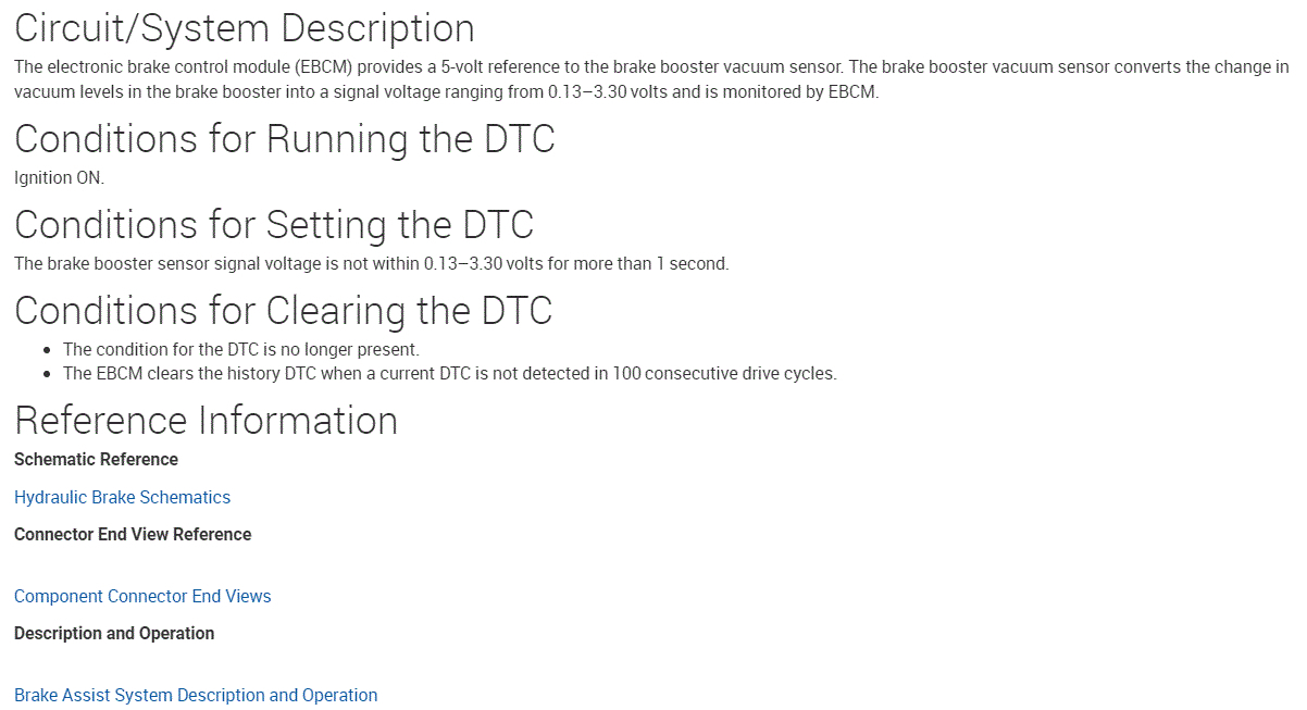

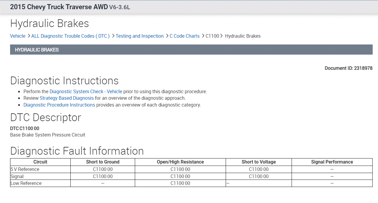

If everything checks good, then we need to check the EBCM. I attached the diagnostics below for you. Let me know if you are comfortable performing them or if you have other questions.
Here is a link you may find helpful.
