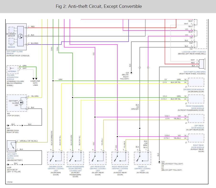

my car was running fine and then one day the alarm started going off on its own and I couldn't get it to go off for about 30 seconds no matter what I tried. I started the car and it continued for a few more seconds and then stopped but the SID said service theft system and I drove down the road and made it about 1 mile and the car started sputtering like it was out of gas and died and would not restart. since then I have got it to start 3 other times each time dying when it reaches operating temperature. but now it wont start at all and just keeps cranking. if anyone knows what I need to do to fix it I would greatly appreciate the advise.
oh yeah, and after all this happened I changed out the crankshaft positioning sensor and it still will not start.

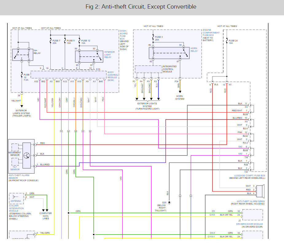

Lets run the codes to see if the crankshaft sensor is causing the issue. Also if the BCM is going out it will cause this issue. Here is a CAN video to help confirm the BCM failure and the security system wiring diagrams so you can see how the system works:
and
https://youtu.be/InIlnsjOVFA

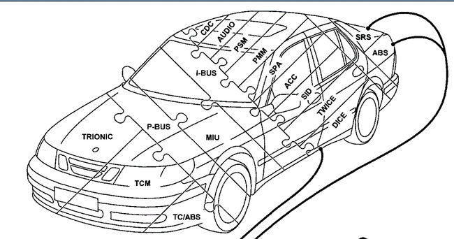

All control modules in the Saab 9-5 are connected to the CAN bus with the exception of ABS and SRS. I really feel you should scan the CAN bus system as Ken mentioned to see if there is a break down at the BCM before you replace it.
I attached a pic below showing the bus system on the vehicle. There are only two, P-bus and I-bus. These systems are all tied together with two wires. If there is a break down, it can shut several things down. In this case, the anti theft is engaged.
Try the CAN scan mentioned. Otherwise, it will become a guessing game. Let us know what you find.
