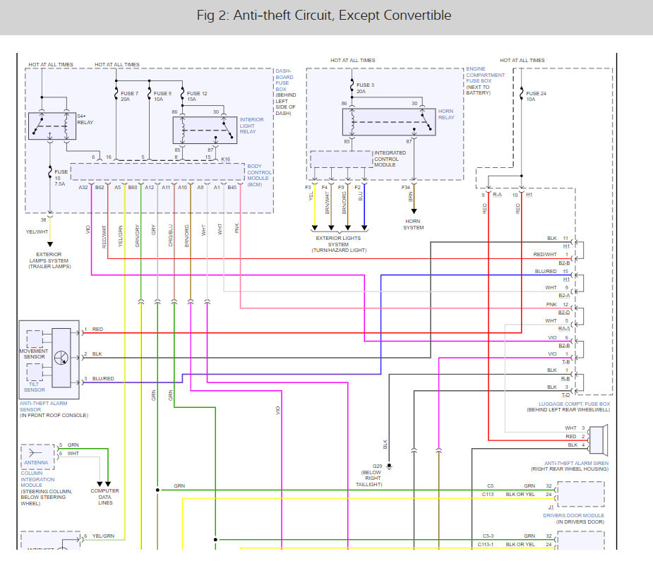

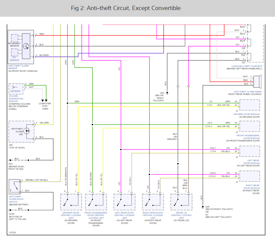

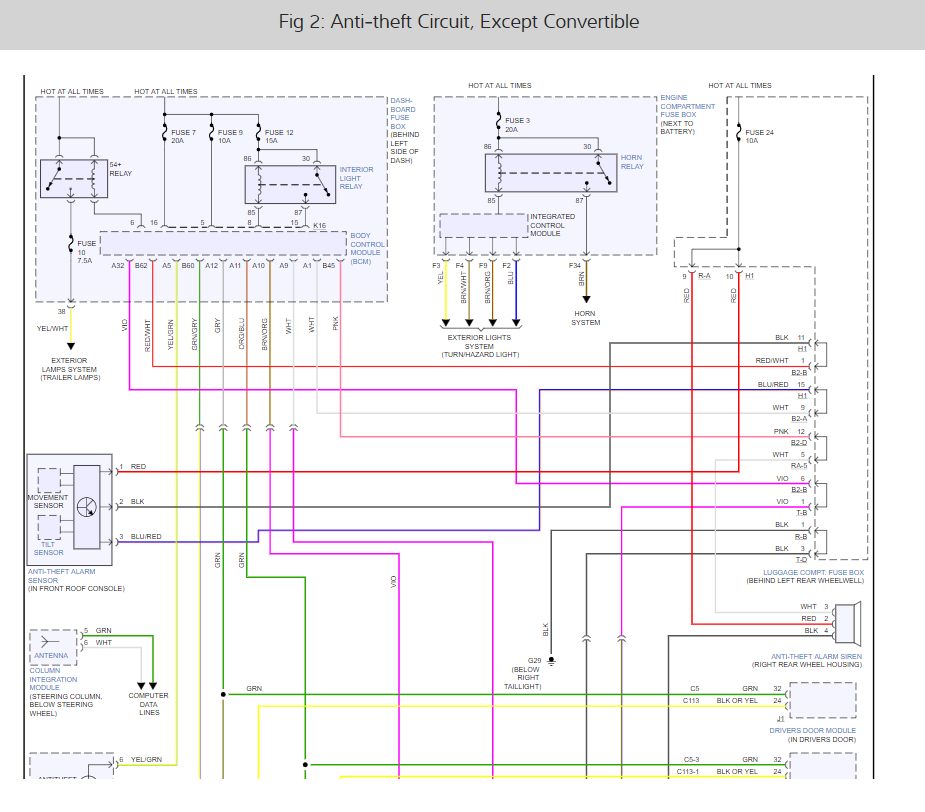

Lets run the codes to see if the crankshaft sensor is causing the issue. Also if the BCM is going out it will cause this issue. Here is a CAN video to help confirm the BCM failure and the security system wiring diagrams so you can see how the system works:

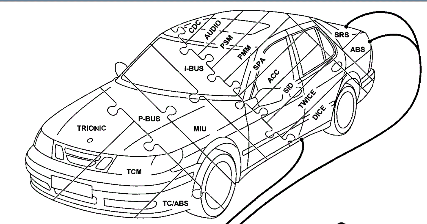

All control modules in the Saab 9-5 are connected to the CAN bus with the exception of ABS and SRS. I really feel you should scan the CAN bus system as Ken mentioned to see if there is a break down at the BCM before you replace it.
I attached a pic below showing the bus system on the vehicle. There are only two, P-bus and I-bus. These systems are all tied together with two wires. If there is a break down, it can shut several things down. In this case, the anti theft is engaged.
Try the CAN scan mentioned. Otherwise, it will become a guessing game. Let us know what you find.
