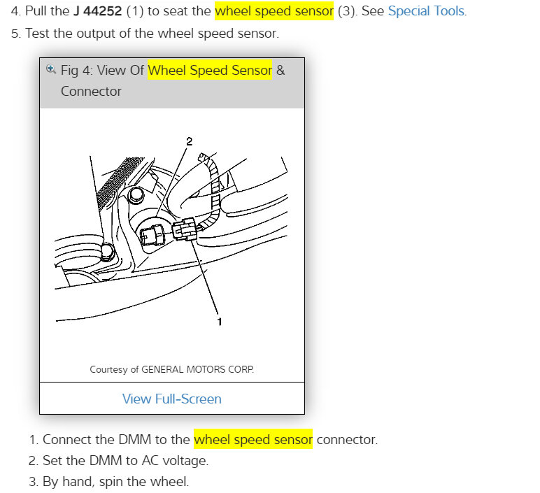

The Service Stabil Trak light comes on the dashboard but, sometimes it goes back out after a couple of days.
Jul 21, 2023 at 12:07 PM
Experienced Mechanic
55,647 POSTS

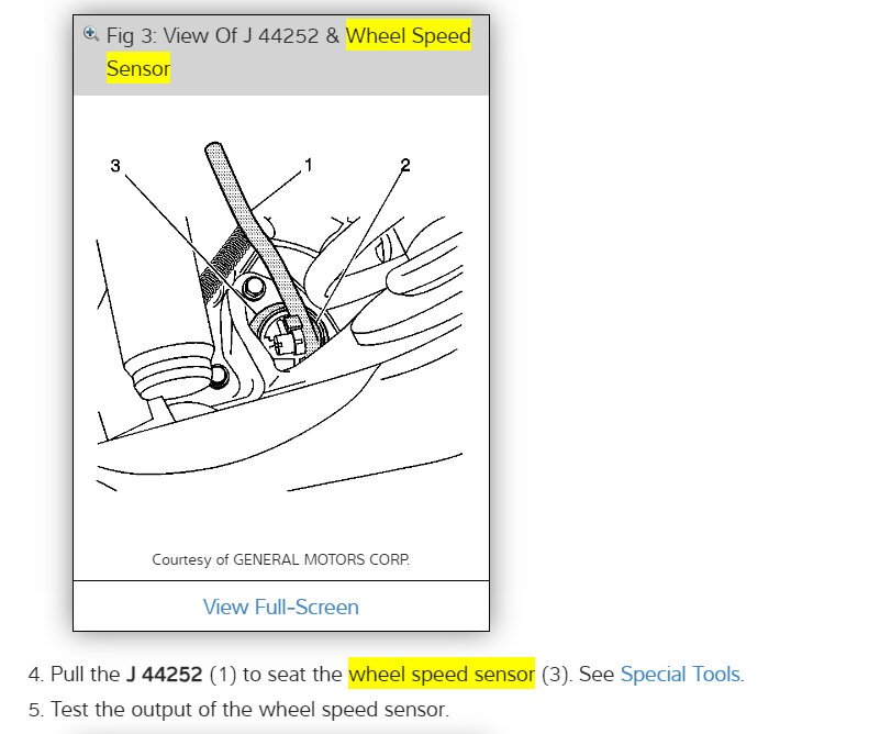

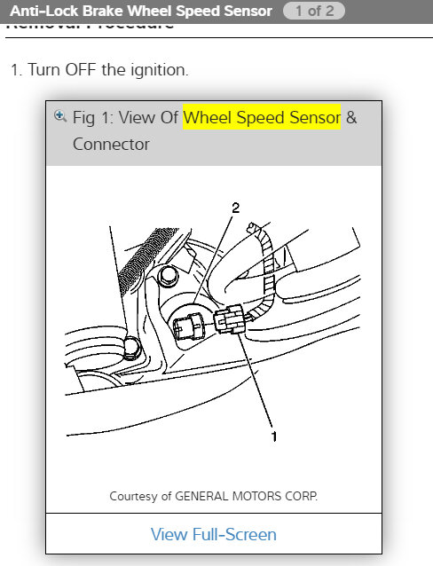

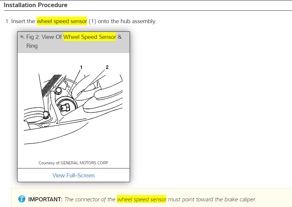

It sounds like you have a wheel speed sensor that is going out, we need to run the codes to see which one it is. this guide can help:
https://www.2carpros.com/articles/anti-lock-system-testing-and-repair-abs
Here is how to change the wheel speed sensors out in case you need it. Check out the images (below). Please let us know how it goes.
Images (Click to enlarge)
