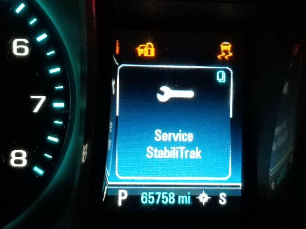

Hi, I hope you can help me. I changed my front brakes and front passanger side brake rotor three hours ago, after I was done I drove it for a few blocks and all of the sudden I got a service stabilitrac. I am attaching picture. Do not know if this will help, but while I was changing my brakes my battery died. I guess battery is not so good anymore. So I jump started it. Do not know if this might interfere with this warning light I pressed the traccion control button on and off to see if any changes but no luck. Hope you can help. Thanks

When you changes the brake rotors and did the brakes chances are you might have disconnected a wire or caught a electrical connector. The battery going dead wont make the warning light come on. Please remove the tires again and look at the ABS sensor wires you might want to do this test as well.
https://www.2carpros.com/articles/abs-wheel-speed-sensor-test
