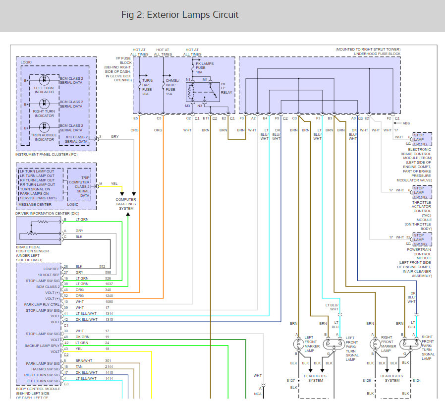

My car is saying service park lamps and all the lights flash and drains the battery. I have to keep unplugging the battery. Now my stock radio has no sound and I do not know why. Please help.

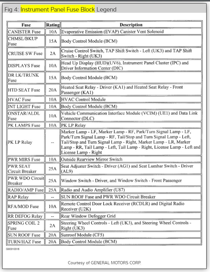

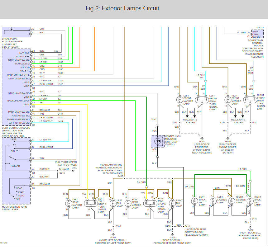

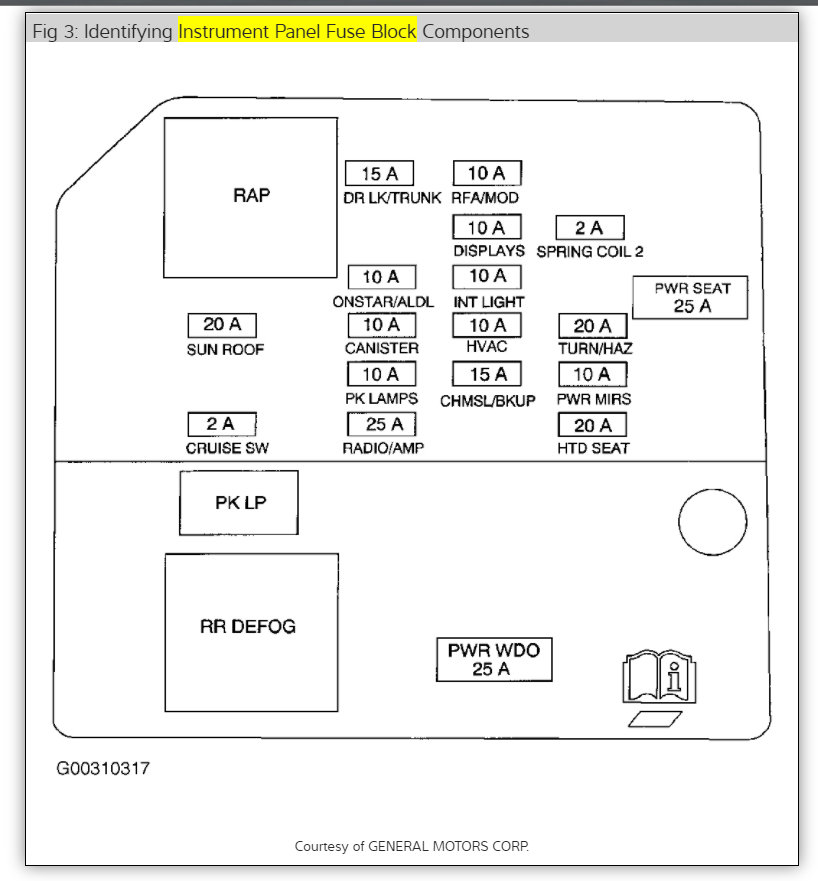

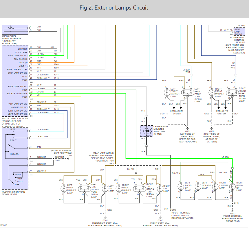

This sounds like you have a parking lamp relay that is stuck on. Here is a guide to help you confirm the issue and the location of the relay I have also included the wiring diagrams so you can see how the system works:
Check out the diagrams (below). Please run this test and get back to us.
