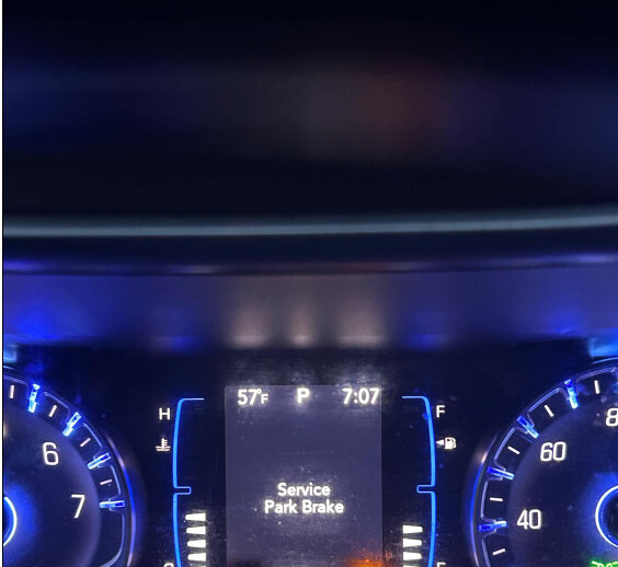

warning light on dash which indicated something with the parking brake?
2021 CHRYSLER VOYAGER
80,000 MILES • 3.6L • V6 • 2WD • AUTOMATIC
BRENTULRICH88
  • 38 POSTS

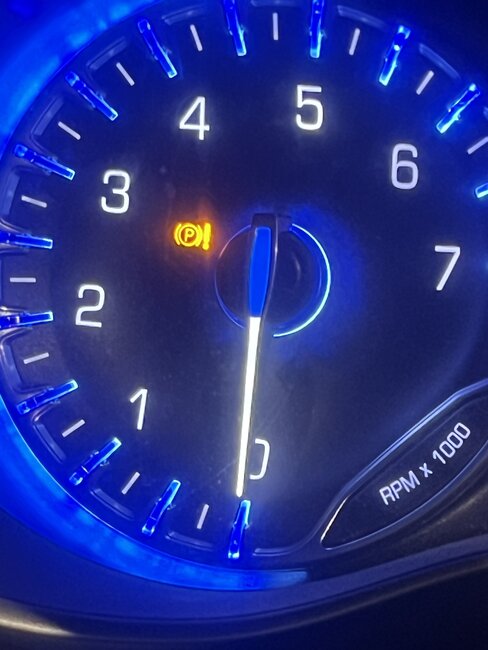

I had my van aligned and when my wife picked it up it had the yellow p in a circle warning light on dash which indicated something with the parking brake. When my wife turned off the van it then said, "Service Park Brake." It drives fine. I feel like when the dealership aligned it, they may have put it in the service brake mode and never took it out.
Please advise. Pictures Attached.
Thanks!
Sep 24, 2024 at 5:14 AM
  • 54,832 POSTS
You are correct, they did need to put the car in service mode to align it. Here is how to clear the service mode and cancel the warning light.

1. Turn on the Ignition
2. Activate the Parking Brake
3. Press and Hold the Brake Pedal
4. Operate the Electronic Parking Brake Switch
5. Hold the electronic parking brake switch in the "Release" position for 5 seconds, then hold it in the "Apply" position for 5 seconds.
