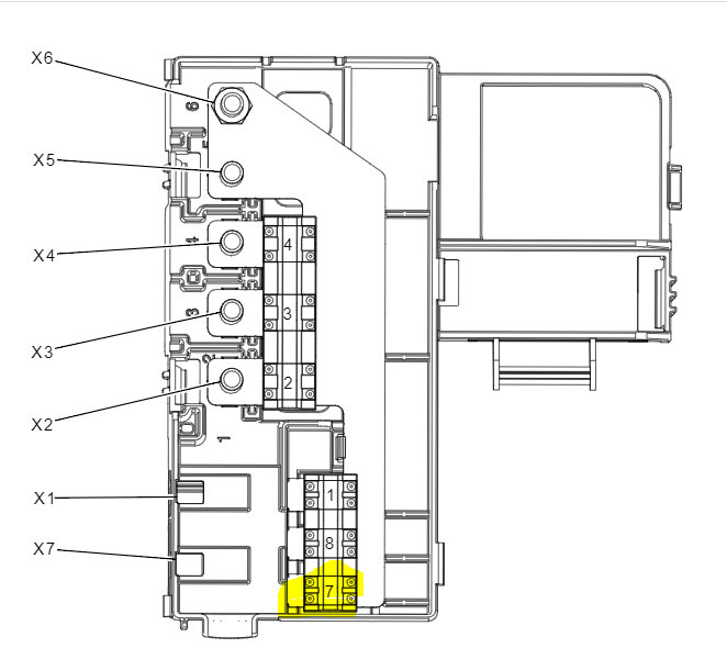

Since battery replacement I have a service air bag light on, A/C blower doesn't work yet all function lights are illuminated, radio doesn't work, and Stabil track light in cluster is on.

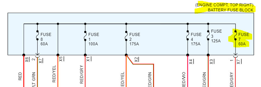

I need you to check fuse 7 in the under-hood battery fuse box (see pic 2). It is a
60-amp fuse that powers the things you mentioned. Actually, it sends power to a fuse box under the dash, right side. From there the power is distributed to other fus.es covering the items of interest.
When you check the fuse, make sure there is power to and from it. I suspect if you were to check the fuses related to the affected components in the fuse box on the right side of the dash, you would find they are not getting power.

Thanks for the reply. I fixed it .
Hate to admit it but the 4 wire spade plug was left disconnected at the junction box on top of the battery . That I didnt catch at 1st . Thanks again
