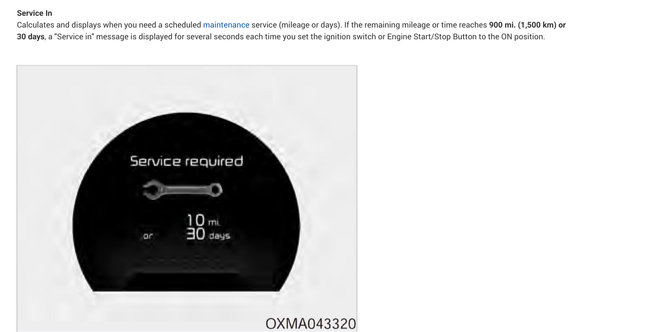

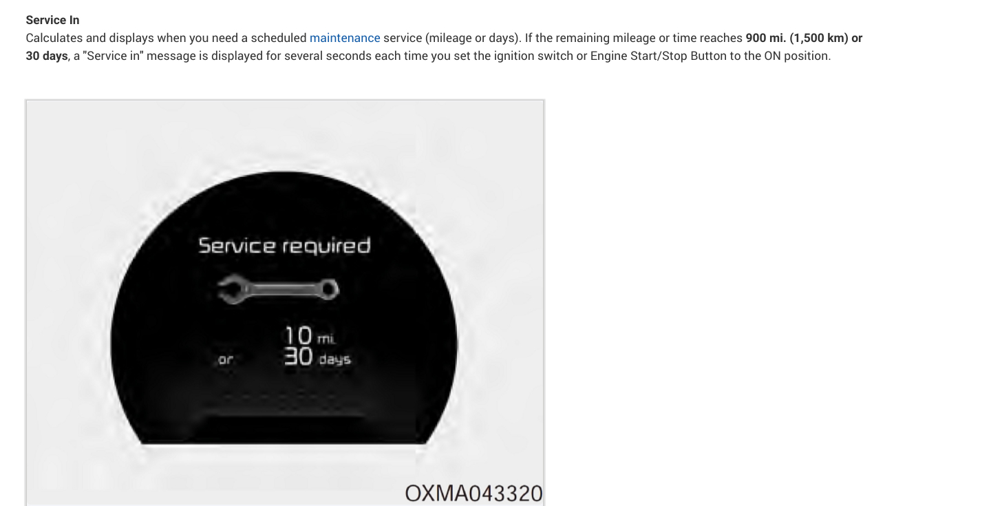

Hi, I got my car serviced (oil change) on December 7th but my service light turned on again. I just took it to a auto shop and they reset the light but it still says "service in 30 days or 5,000 miles".
Jan 8, 2020 at 9:12 PM
SCGRANTURISMO
  • 4,897 POSTS

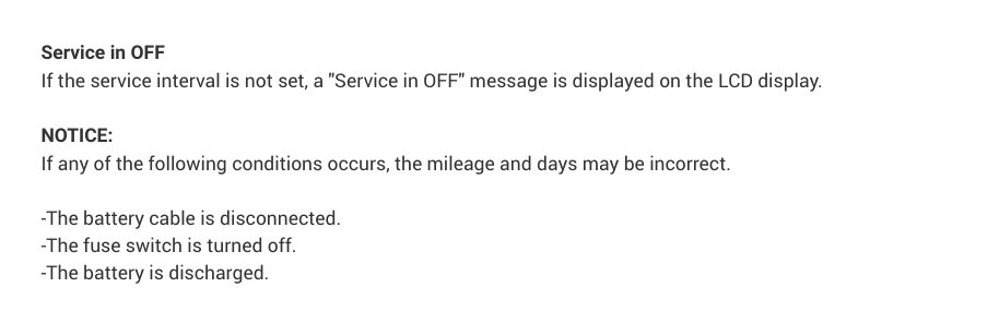

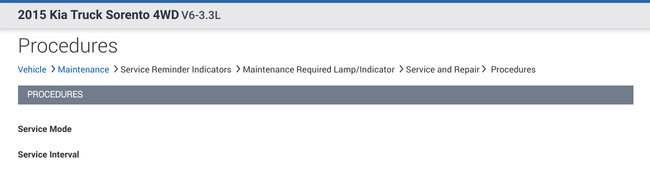

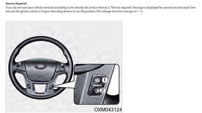

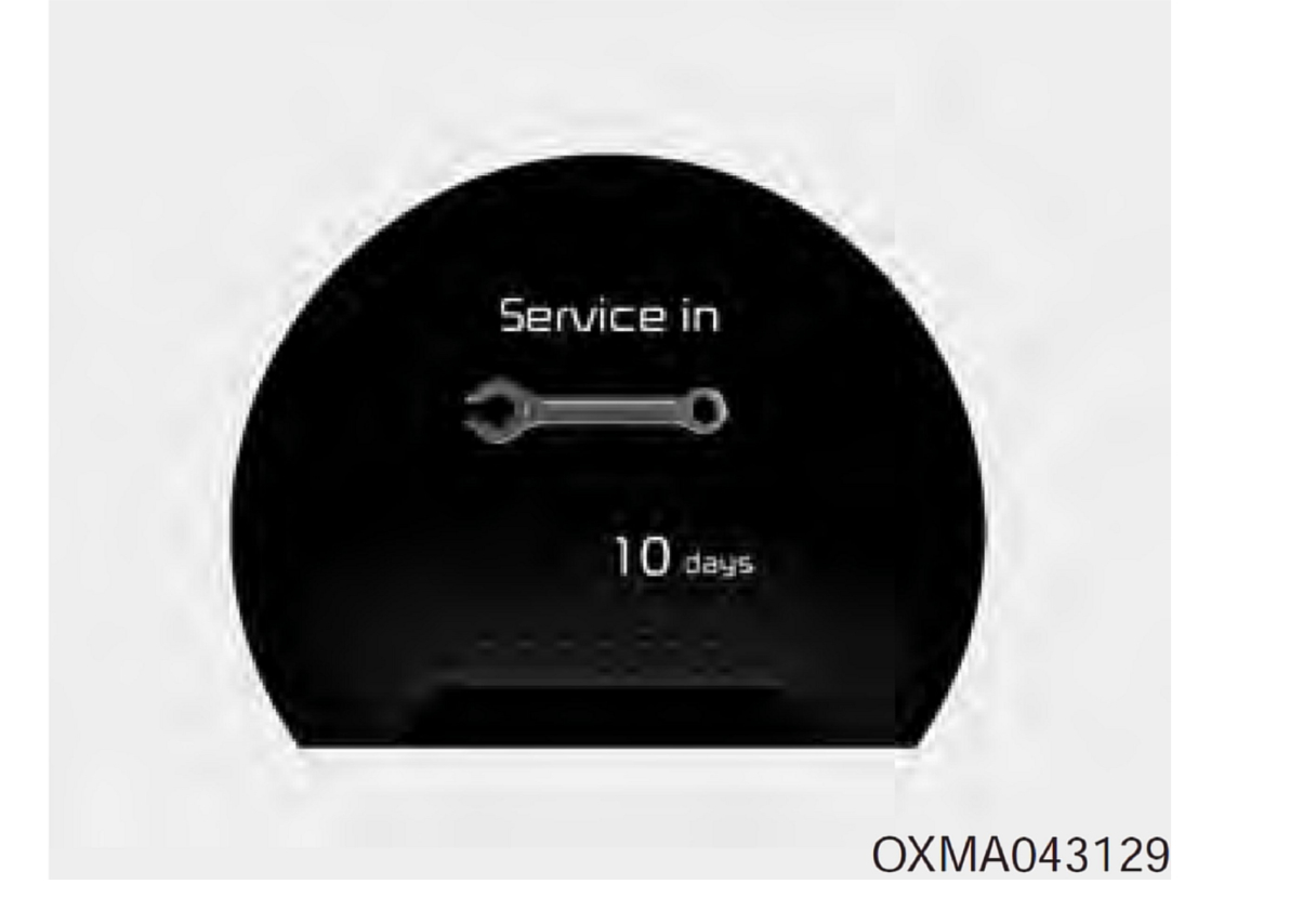

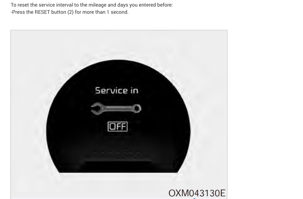

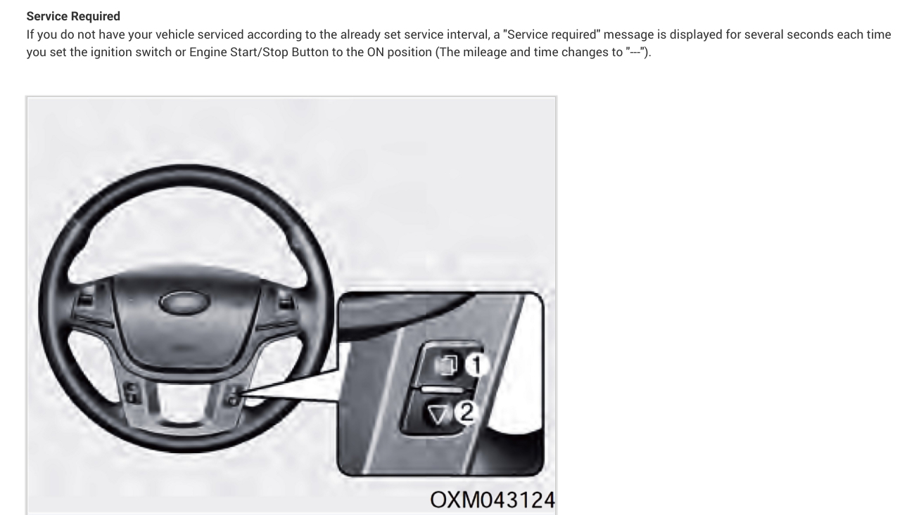

In the diagrams down below I have included the instructions for resetting your vehicle's Service Reminder. Please go through this guide and get back to us with how everything turns out.

I've reset that the button twice and it's still saying I need service. I did my service on December 7th and I don't need another service until I'm at 50,000 miles. I'm currently at 48,800.

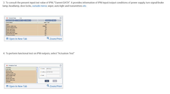

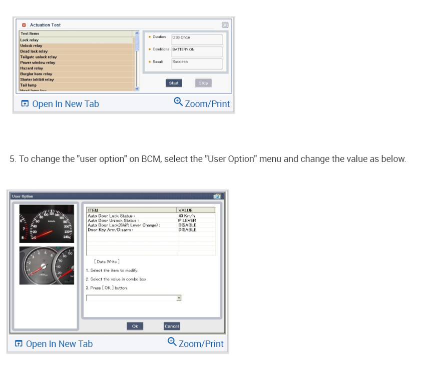

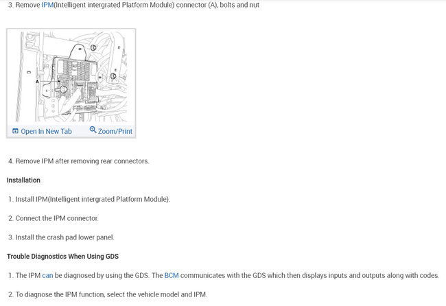

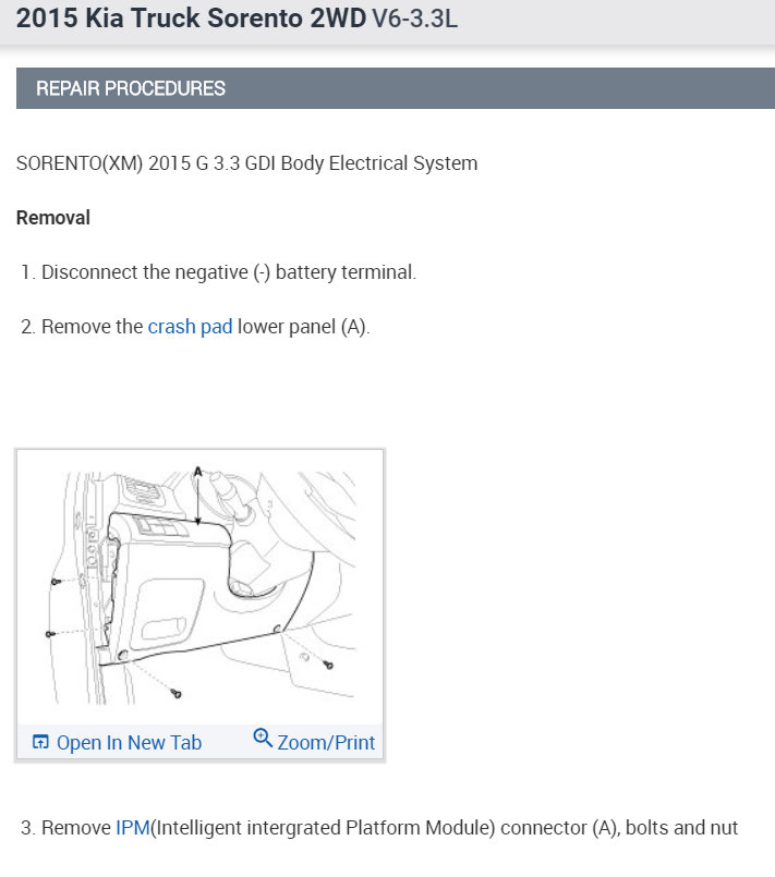

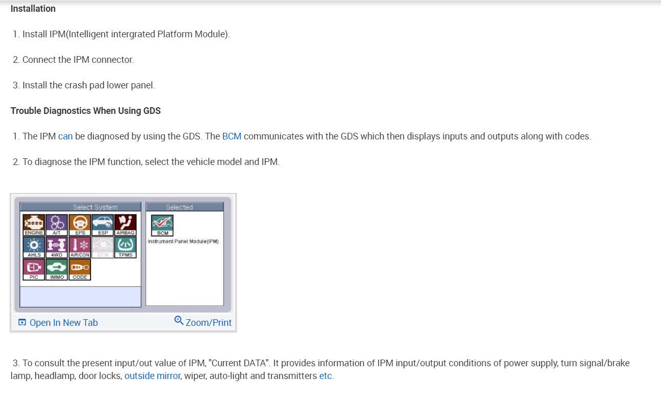

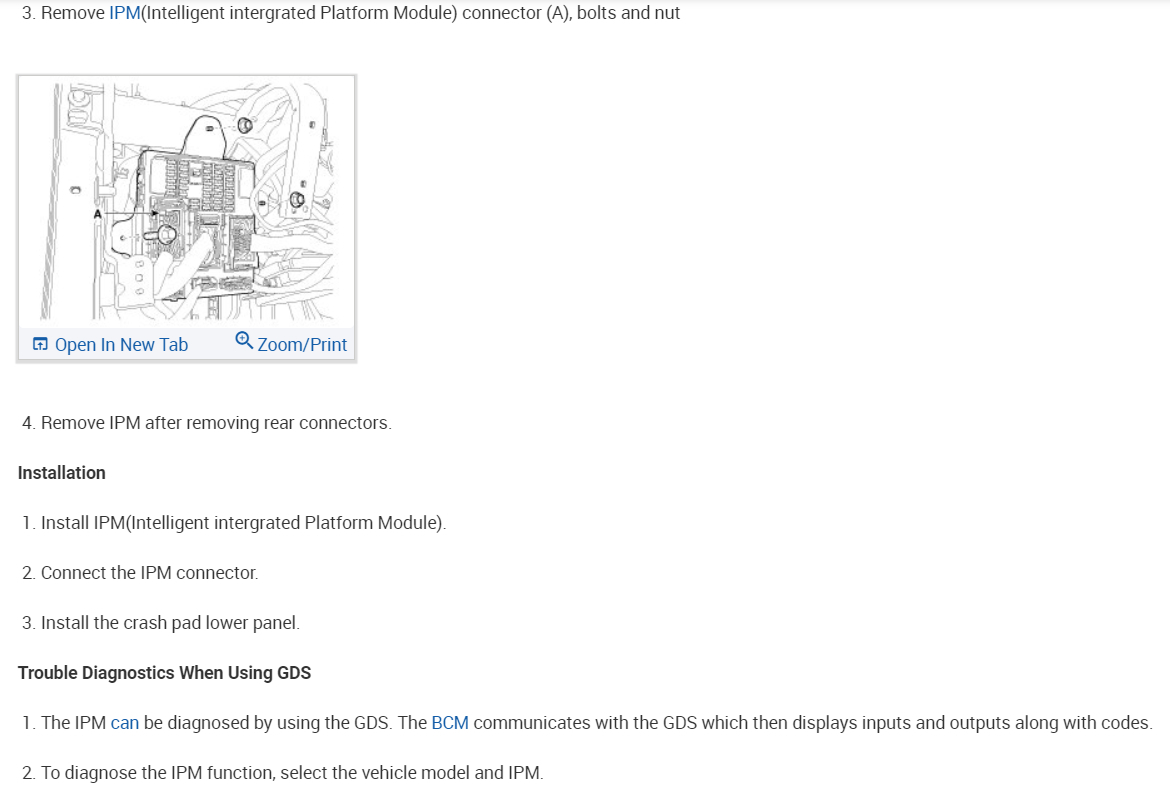

It sounds like the ISP controller (smart junction box) is out but to be sure lets do a CAN scan which is the future of car repair and only cost about $50.00 on Amazon no subscription either. :) Watch this video:
https://youtu.be/InIlnsjOVFA
Please run down this guide and report back. I have also giving you instructions in the diagrams below to help you replace it.
