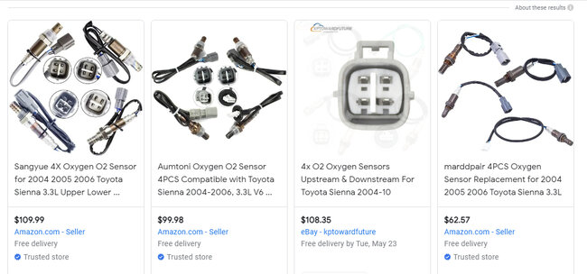

My Check Engine Light finally came back on (coincidentally immediately after having a new battery installed) and I had it check for free at AutoZone (thanks so much for that tip!!) The code sounds like it is the same one from June 2020. The code number is P2238. The cost to replace an O2 sensor is $800 and if the PCM needed to be reprogrammed it would be another $300. Getting more estimates, then deciding if it's worth it for a 2004 car. Any advice?

  • 110,244 POSTS
Is the vehicle still running okay? As far the price, that is crazy high. I attached a pic below showing all four sensors for under 100.00 dollars. So, that means they are charging 700 dollars to install them, which again, is crazy. I don't know what the hourly rate is, but they should be able to replace all four in around 3 hours. That would work out to over 230 dollars an hour. Ugh!!! That's a lot.
Regardless, let me know if there is anything I can do to help or if you have questions.
See pic below.

So, I went ahead and had the one bad air fuel ratio sensor replaced by a shop that I have used before. Their total was $464. so, much less than the other quotes I had gotten. The interesting thing was once I saw the receipt it only showed $100 for labor and $320 for parts and that was only for one sensor. But at least I don't have to see the Check Engine Light any more... until the next thing happens. :)
