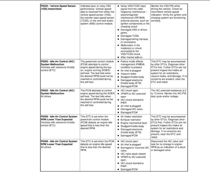

Okay, possible causes below:
All these need to be checked to find the failure.
The P1000 will go away after the 506 is set and drive cycle is performed.
P0506
Item Description
Symptom/DTC P0506
Descriptor
Idle Air Control System Rpm Lower Than Expected
Probable Causes
Air Inlet is Plugged (For All Others)
Air Intake Restriction (For Electronic Throttle Control Vehicles)
Electronic Throttle Body (ETB) Damaged (For Electronic Throttle Control Vehicles)
Engine Mechanical Fault (For Electronic Throttle Control Vehicles)
Exhaust Restriction (For Electronic Throttle Control Vehicles)
Idle Air Control (IAC) Circuit Open (For All Others)
Idle Air Control (IAC) Circuit Shorted to Power (For All Others)
Idle Air Control (IAC) Valve Damaged or Incorrect (For All Others)
Idle Air Control (IAC) Valve Stuck Closed (For All Others)
Ignition Switched Power (VPWR) to Idle Air Control (IAC) Solenoid Open (For All Others)
Powertrain Control Module (PCM) Damaged (For All Others)
Powertrain Control Module (PCM) Damaged (For Electronic Throttle Control Vehicles)
Throttle Body Sludged (For Electronic Throttle Control Vehicles)
Jun 12, 2018 at 9:59 AM (Merged)
