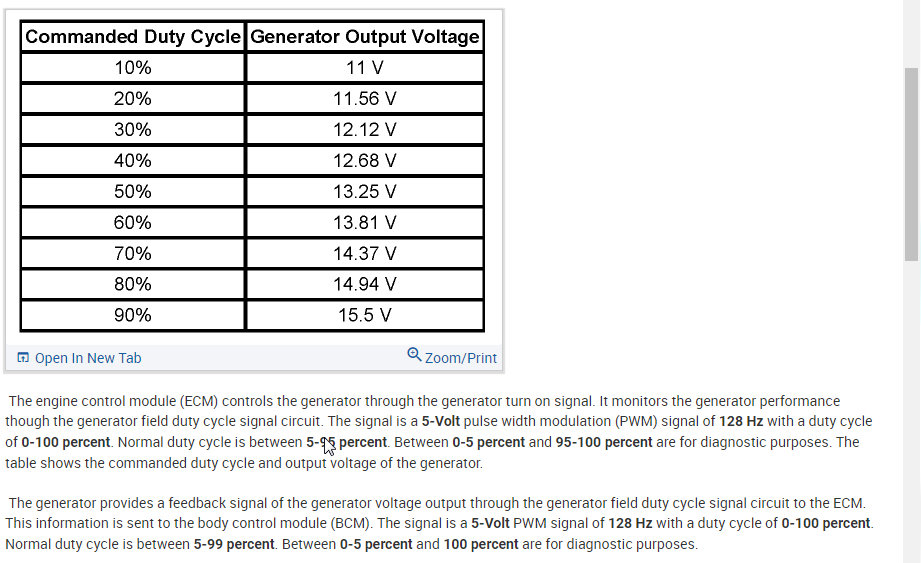

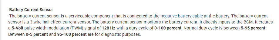

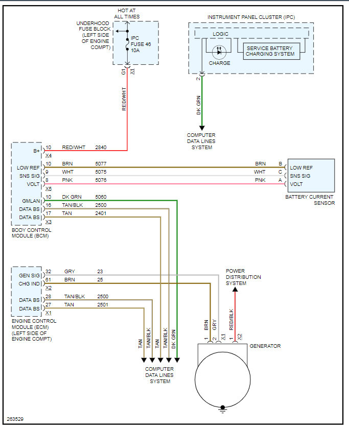

I suspect the battery current sensor is reading improperly which is forcing the charging system to run at a higher voltage and most likely it is damaging the field control in the alternator.
We are going to need to test this on a functioning alternator so unfortunately we are going to have to replace it again. Then we need to monitor the voltage across the battery at idle and see what the voltage is. Then raise the RPM's to 2,500 and see what the voltage is.
If you have a scan tool that would be great to monitor the overall state of charge of the system. Then monitor the duty cycle of the alternator and let me know if that matches the voltage. See the chart attached.
Let's start with this and go from there.

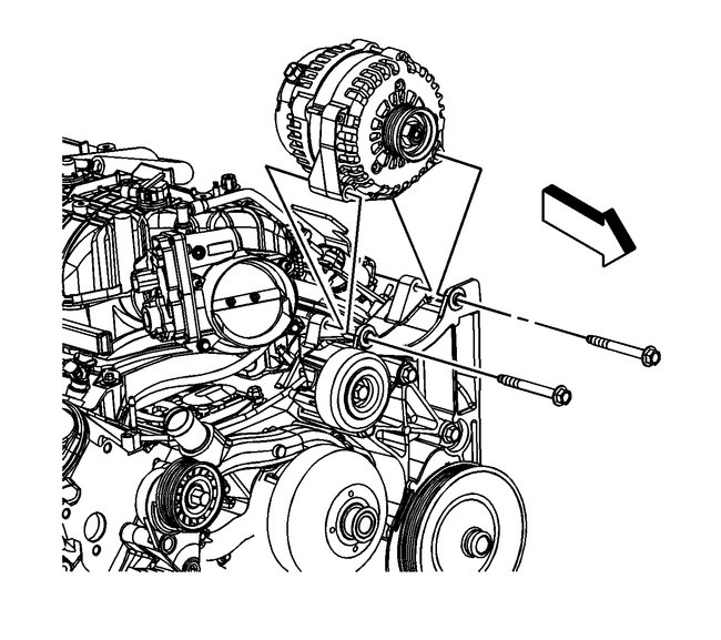

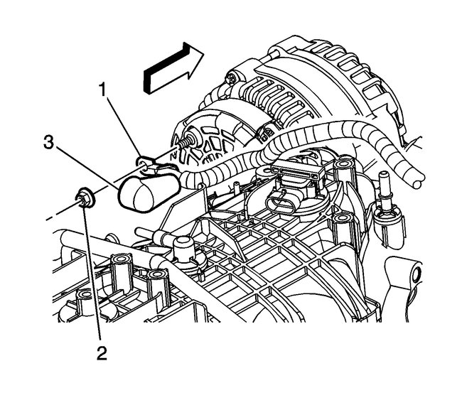

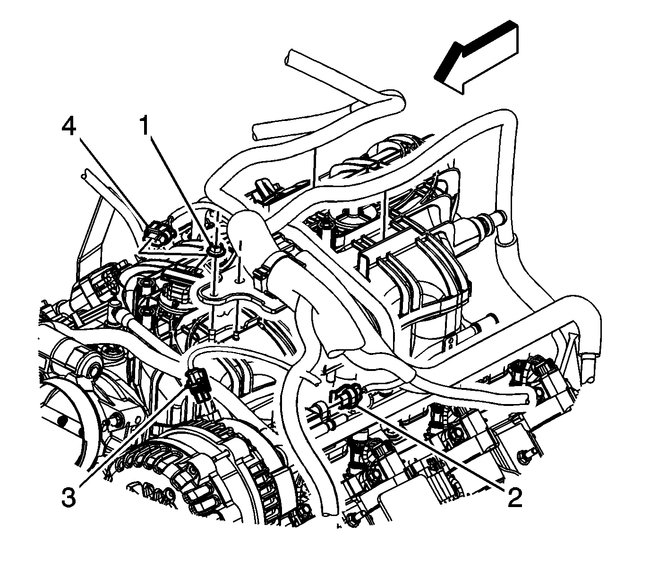

Since you had the alt installed by a mechanic, I will provide the directions so you can do it at home. The attached pics correlate with the directions.
______________________________
2007 Chevy Truck Tahoe 2WD V8-5.3L
Generator Replacement
Vehicle Starting and Charging Charging System Alternator Service and Repair Removal and Replacement Generator Replacement
GENERATOR REPLACEMENT
REMOVAL PROCEDURE
pic 1
1. Disconnect the negative battery cable.
2. Remove the intake manifold sight shield.
3. Remove the accessory drive belt.
4. Disconnect the engine harness electrical connector (3) from the generator.
pic 2
5. Reposition the generator battery jumper cable boot (3).
6. Remove the generator battery jumper cable nut (2) from the generator.
7. Remove the generator battery jumper cable terminal (1) from the generator stud.
pic 3
8. Remove the generator bolts.
9. Remove the generator.

pic 5
3. Install the generator battery jumper cable terminal (1) to the generator stud.
4. Install the generator battery jumper cable nut (2) to the generator.
Tighten the nut to 9 N.m (80 lb in).
5. Position the generator battery jumper cable boot (3).
pic 6
6. Connect the engine harness electrical connector (3) to the generator.
7. Install the accessory drive belt.
8. Install the intake manifold sight shield.
9. Connect the negative battery cable.
