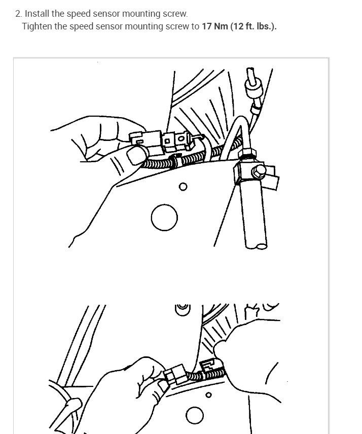

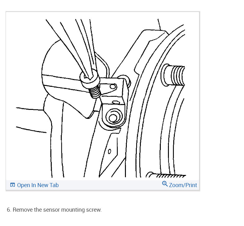

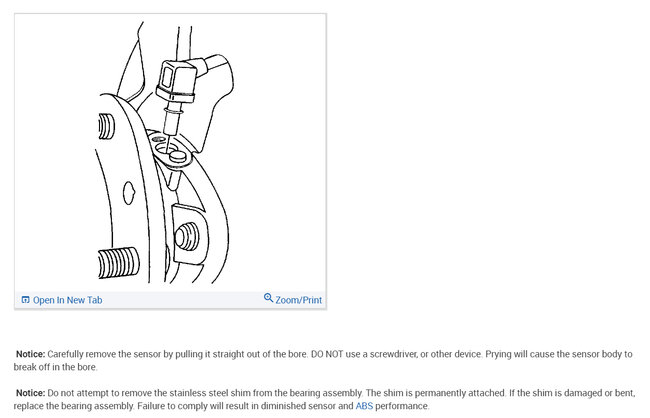

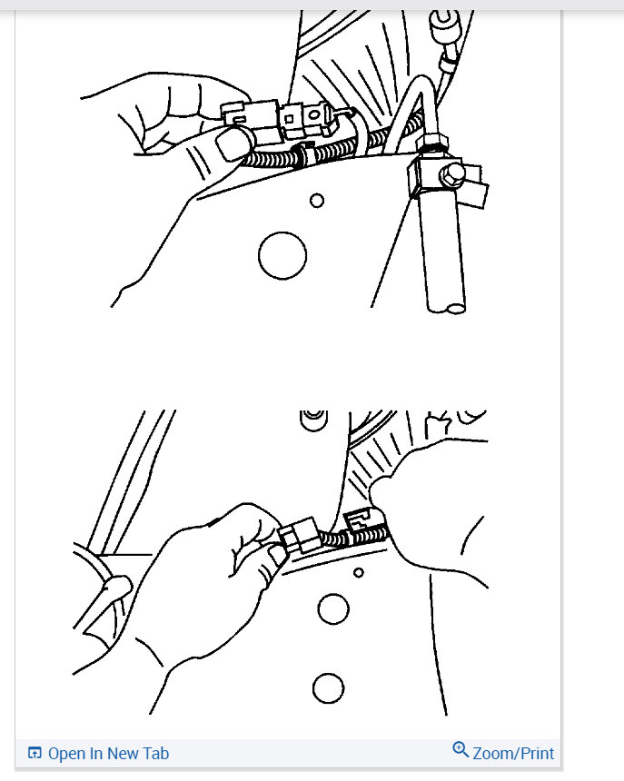

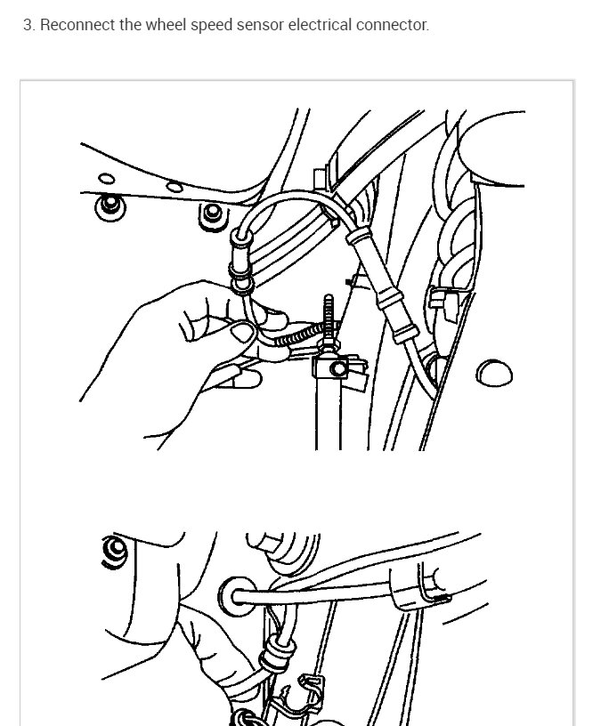

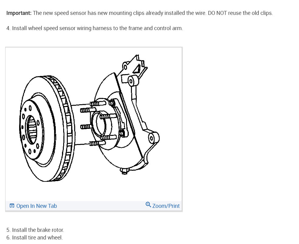

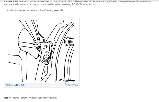

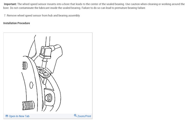

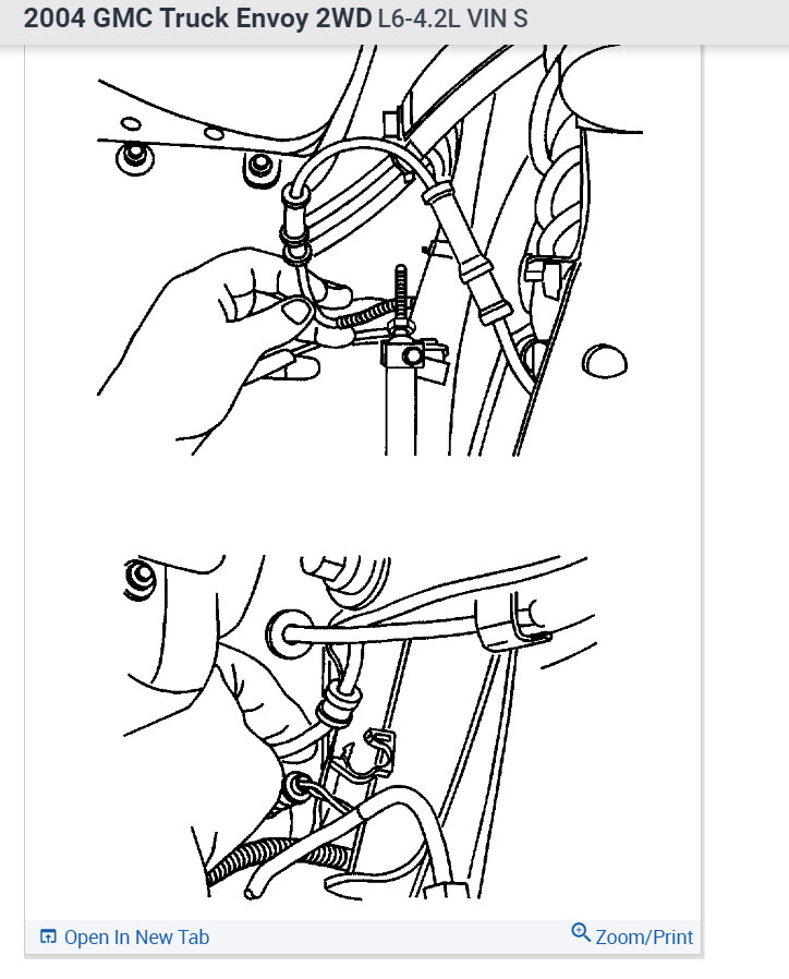

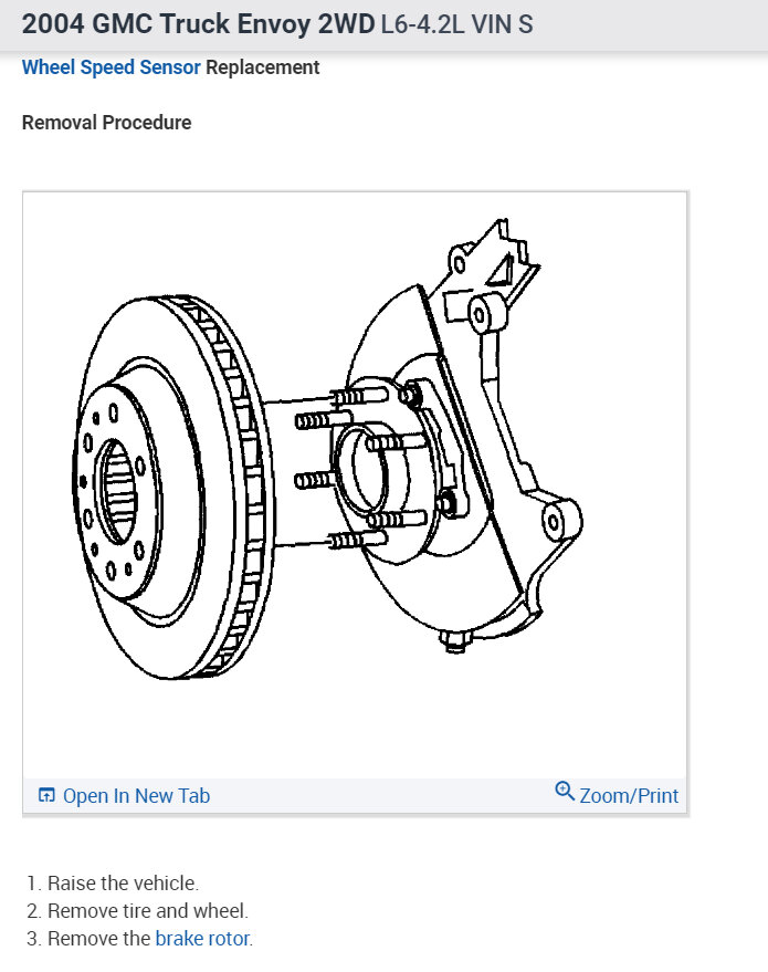

No problem, this sounds like a front or rear ABS wheel speed sensor is not working. here is a guide to help you retrieve the codes so we can see which sensor is it. The scanners are cheap on amazon.
https://www.2carpros.com/articles/anti-lock-system-testing-and-repair-abs
This guide can help as well:
https://www.2carpros.com/articles/brake-system-warning-light-on
Here is how to change the sensors in case you need them. Check out the images (below). Let us know what happens and please upload pictures or videos of the problem.
