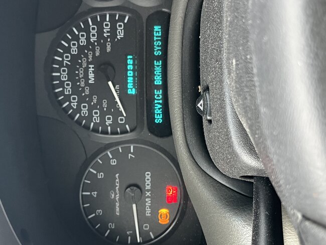

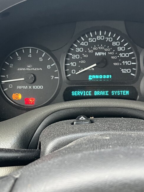

I am getting an intermittent “Servive Brake System” error
Sometime s this error comes on right when I start up the car, sometimes it comes on after driving and sometimes it doesn’t come on at all.
I notice when it’s on, I don’t have ABS or All-wheel drive, but brake work just fine.
When it’s off, my ABS works like normal.
The emergency brake cable is not hooked up.
I’ve replaced the all-wheel drive module several times. Sometimes it works, some times it doesn’t.
When I get new tires or have the tires rotated, I just go to the cheap local place.
It’s their a sensor that’s not hooked up? Could it be a fuse? Anything else I should check?
Thanks.

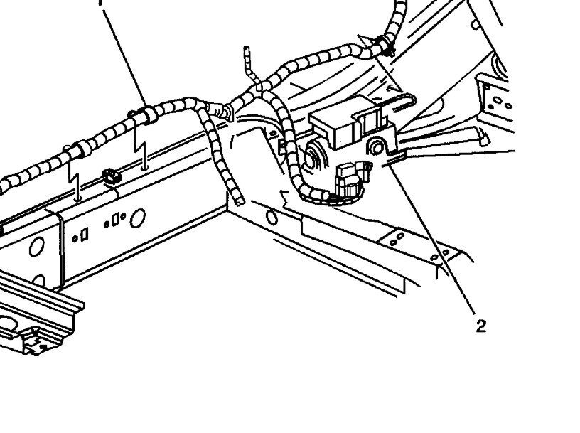

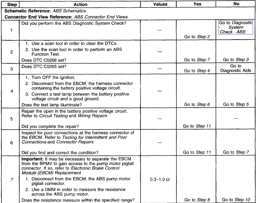

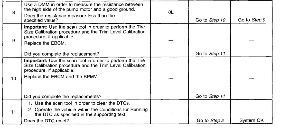

Ok, I finally got a scan tool hooked up. Took me over a week to get the error again.

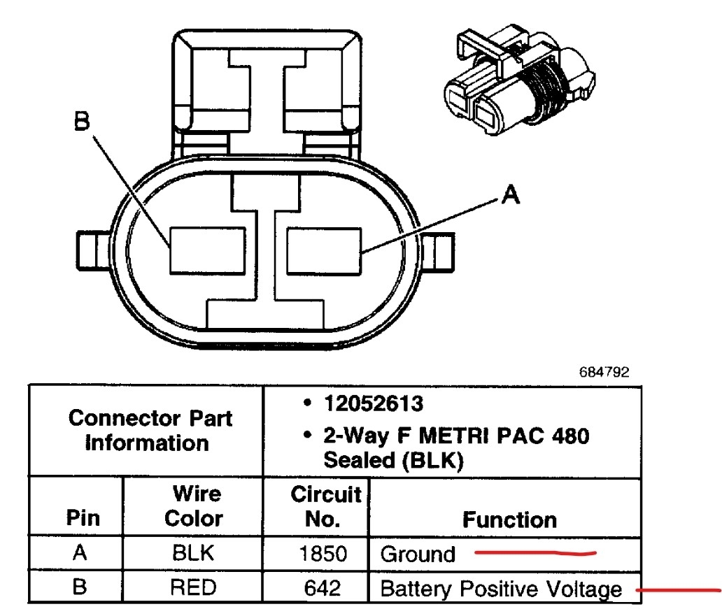

C0265
Repair ground for electronic brake control module (EBCM)
Jan 5, 2026 at 11:03 AM
STEVE W.
  • 15,409 POSTS
That code is commonly caused by corrosion in the electrical connector on the EBCM, or if the ground to the EBCM motor is faulty. I would pull the connections off, look them over for corrosion, clean and reassemble. I have seen it be an issue in the harness and people run a different ground to the EBCM as a repair, however the location of the unit under the truck can make that a bad repair as it starts corroding quick.
