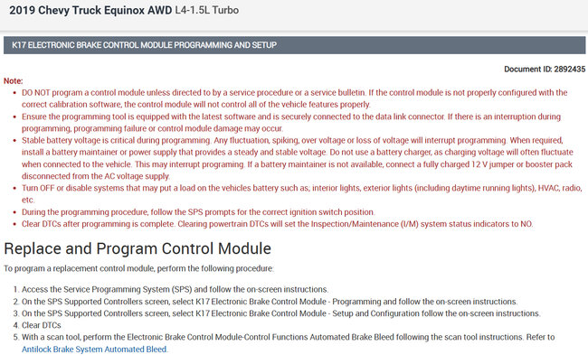

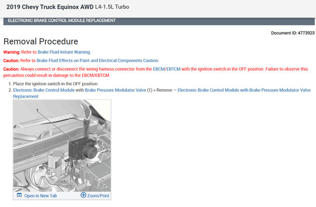

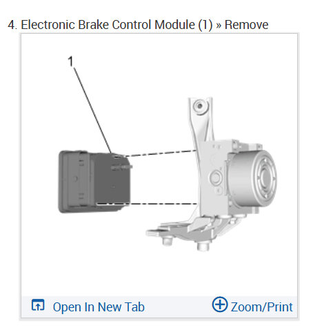

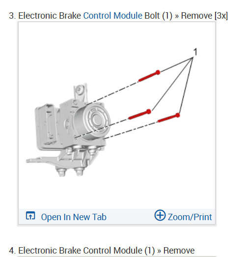

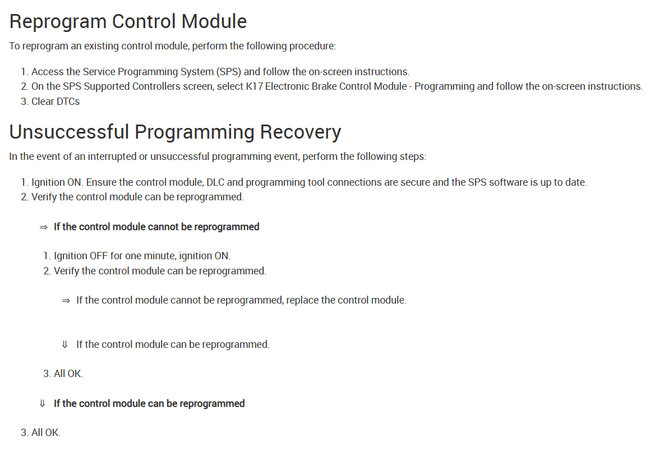

Here is the instructions on how to replace the ABS controller. Check out the images (below). Let us know what you find.
