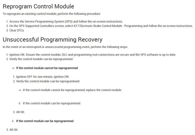

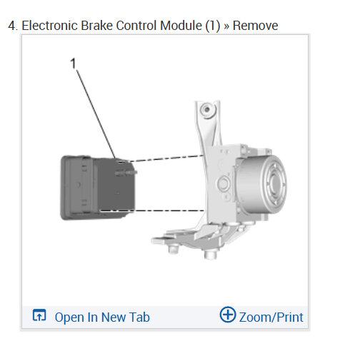

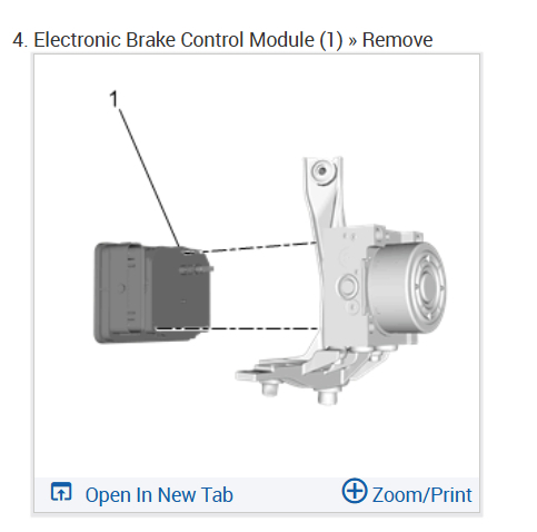

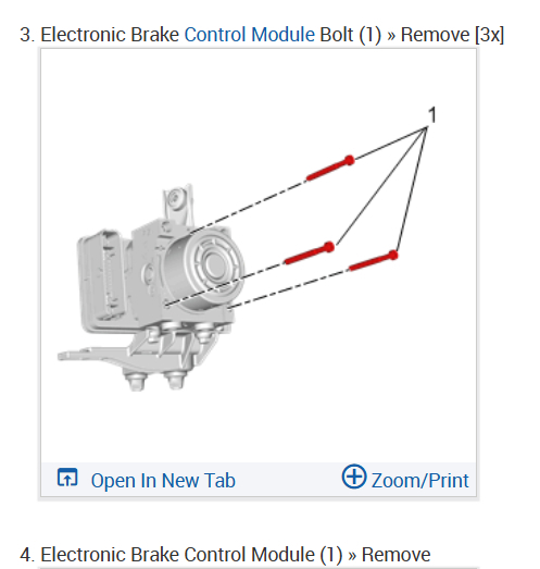

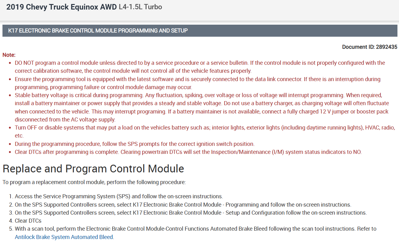

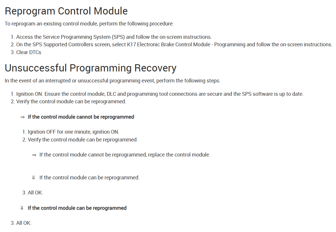

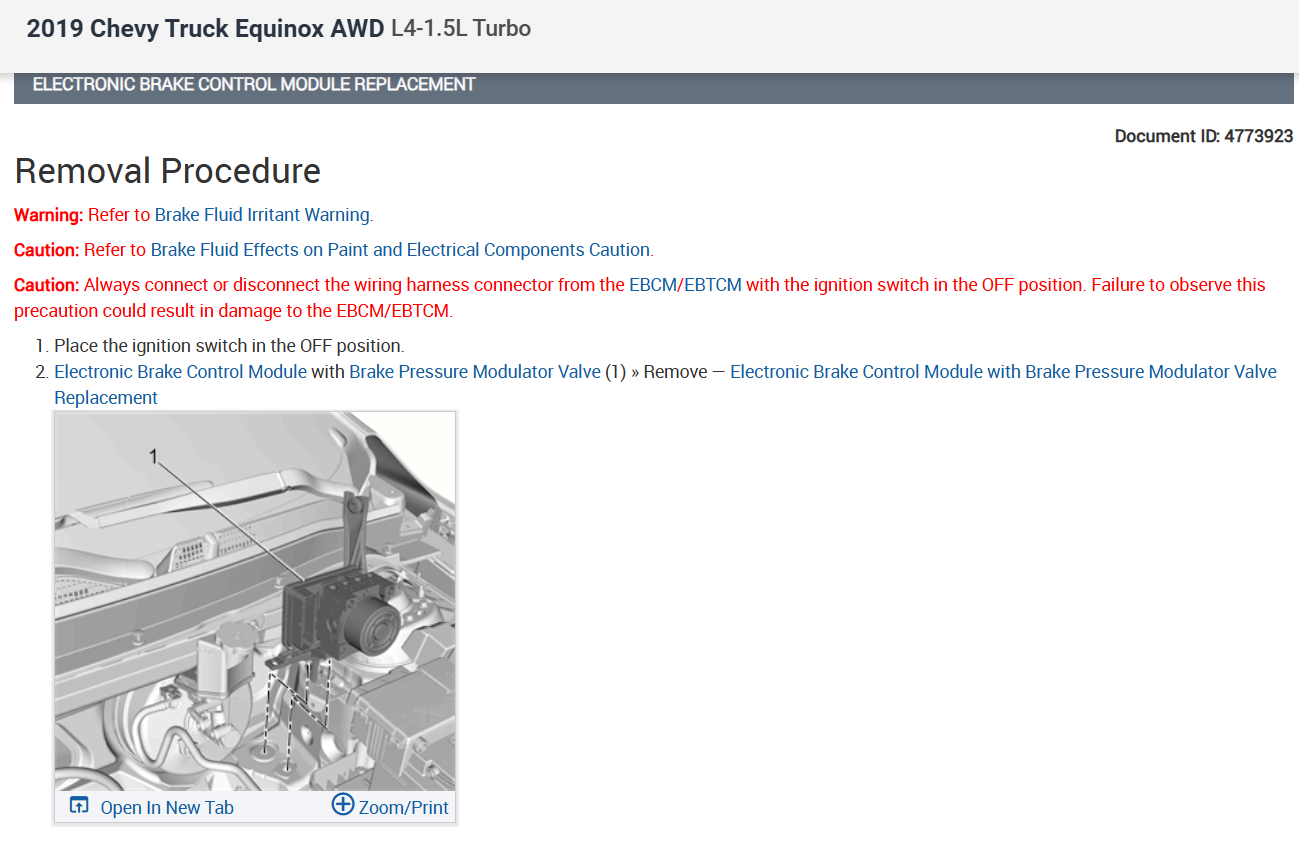

I have seen bad ABS control module cause these codes,
C0800: Control Module Power Circuit
U0121: Lost Communication with Anti-Lock Braking System (ABS) Module
Here is the instructions on how to replace the ABS controller. Check out the images (below). Let us know what you find.
