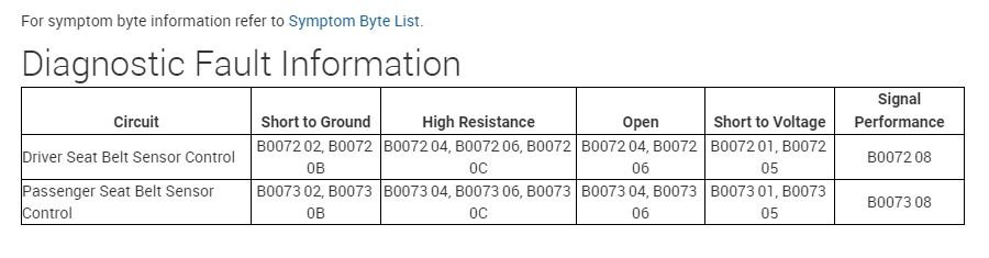

Code B0074-03 passenger seat belt tension seat circuit- low voltage
2016 CHEVROLET COLORADO
45,000 MILES • 2.5L • 4 CYL • 2WD • AUTOMATIC
CHAD74

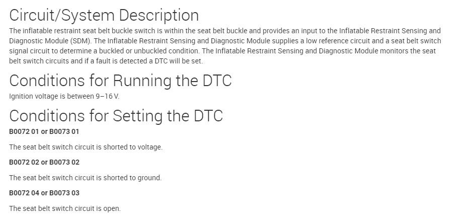

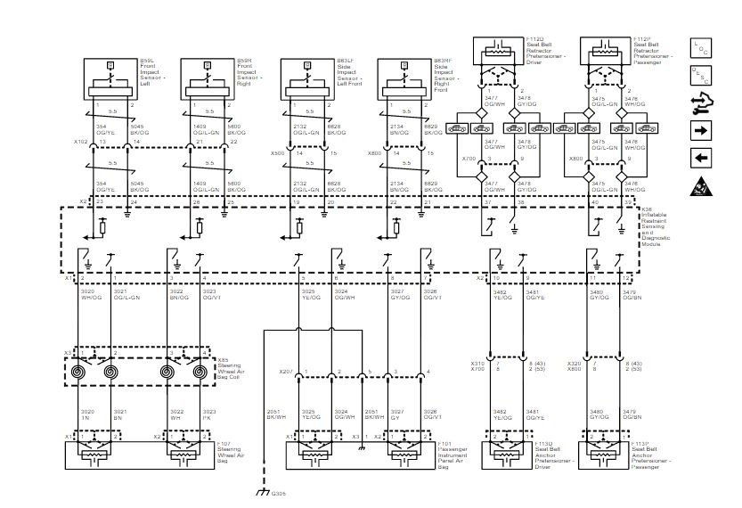

I have read the code and it is B0074-03 which is passenger seat belt tension seat circuit- low voltage. Is this the seat belt mechanism in the door? This is an extended cab so the seat belt is located in the extended cab door. I checked the wiring in the rubber boot for the door but nothing obvious was found. All help will be appreciated. Thanks!
Oct 30, 2019 at 10:49 PM
Good morning,
The code is for the passenger seat belt tensioner. That is part of the seat belt itself.
You need a scan tool that can read live data to monitor the voltage at the switch.
