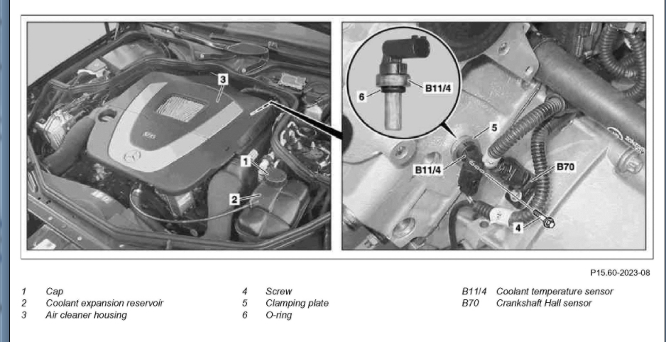

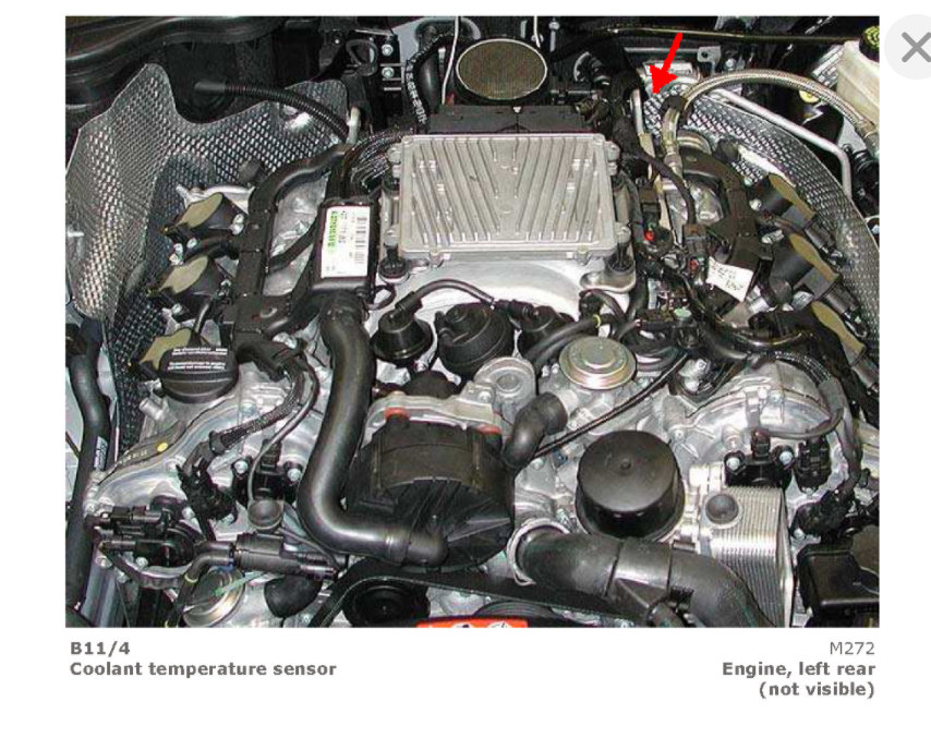

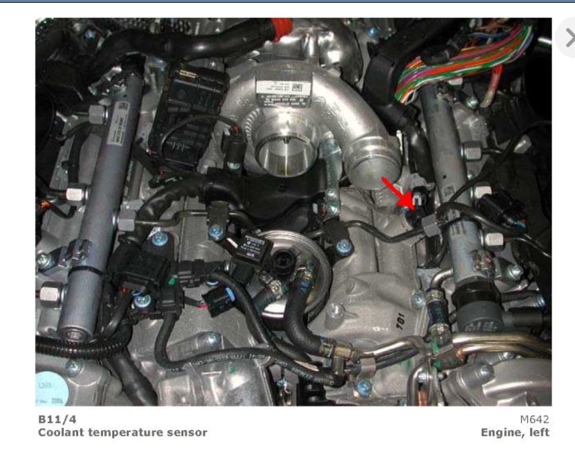

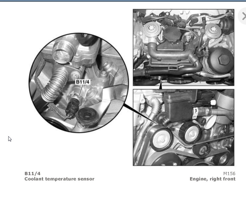

Where is the coolant temperature sensor on the car listed above 4matic located?
Feb 22, 2021 at 1:00 PM
Experienced Mechanic
18,907 POSTS

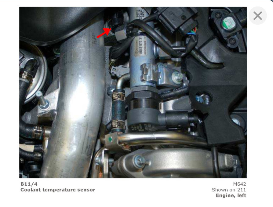

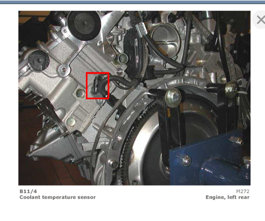

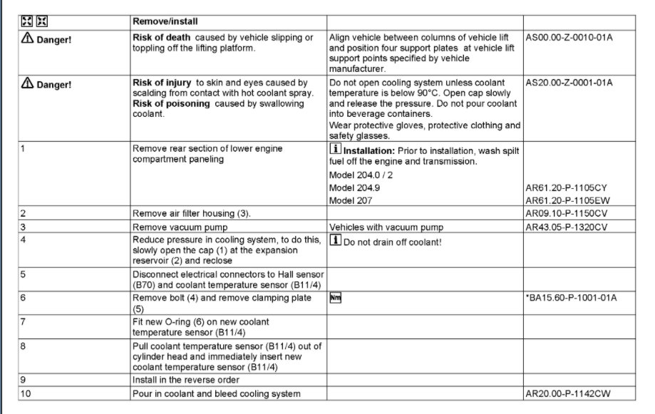

I am attaching all the info from the manual on this for each of the different engines in case others needs a location for a different engine.
Plus the process from the manual on this engine. Let us know if you have other questions. Thanks
