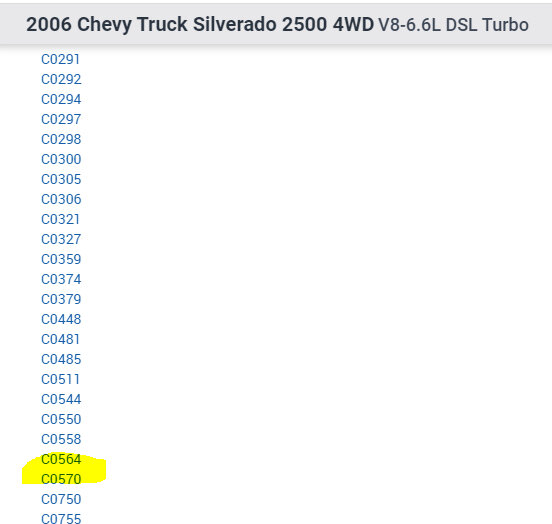

I need a little more info. First, I'm assuming this is at least a 2500. Is that correct? Which transfer case do you have? Is it the NVG 246-NP8 or the NVG 263-NP1?
Let me know. The wiring schematics are different, so I want to make sure I'm looking at the correct one. I do have another question. If this is a 2500, I am not showing a C0569 code for this vehicle. (See pic below) I'm thinking you may have a 3500 or something different.
See pic below.

It is a 2500 it’s a LMM engine. I’m not sure which transfer case. And that is the code c0569:4b calibration not learned. I looked at your pic and your under the year 2006 maybe that’s why.
