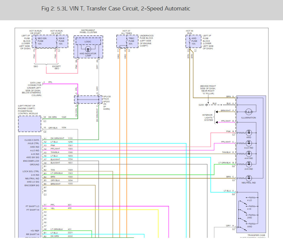

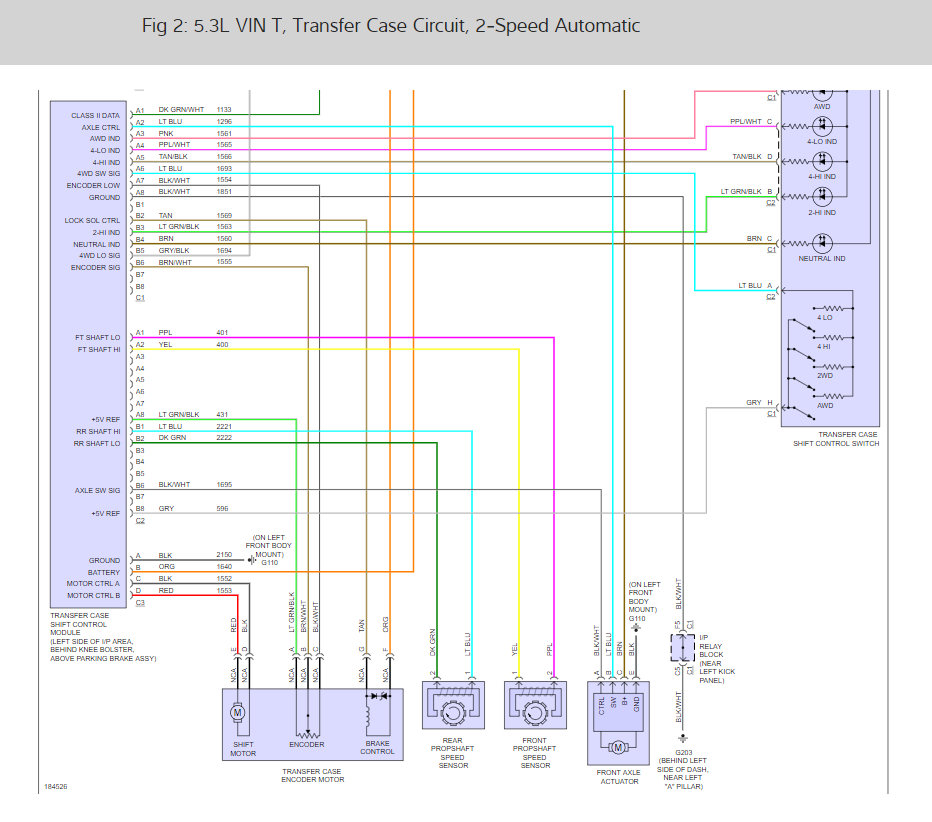

Service four wheel come on and stays on. Four wheel will not work. I have replaced control switch and front axle shift actuator. Code c0379 comes up. help please!
Apr 10, 2019 at 9:36 AM
  • 55,399 POSTS
There is a ground wire that goes bad on these. to be sure here is a guide and the wiring diagrams so you can test the connections:
