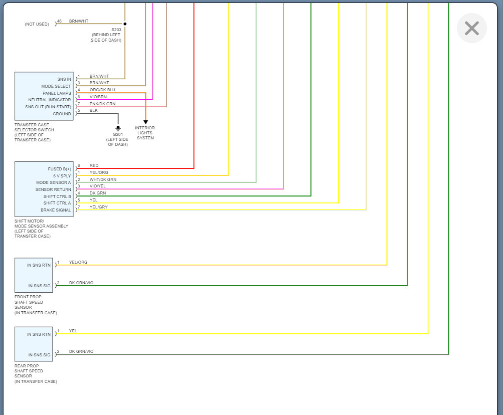

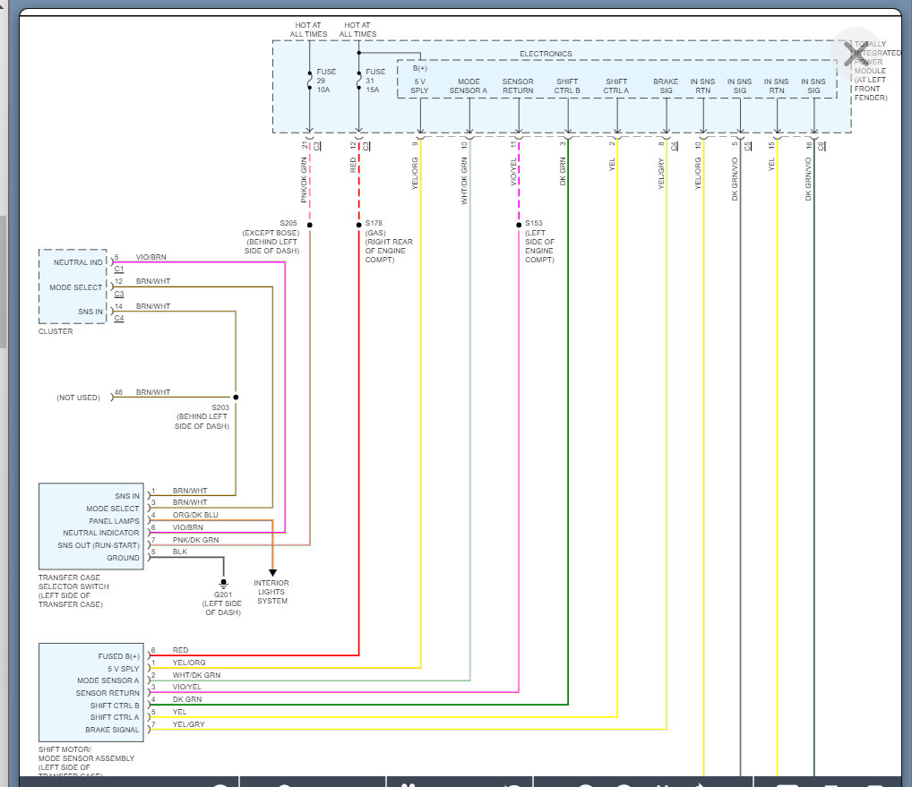

You are correct that there will be some codes but not in the cluster retrieval of codes. This is going to be a power train code, so we are going to need to use a scan tool and get them out of the PCM.
Once we know what code is there, we will have a better idea and some testing to follow but if not then we are going to have to start checking power through the system to find what the issue may be.
However, this could be a speed sensor issue so that will most likely be hard to pick up from just blindly testing the voltage.

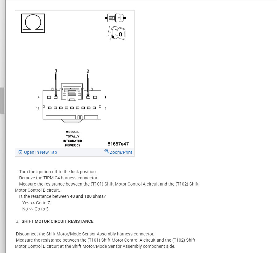

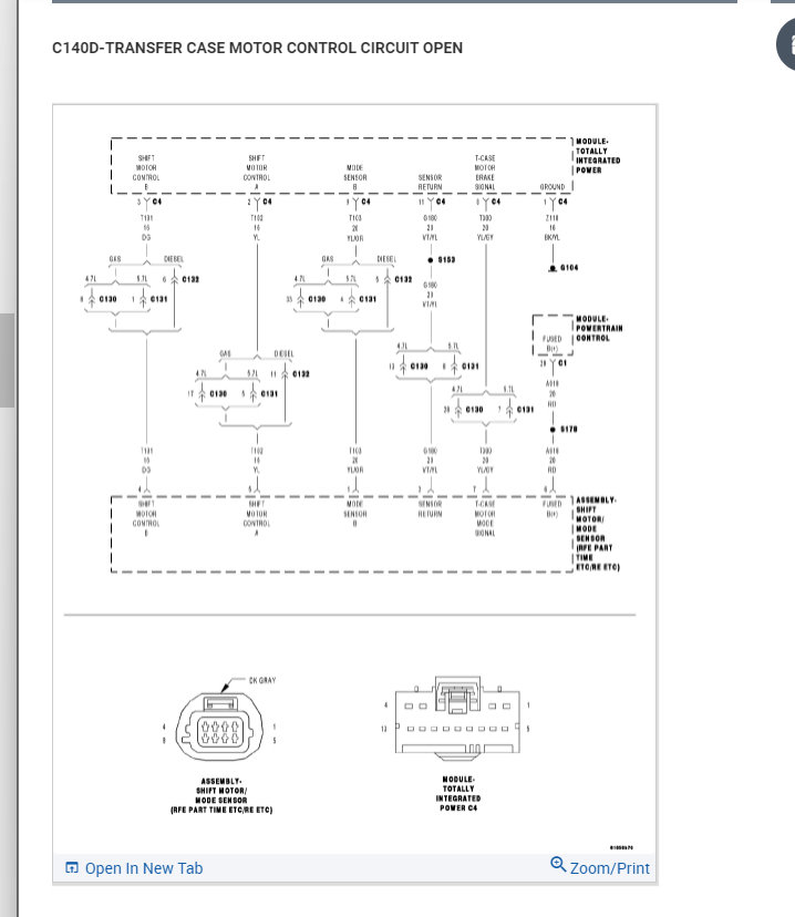

I am attaching the wiring diagram below, but we need to start with any codes and go from there. Thanks

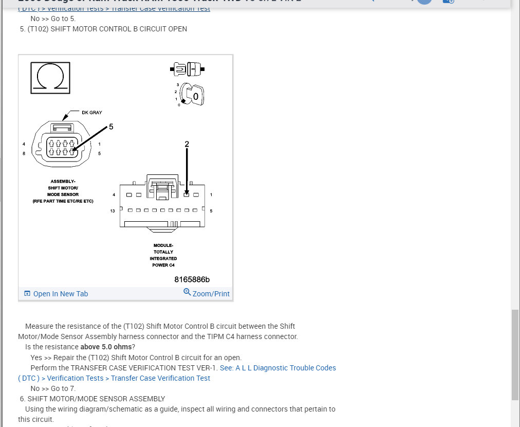

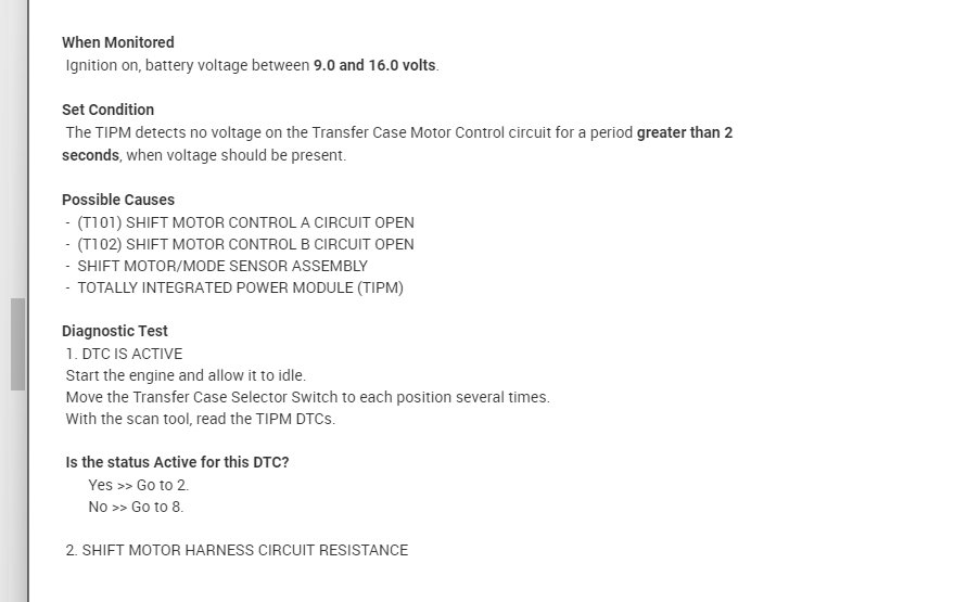

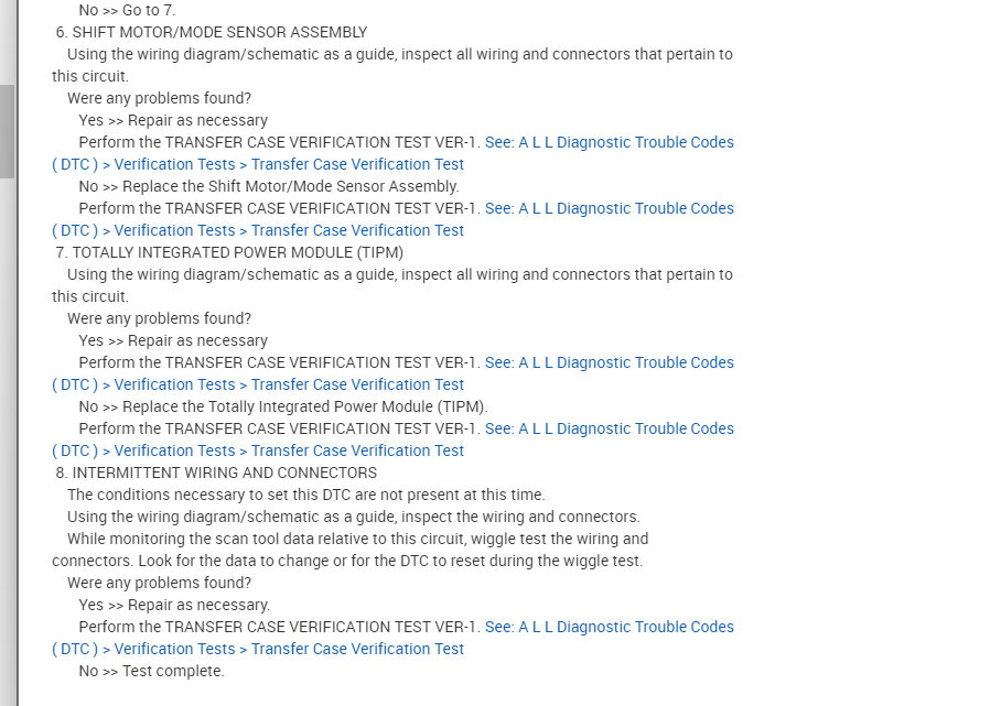

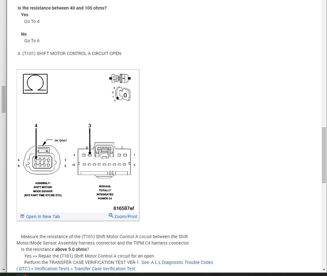

Okay. That is great info. Yes, you need to follow the C140D through and it could turn out to be a TIPM issue, but I attached the testing below in case you or others need it.
Let me know what questions you have, and we can go from there. Thanks

I ended up getting this fixed. Troubleshooting kept coming back in spec at both the harness that goes into the TIPM and into the transfer case motor itself, although the resistance did fluctuate slightly when testing at the harness from the TIPM. After spending a few hours and starting to get frustrated, I had my wife stand up front watching the voltmeter and I got underneath and started wiggling wires. As it turns out, both the connector at the transfer case motor and the gray 13 pin connector going into the TIPM both didn't seem to be making good contact. I did clean the TIPM side when I had it all apart, but I never took a close look and noticed just how wallowed out the pins in the connectors were.
I took a pick tool, opened up the connectors on the harness and bent the pins back closed. First go around didn't fix it, but then I bent them more shut than I thought they should be, put it back together and the SERV 4WD light went off and I was able to shift into 4WD afterward. I've driven it about 100 miles and haven't had any further issues.
