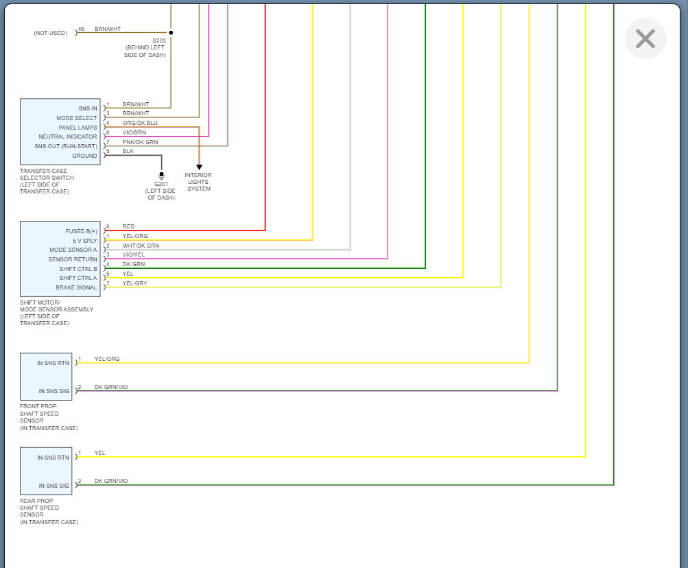

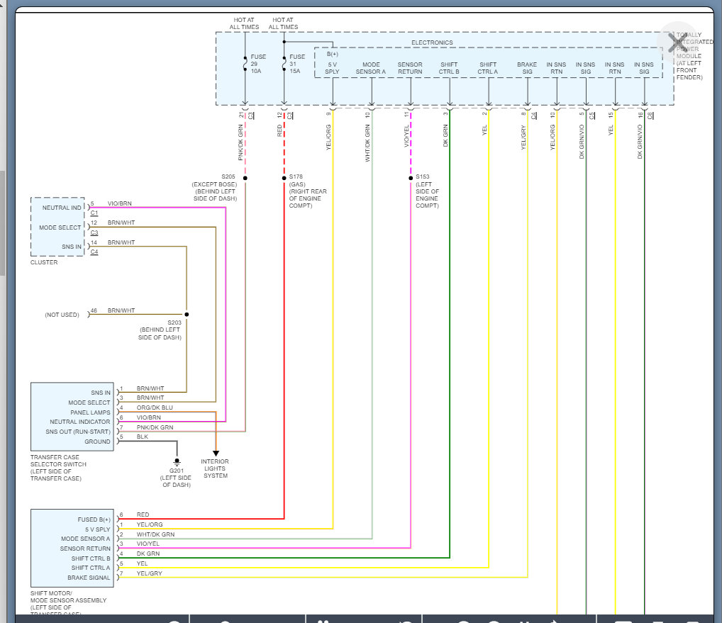

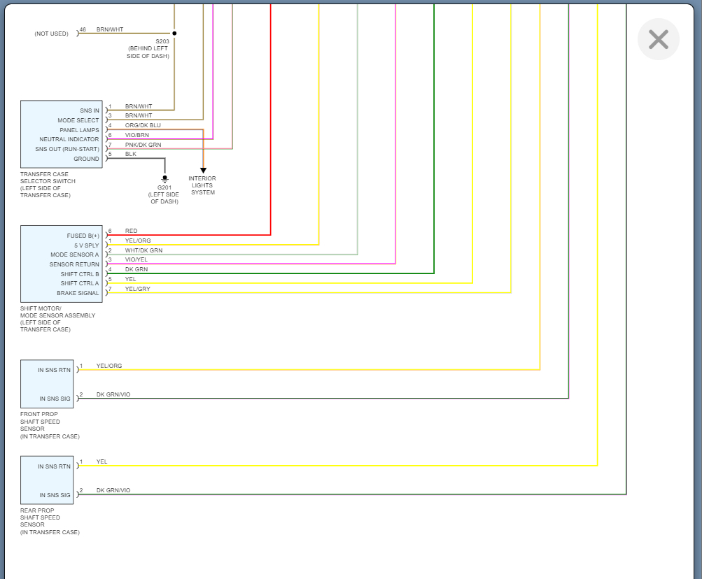

I am attaching the wiring diagram below, but we need to start with any codes and go from there. Thanks
Dec 10, 2021 at 3:07 AM

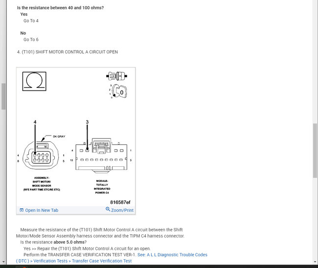

After clearing these DTCs, I cycled the key off and back on to ACC. The SERV 4WD light went off and the 4wd light started blinking on the cluster when I turned the selector, but it just kept flashing until the SERV 4WD light came back on. Codes that came back were the fog light B1661 as well as C140D Transfer Case Motor Control Circuit Open. I did not hear any sounds when I turned the knob.
For now, I am going to follow the FSM suggested troubleshooting for C140D, C1404 and C1405 to see what I end up with. Not sure if this DTC pattern stands out as anything specific to anyone here?

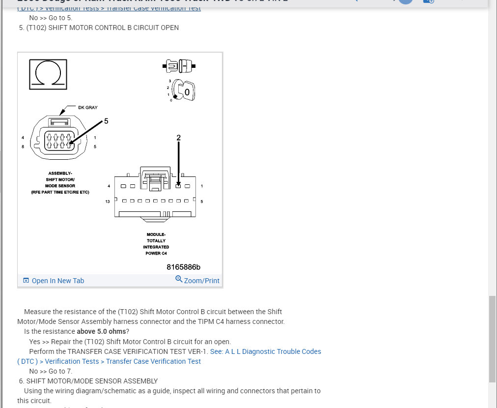

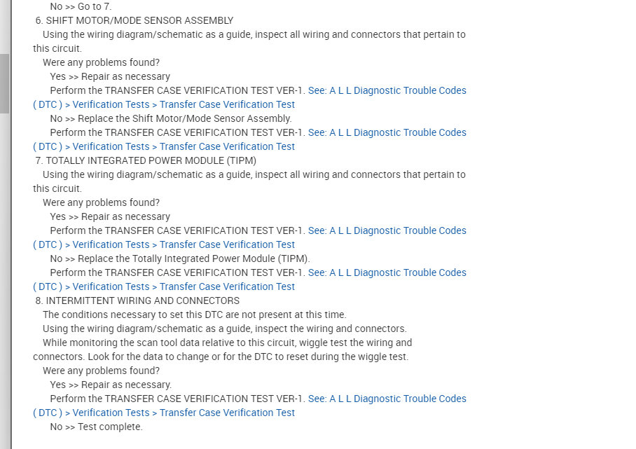

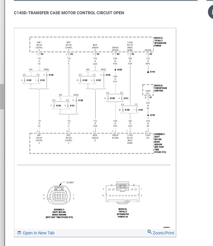

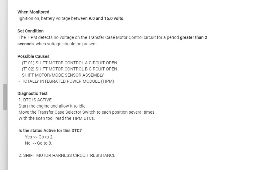

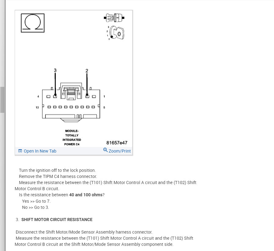

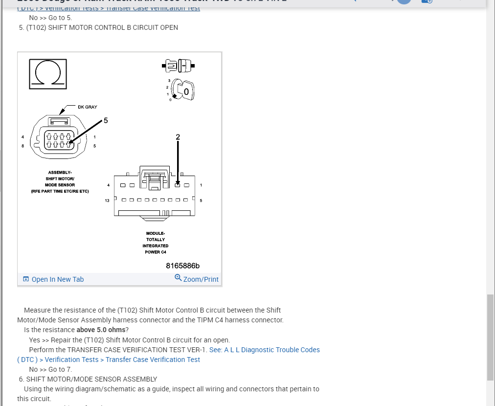

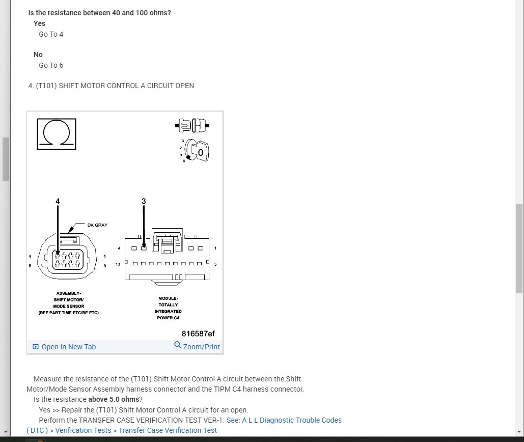

Okay. That is great info. Yes, you need to follow the C140D through and it could turn out to be a TIPM issue, but I attached the testing below in case you or others need it.
Let me know what questions you have, and we can go from there. Thanks
