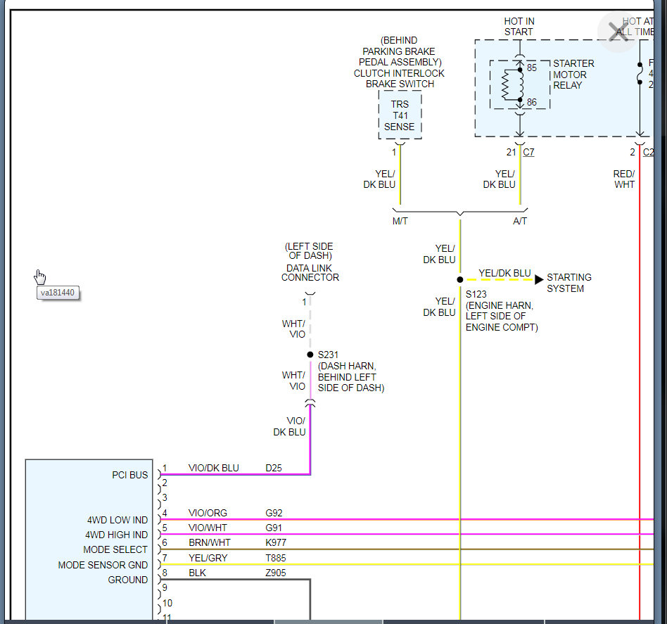

If not then we need to inspect the wiring harness under the vehicle because if it just happens when wet, then I agree it is a circuit issue. You are looking for where the harness is next to brackets or any worn spots in the covering. Worst case, pull the connectors apart and look for green or brown water marks.

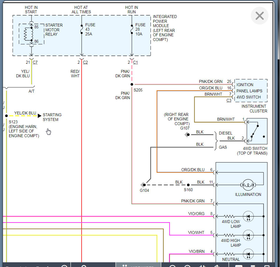

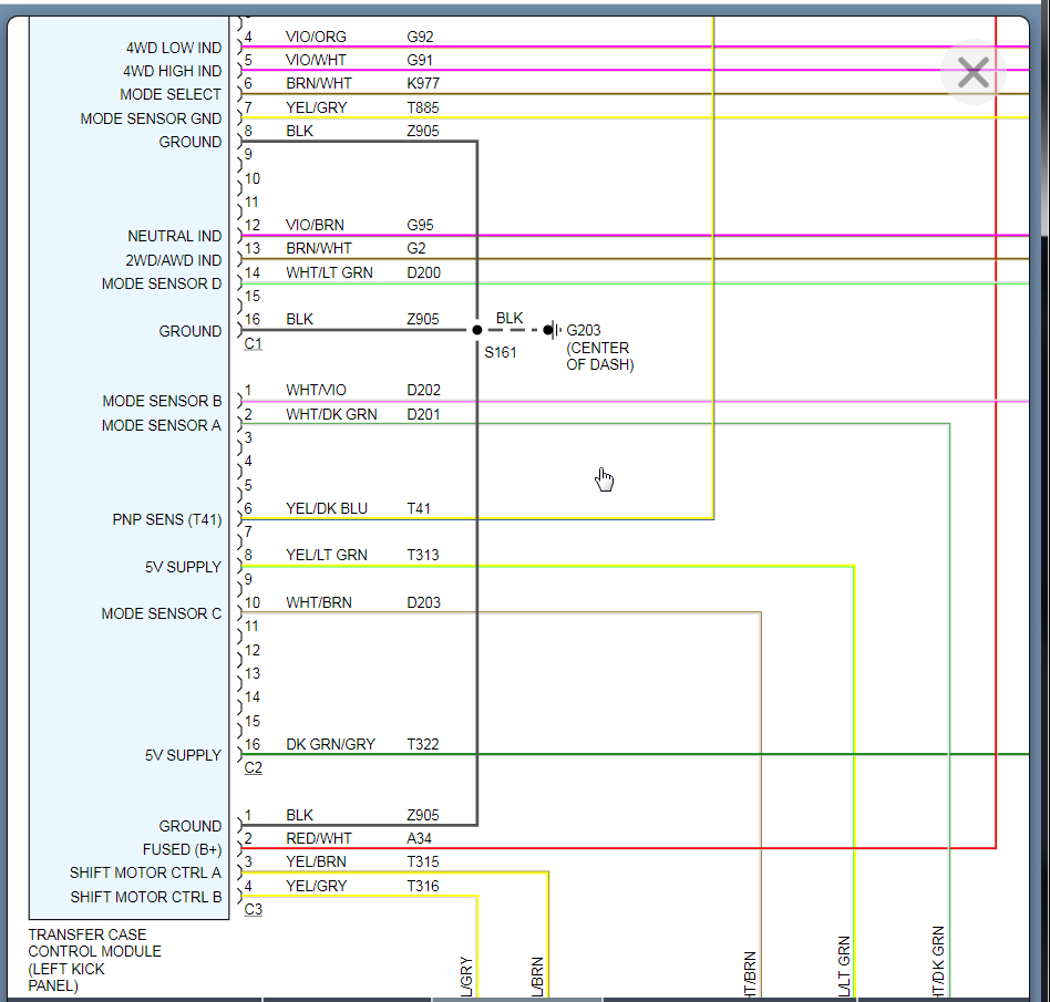

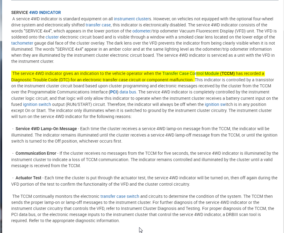

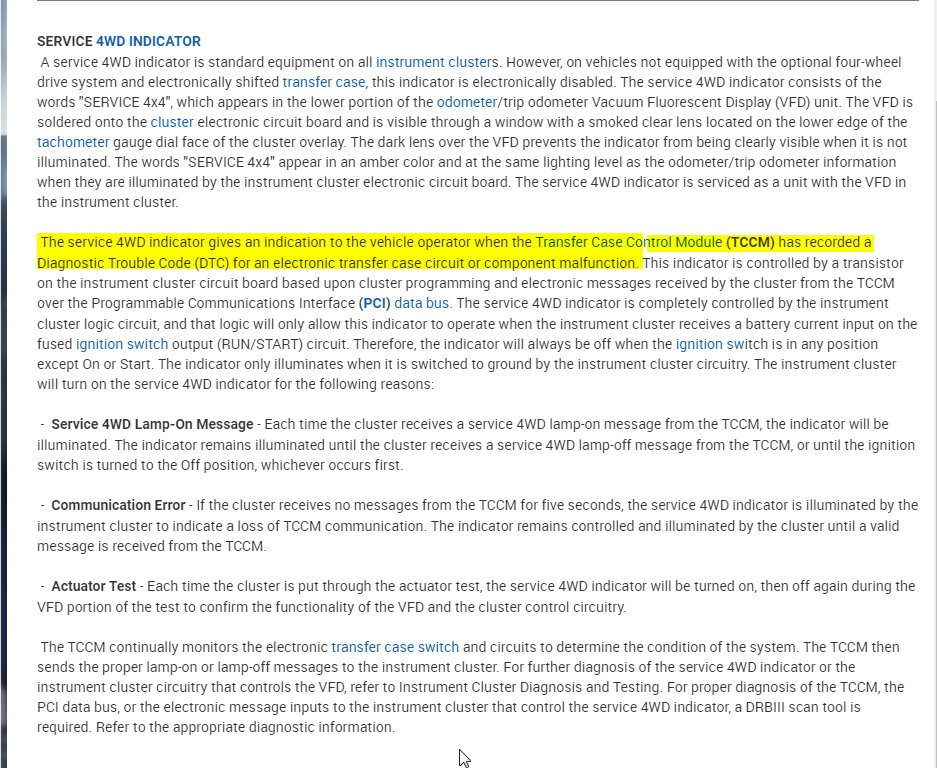

Okay. Yes. I still suspect a wiring issue but when that serv 4WD light illuminates you should have a code with it. Take a look at this attachment which explains the serv 4WD light a little more. Let me know what code it is and we can go from there. Thanks

Update: no codes
Tried first using the onboard code reading (key cycle), but as soon as engine is turned off, SERV 4WD extinguishes.
Conditions were right today. Was able to use a code reader without shutting down the engine, with no codes.
One other note. Wet conditions only accelerate the time before system fails. On a long 2WD this weekend in dry conditions and the SERV 4WD lights and no 4WD.
Time to start wire chasing.

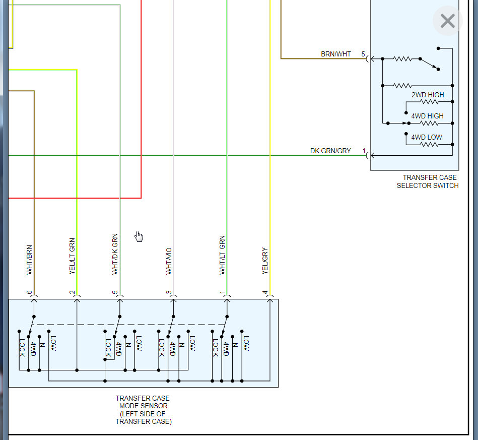

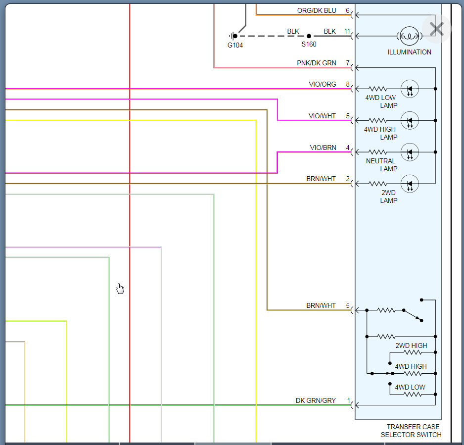

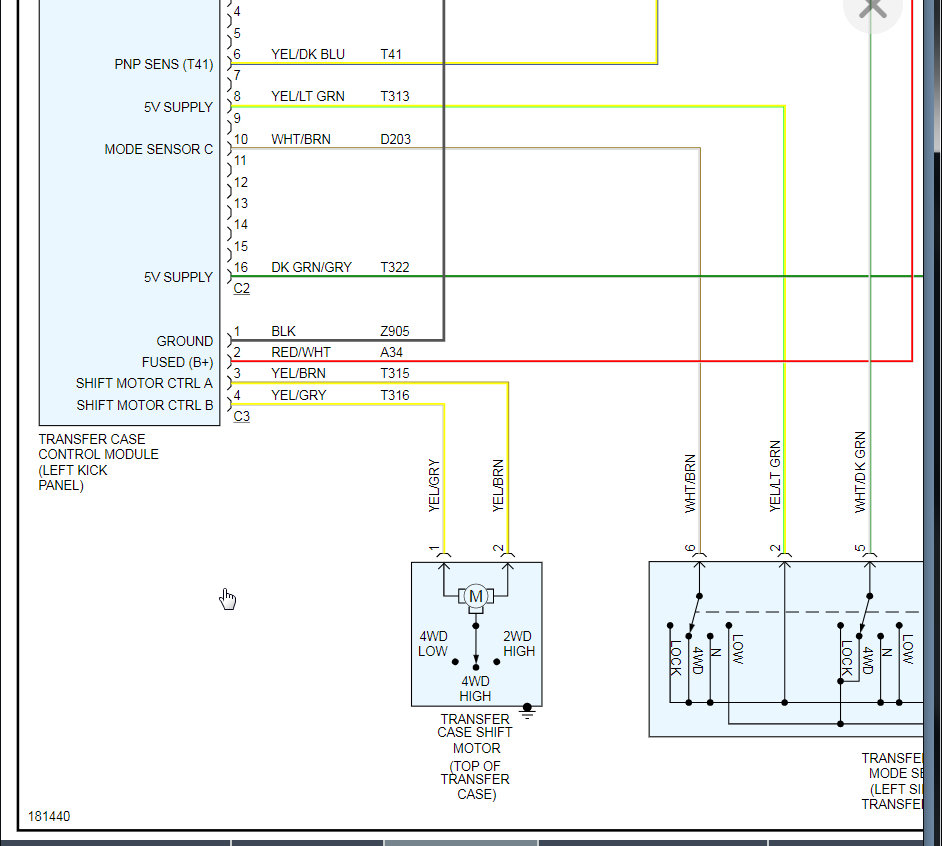

Unfortunately that is true. The only alternative is to take the wiring diagrams I provided earlier and just run new wires. I think it is pretty clear that there is a rub through somewhere and if you don't want to check for short to grounds, power, or other wires while it is acting up then running new wires is easier.

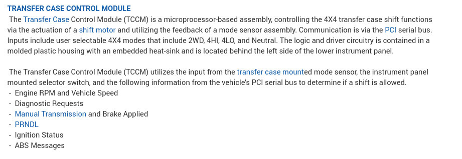

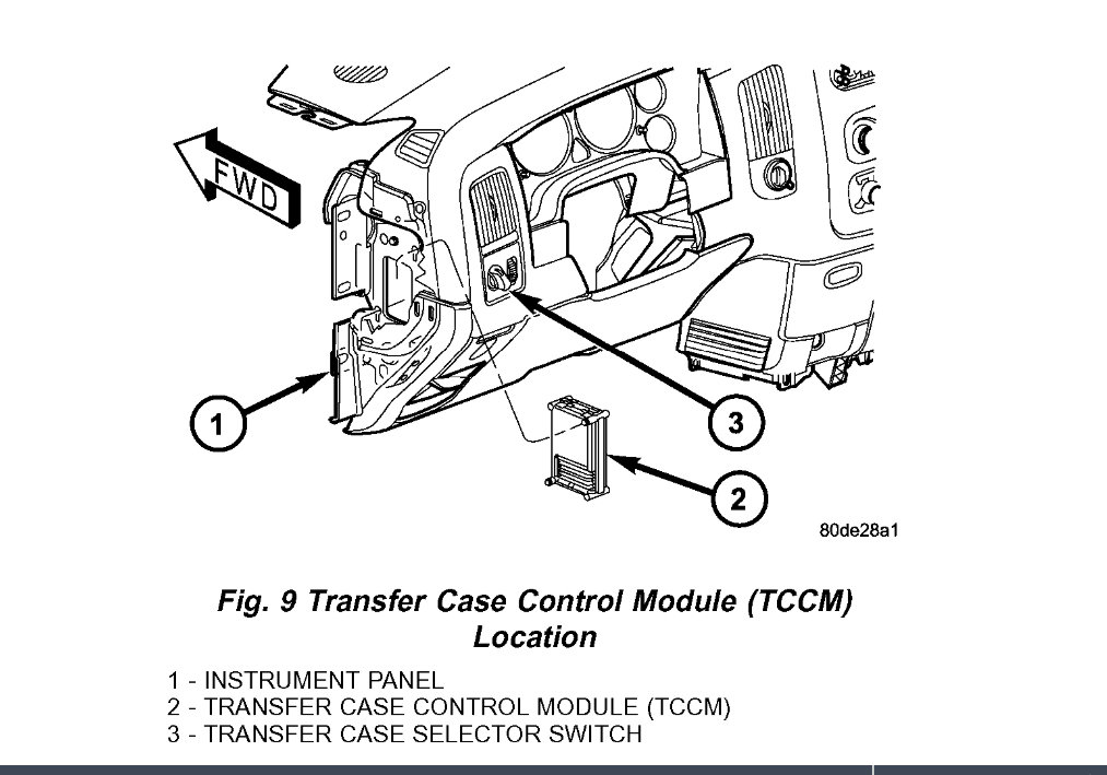

It could be the Transfer Case Control Module is inconsistent or faulty. Try a reset on the system unhook both battery terminals clamp them together wait 10 minutes and connect them back onto the battery. I'm attaching TCCM information and location below. Let us know if this information was helpful and if you need more info.
Thank you
