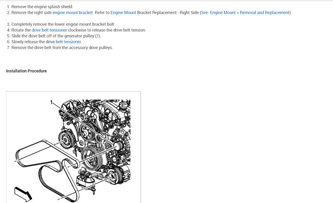

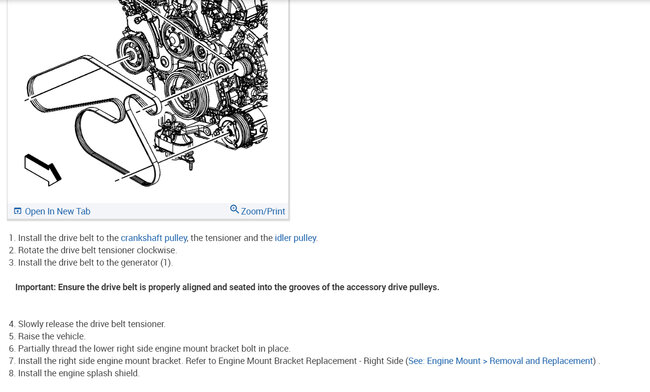

Need a diagram for belt to be put back on and easiest way to put it on please.

The easiest way to install the serpentine belt is to make the last pulley a smooth one (no grooves). Here are the diagrams to help you finish the job. Check out the images (below). Let us know what happens and please upload pictures or videos of the problem so we can see what's going on.
