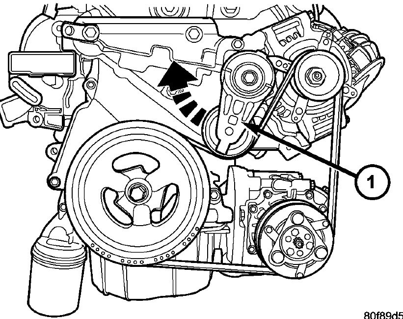

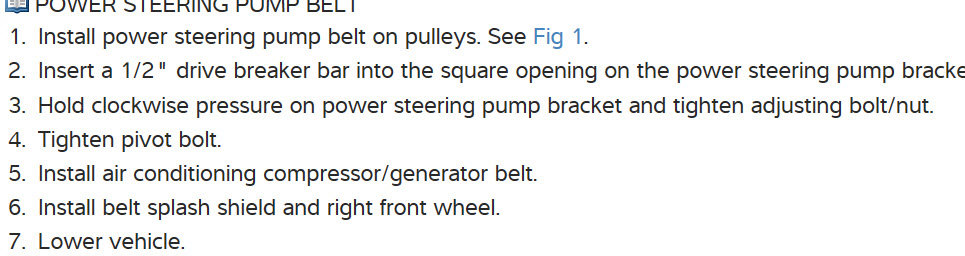

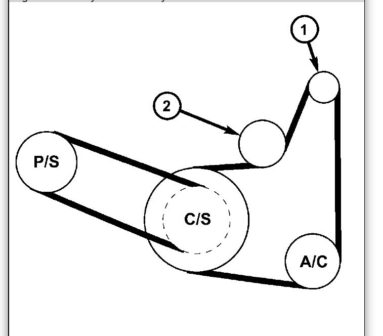

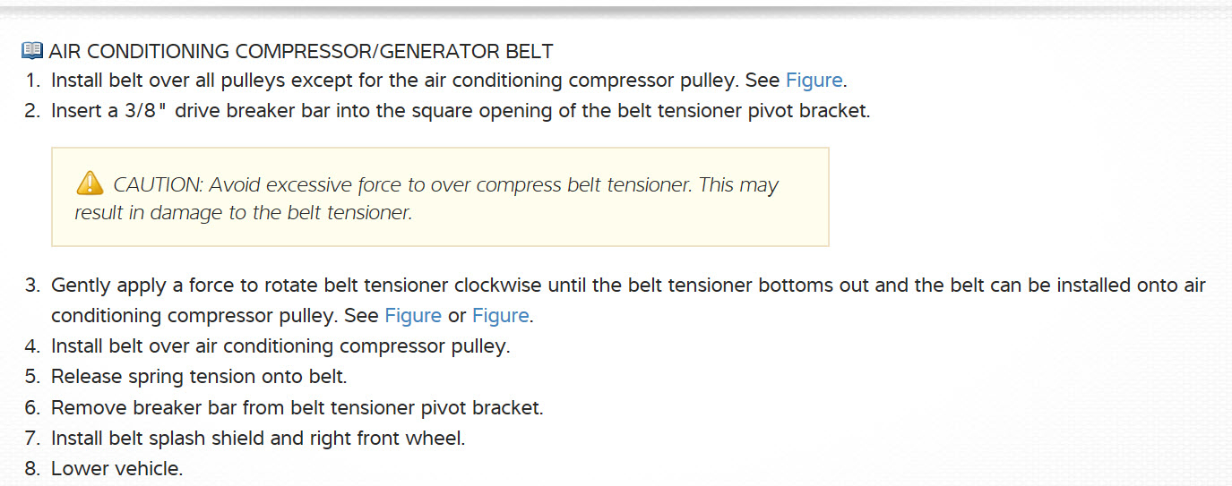

Replacement for both belts and routing diagram needed.

routing diagram should be on radiator header belts and tensioner should be replaced at 60,000 miles. if any oil is on them they are shot and should be measured by a gauge not cracks. see pictures for instructions.
