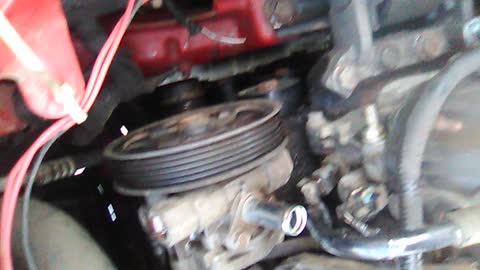

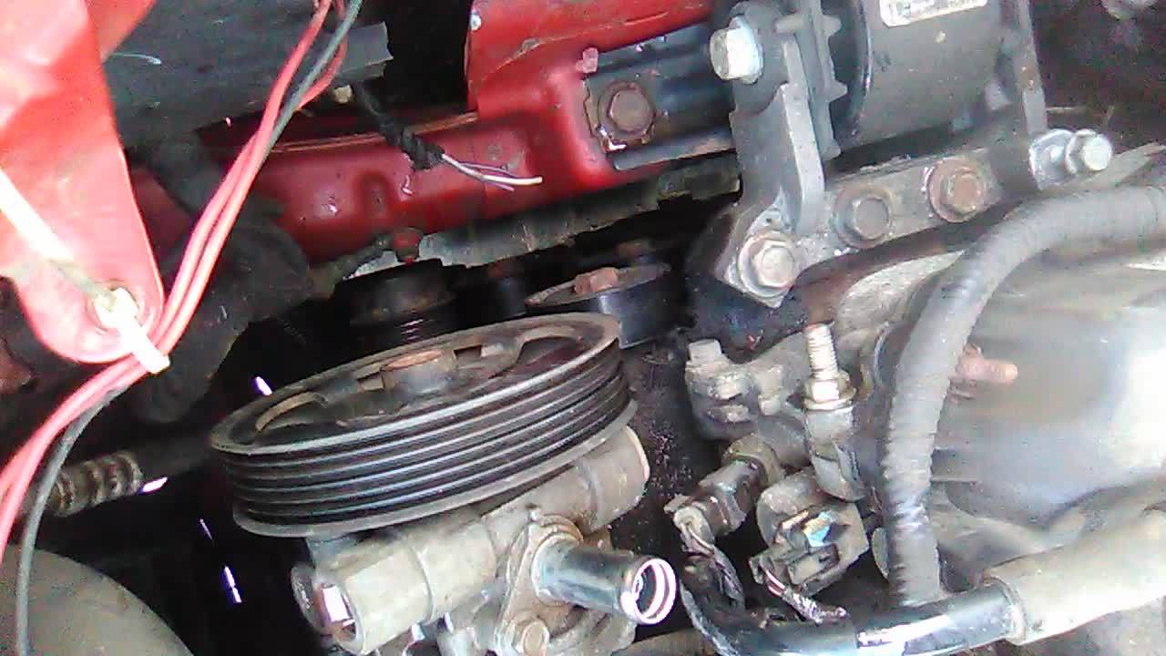

Replacing the belt, and need to know if i can safely remove the motor mount to gain access, or is this not advisable ? I've sent video...

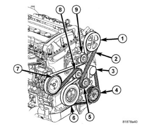

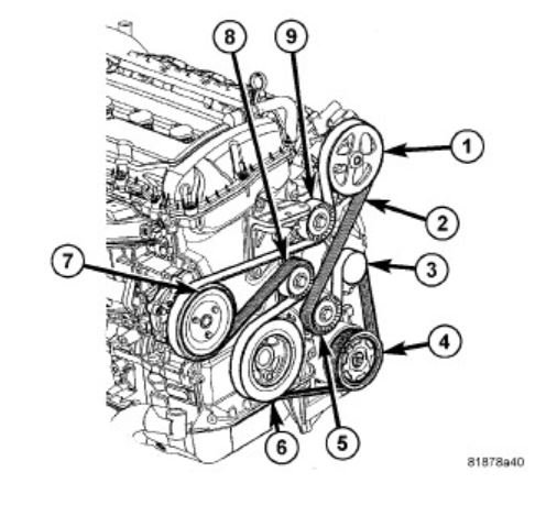

also can you provide a schematic picture of the belt routing (this is the 2.0 with A/C?)

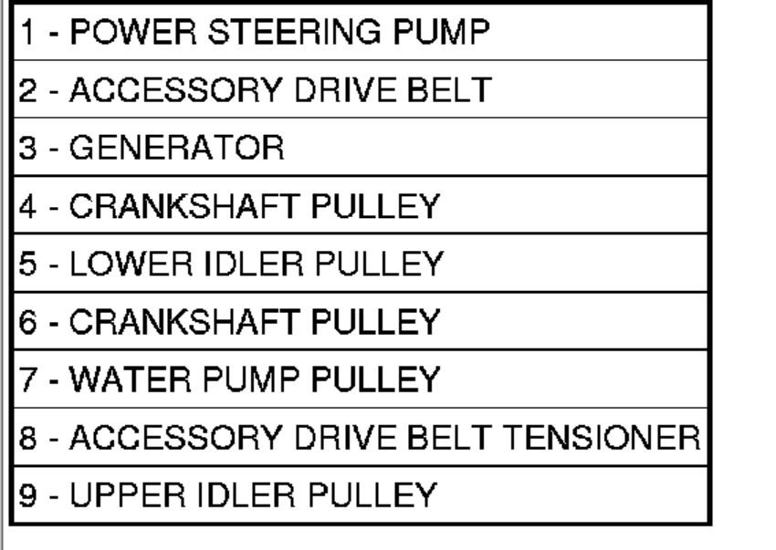

You can safely remove that mount and change the belt. Use a jack with a wood block under the engine to support it then remove the mount. I'll post the belt change info and diagram below
1. Using a wrench, rotate accessory drive belt tensioner (8) counterclockwise until accessory drive belt (2) can be
removed from pulleys (5 and 9).
2. Remove accessory drive belt (2).

Thanks for getting back to me, while i was waiting i found a YouTube video explaining the same thing that you provided, and things are worse than i imagined. I put a wrench on the tensioner pulley and it would not move, in either counter clockwise or clockward and the wheel itself is more stiff to rotate by finger than any other i can reach. I have a local garage i do business with about a 1/4 mile down the hill from me and am going to try and coast it down to him in morning. I've never had a tensioner pulley seize up like this one. I do so appreciate you all's service that i have used several times in past. God bless, stay safe and healthy during this pandemic period.
