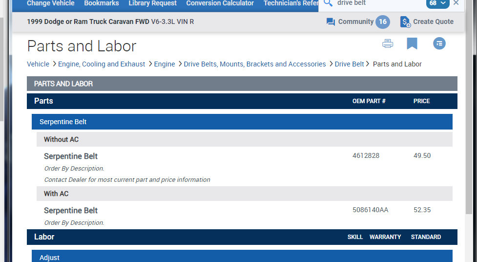

Can't use the belt it calls for it is too short. Any idea on part number for the belt with the pull substitute?
Feb 5, 2019 at 6:38 AM

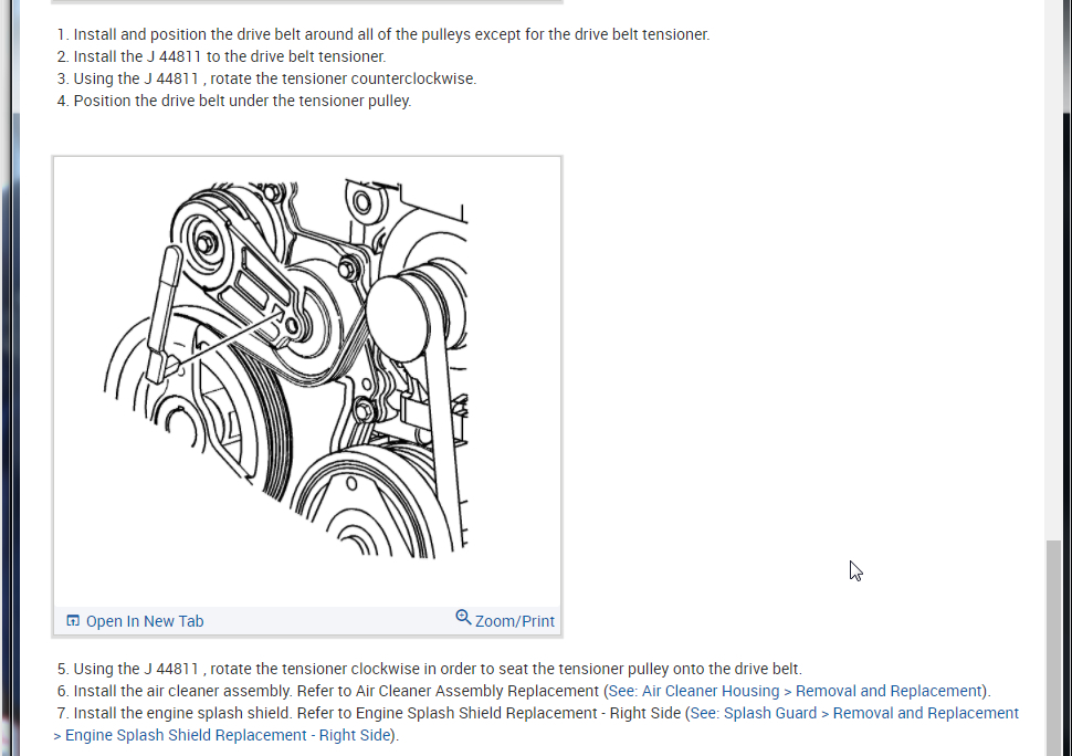

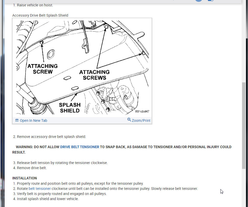

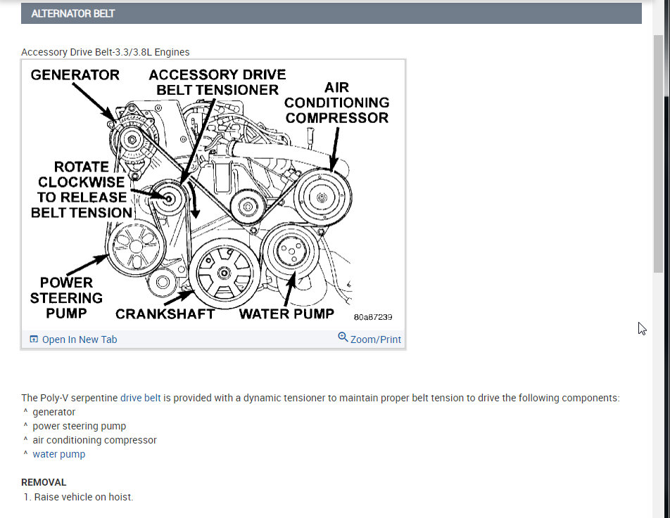

I have a feeling you got the belt for a van with no A/C. I attached the info on how to replace the belt from the manual. Plus the part number for the belt with a A/C and without.
Let us know what questions you have.
Here is a guide that will help with replacing the belt as well:
