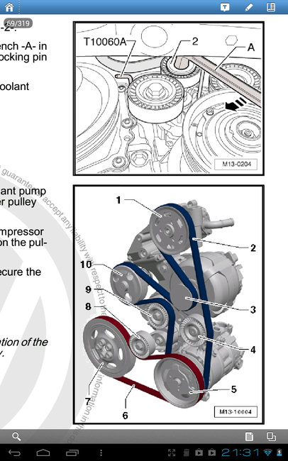

There are two. See the attached image. Which one?

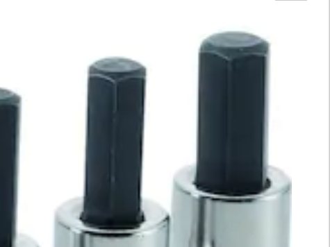

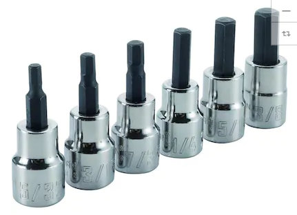

That type bolt is called an allen socket. You can use an allen set but I would recommend getting a socket set so that you can use your ratchet.
I am not sure what size but it looks like a 3/8 allen. I included a picture of the socket set so you can find what you need.
Let me know if you have questions. Thanks
