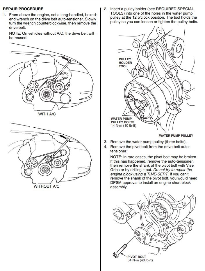

The serpentine belt automatic tensioner pivot bolt has broken off about 3 times this month, I had the tensioner replaced with one from a junkyard, it still broke off. All pulleys have been checked okay.
Dec 25, 2019 at 6:27 AM
STEVE W.
  • 15,344 POSTS

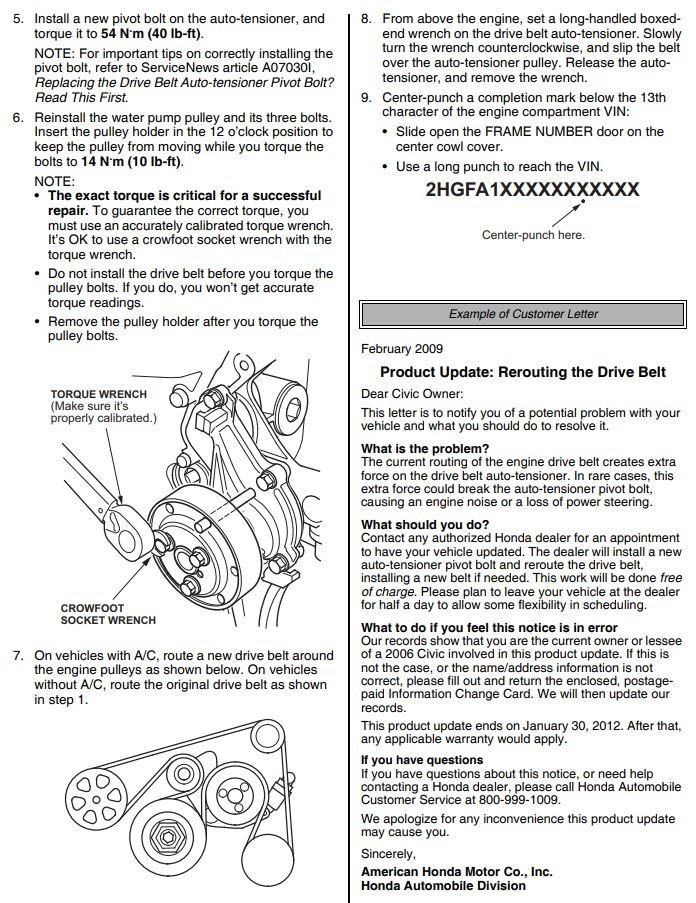

There is a TSB out for this problem and it involves routing the new belt differently than stock and using a different belt if you have AC. Try it and see if the tensioner stays together.
