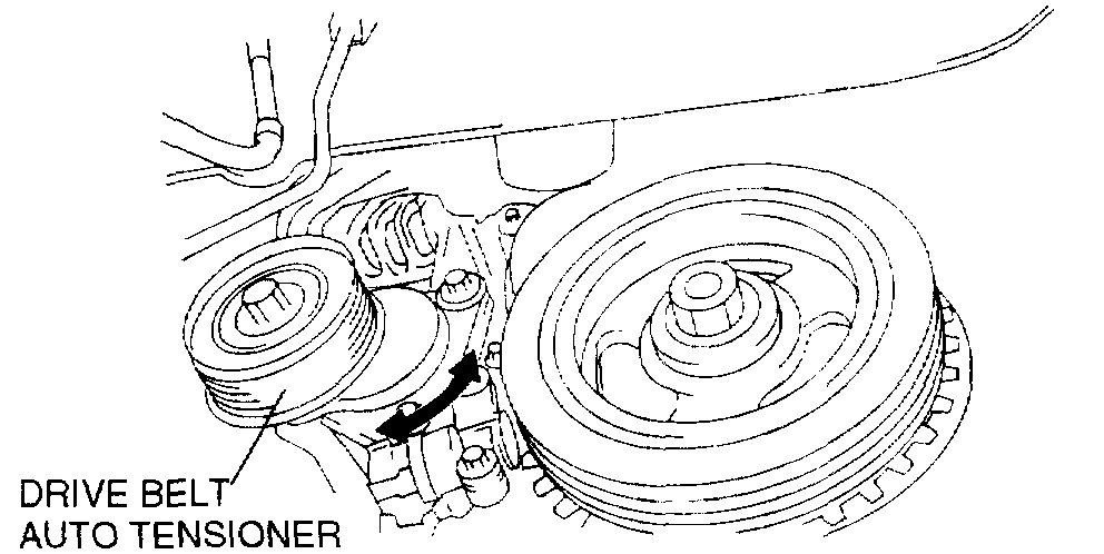

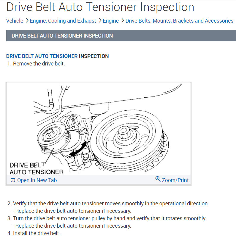

Here is information for testing the belt auto-tensioner. I realize you replaced it, but confirm it is working properly. The attached pic correlates with the directions.
_____________________________________
2006 Mazda 6 L4-2.3L
Drive Belt Auto Tensioner Inspection
Vehicle Engine, Cooling and Exhaust Engine Drive Belts, Mounts, Brackets and Accessories Drive Belt Tensioner Testing and Inspection Component Tests and General Diagnostics Drive Belt Auto Tensioner Inspection
DRIVE BELT AUTO TENSIONER INSPECTION
1. Remove the drive belt.
pic 1
2. Verify that the drive belt auto tensioner moves smoothly in the operational direction.
- Replace the drive belt auto tensioner if necessary.
3. Turn the drive belt auto-tensioner pulley by hand and verify that it rotates smoothly.
4. Install the drive belt.

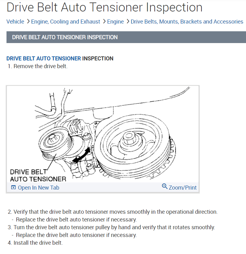

Here are directions for testing the tensioner. See if it helps.
3. Turn the drive belt auto tensioner pulley by hand and verify that it rotates smoothly.

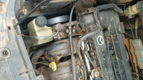

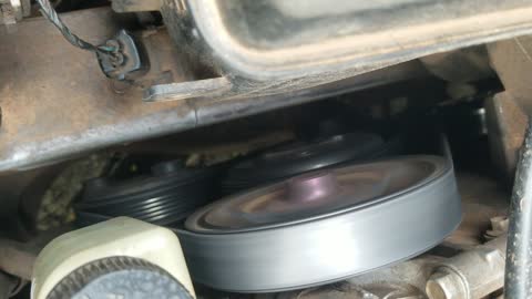

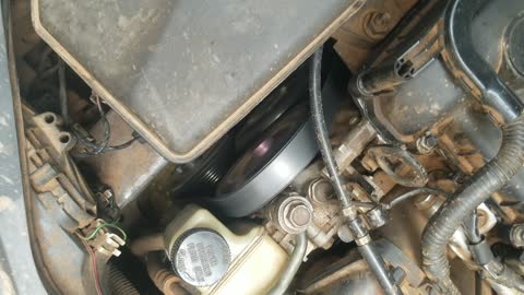

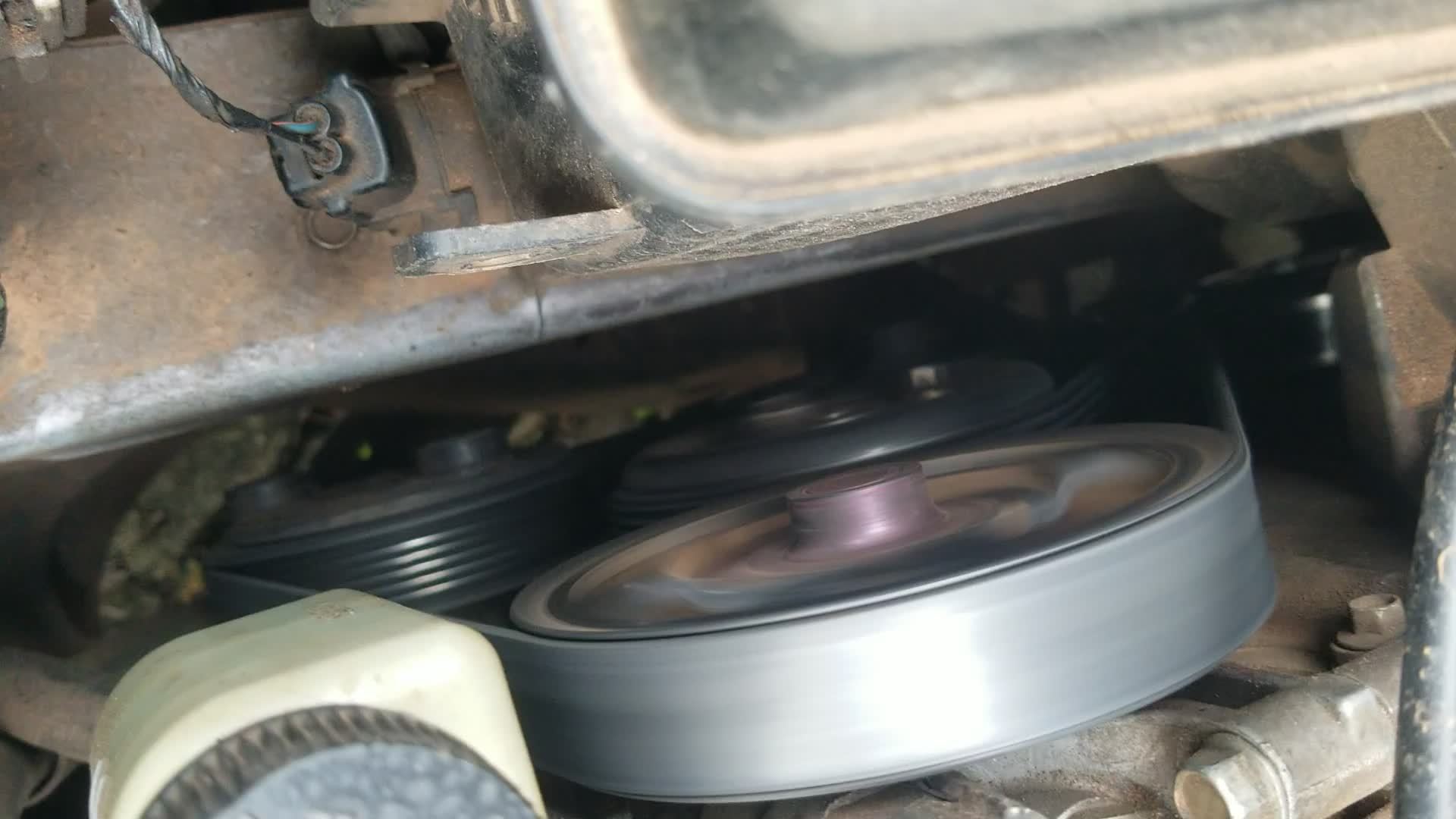

this is a video at startup. A workmate was suggesting that maybe it could be the crankshaft pulley, does the crankshaft pulley squeal?

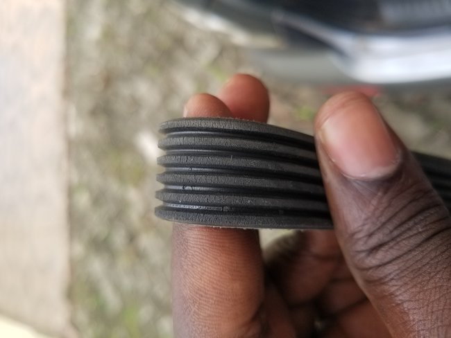

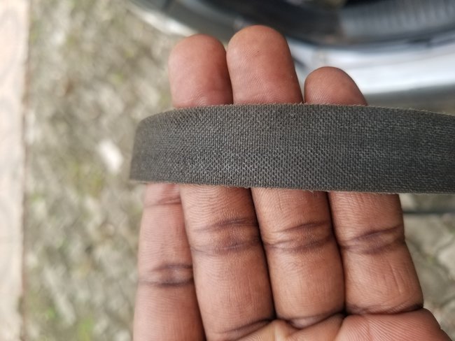

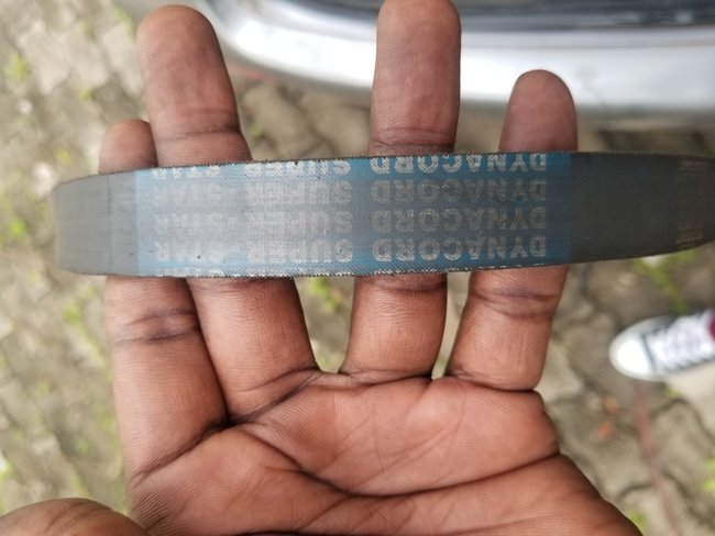

This one is the original belt i removed from the car. (6PK2275)

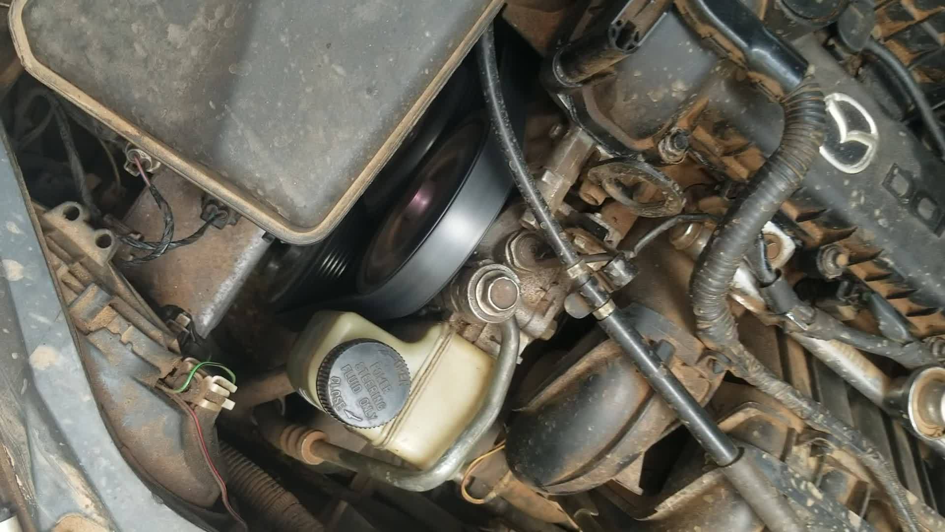

KAOMA CHENGE
  • 12 POSTS

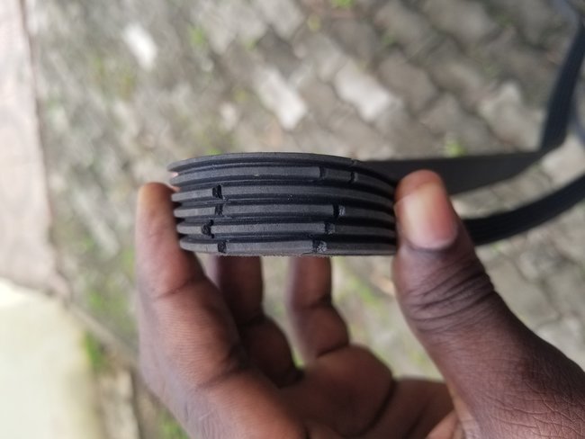

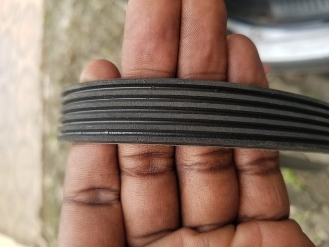

The images below is the smallest belt (6PK2260) I tried on, just to see if the squealing will go away but did not go away, after using it for about 3-4 weeks I decided to remove it and found it had cracked up not sure if the tension was too much. I tried it because when I visited the link below this was the size showing up for my car.
https://www.buycarparts.co.uk/mazda/6-gg/16685/10531/v-ribbed-belt
The size of the original belt that came with the car is 6PK2275.

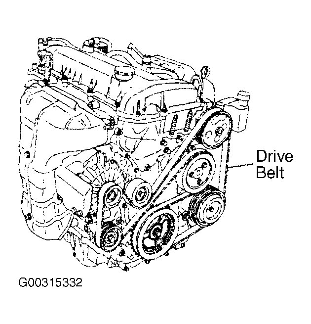

I cannot find the belt routing for his vehicle.
Maybe y'all can!
Just to throw something in there that may not be obvious.
I have seen other vehicles whereas just putting the belt on the way one might "think" it should go, the belt would closely fit and the tensioner might provide some tension.
In all actuality, the belt was routed incorrectly,
If it had been correct, the tensioner's "turned or twisted" position would have been "clocked" as it was originally and tension would have been correct. (does that make sense?--I don't mean the tensioners mounting, I mean its movement in order to hold the belt)
I had seen this misrouting on other cars, and when through trial and error or finally finding a diagram, we used a magic marker to draw it in a conspicuous spot under the hood so that the confusion would not happen again.
Just a thought.

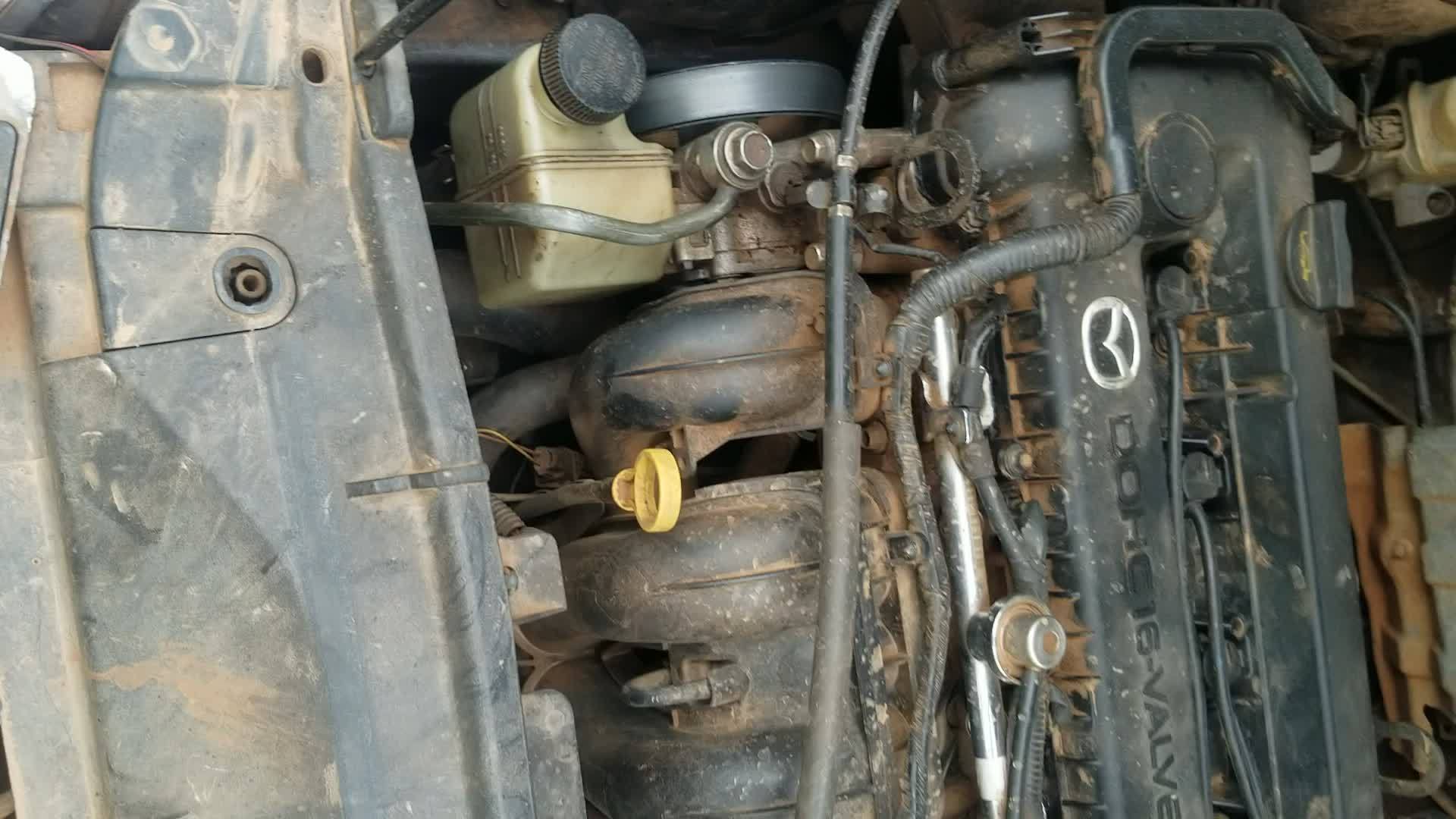

KAOMA CHENGE
  • 12 POSTS
Hi Medevac, the image below shows the diagram on how the belt sits on my vehicle, and it is routed exactly as seen in the picture.
Jan 26, 2021 at 3:49 PM
  • 55,433 POSTS
the belt in the picture is no good please install a new unit, also once installed check the tension. Can you please shoot a quick video with your phone so we can see what's going on? that would be great. You can upload it here with your response.

that does not sounds like a belt issue, I would remove the belt and turn each accessory by hand to see you you can find the bad bearing in one of them I suspect the belt tensioner or idler pulley is bad. Check out the diagrams (Below). Let us know what happens and please upload pictures or videos of the problem.
Feb 1, 2021 at 3:06 AM
  • 110,244 POSTS
I listened to the video and did hear it. If the belt is tight and good, something must be on the pulleys. Make sure nothing is leaking on them. Also, try removing the belt and cleaning the pulleys with something like brake cleaner.
