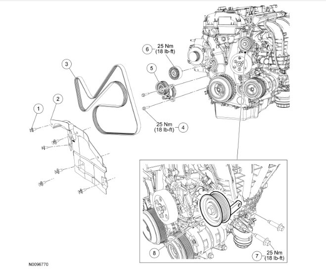

Serpentine belt routing diagram needed?
2010 FORD FUSION
230,000 MILES • 2.5L • 4 CYL • 2WD • AUTOMATIC
MATTHEW TURNER ASHBY
I can't, for the life of me, find any info on how to run it. I thought I had the new one on correctly, but it keeps popping off.
Oct 14, 2024 at 10:30 AM
  • 110,244 POSTS
The best I could find is an exploded view of the belt and components. Note that the belt is pictured how it would route.
Take a look at the pic and let me know if this helps.
joe
See pic below.
Oct 14, 2024 at 1:40 PM
