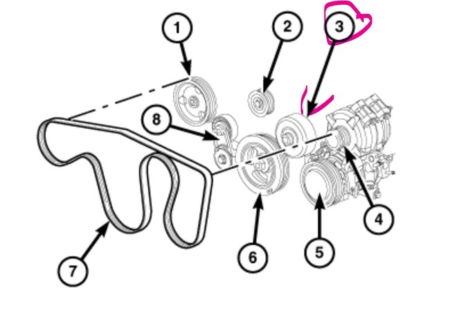

Serpentine belt route diagram needed?
2013 DODGE AVENGER
130,000 MILES • 3.6L • 6 CYL • 2WD • AUTOMATIC
ALYSSAKING161
I need the route the belt takes for my car. My grandpa is changing my alternator and my belt and needs to know how to put the belt on.

Here is the belt routing for the 3.6. When he goes to install it get it in place and leave the pump pulley 3 indicated as the last item. That way he can get the tensioner in place and push up on the belt and slip it into place. The other option is to install it on idler 2 last, but on some that is a tight area to get a hand in.
