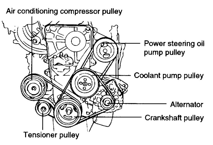

Need a serpentine belt diagram for the car listed above base model. Instructions on how to do the replacement would be awesome too.

Here is the information you've requested. This is a tutorial showing what is involved to change your serpentine belt.
Having a serpentine belt tool will help you tremendously.Most auto parts stores can loan you one. I've attached a picture below of the belt diagram.Hope this helps and thanks for using 2CarPros.
