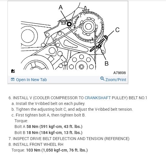

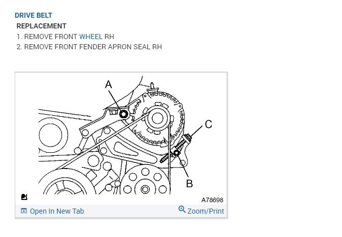

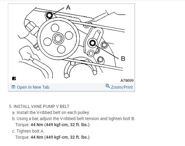

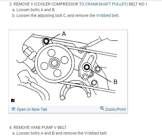

Replacing the serpentine belt only by the alternator. Do you have any videos specific to my vehicle with the procedure or instructions with pictures as to how to perform the operation?
Nov 13, 2021 at 6:12 PM
Good morning,
I attached the procedure with pictures for you for the replacement of the belt. You must remove the power steering belt to access the belt, so I would replace that as well.
