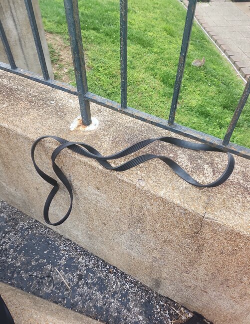

Which pulley is the tensioner

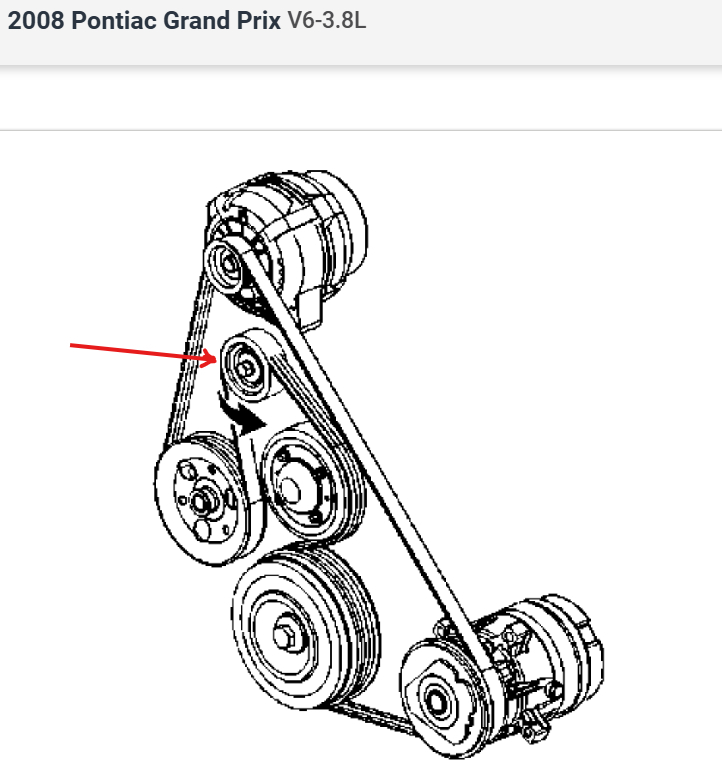

I assume you need the belt diagrams for the 3.8 correct? Here is a diagram which I marked the tensioner pulley for you and a guide to help you do the job as well.
https://www.2carpros.com/articles/replace-serpentine-belt/
Check out the images (below). Let me know if you need anything else.
