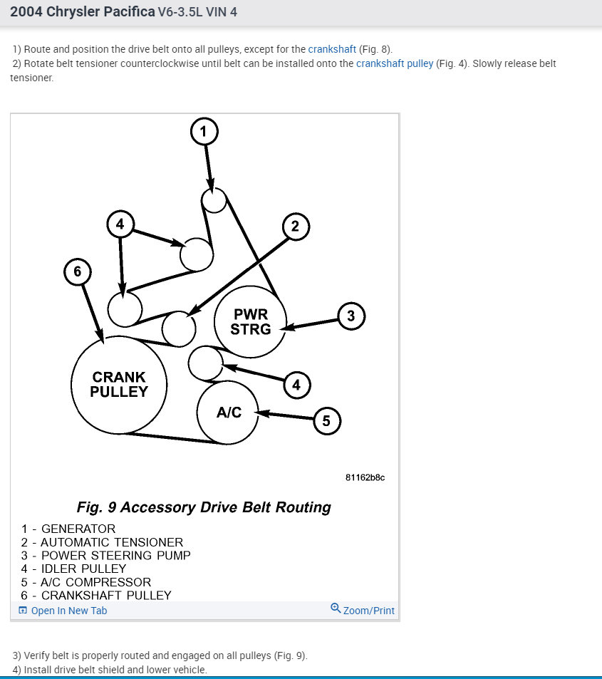

The Serpentine belt came off when the power steering pump went out so I had to replace the power steering pump and now I can't get the belt back on because I don't know how to put it back on the right way. I need help.
Sep 18, 2022 at 1:00 PM
SQM
  • 6,383 POSTS
See attached for the belt diagram and the replacement procedure.
Let me know if you are able to complete the task.
