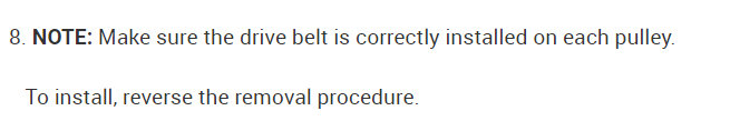

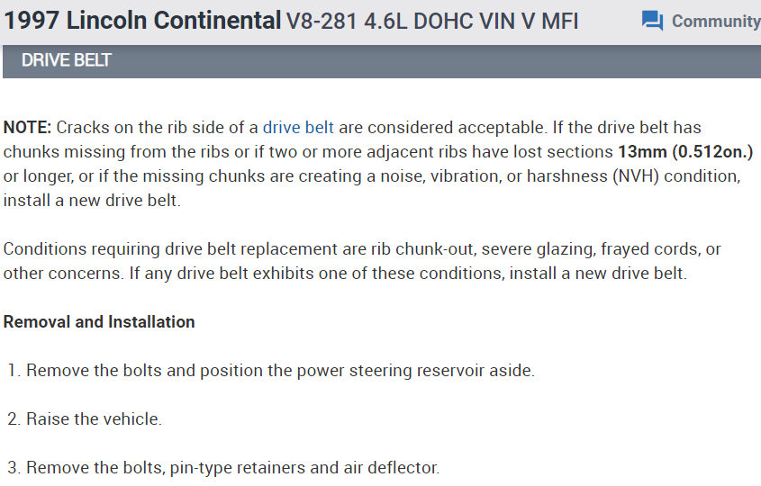

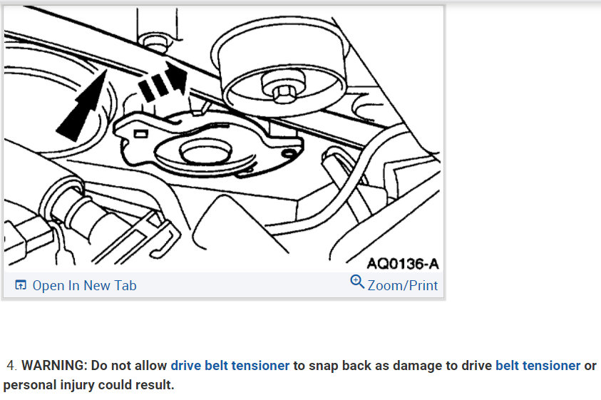

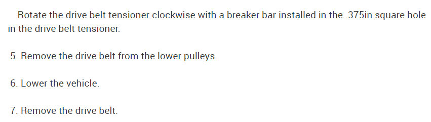

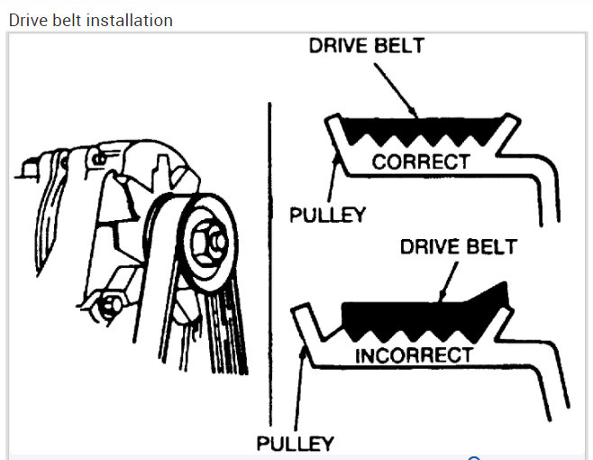

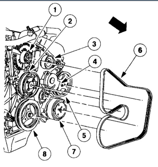

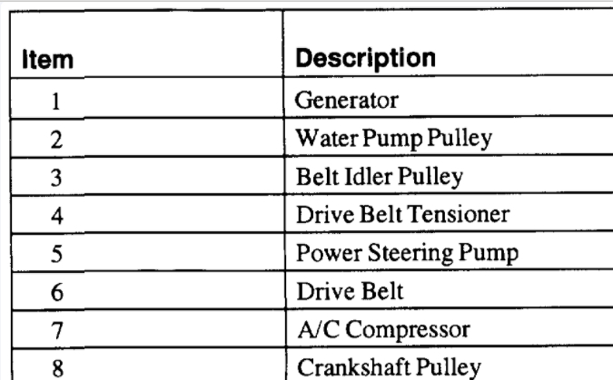

I need a step by step diagram on how to put my belt on. I’m having a lot of troubles on which way to route it.
Dec 30, 2020 at 12:10 AM
DANNY L
  • 5,648 POSTS
Hello, I'm Danny.
Here is the information you requested. First, here is a tutorial for you to view showing how to replace a serpentine belt:
I've attached picture steps below for your vehicle showing how to remove and replace the serpentine belt including a belt routing diagram. Hope this helps and thanks for using 2CarPros. Happy Holidays.
