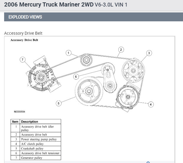

I have the vehicle listed above without A/C and need the belt pattern. Please help.

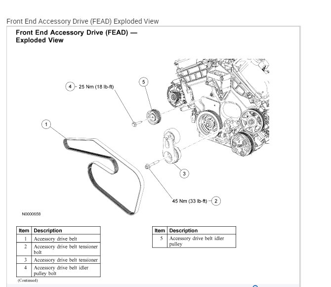

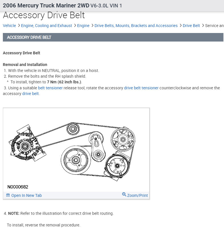

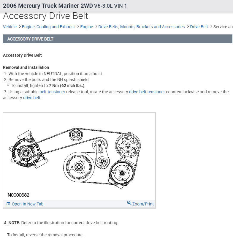

Please note that this vehicle had factory A/C for all models. So, the diagram that is available is with A/C.
However, if your vehicle is missing the A/C compressor, you can simply run the belt from the power steering pulley to the crankshaft pulley (as long it does not interfere with any other component. If you have the A/C compressor and you just want to bypass it, then you will have to make sure when you route the belt it does not touch the A/C pulley.
I have attached diagrams below for your reference.
