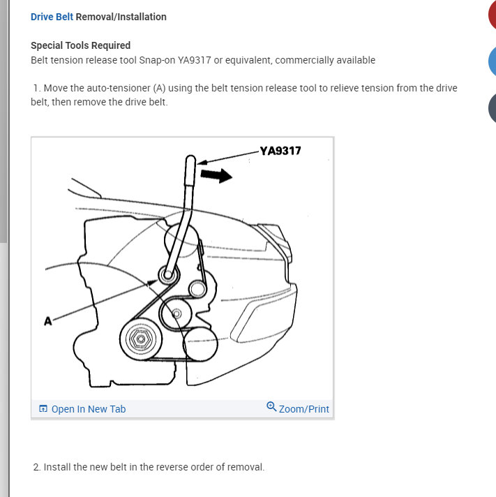

Could you send me a serpentine path diagram on the vehicle listed above with a turbo engine? We will be replacing the A/C clutch next. Thanks.

No problem. I will attach the info below from the manual for this engine.
However, here is a guide that will help with this:
Please see the info attached and let us know what other questions you have.
