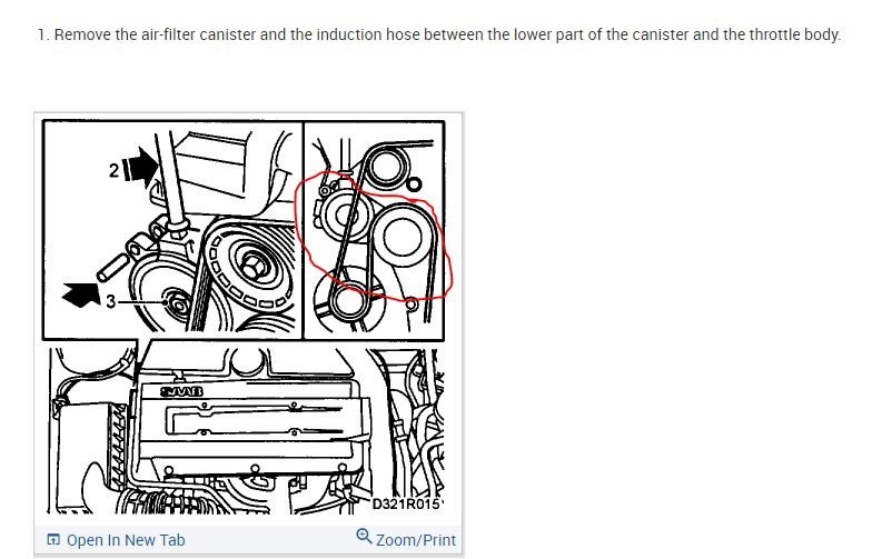

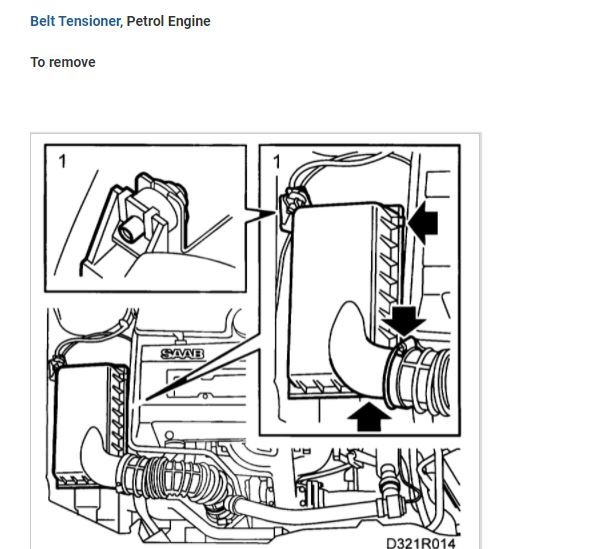

I attached the procedure for you for replacing the tensioner. The belt comes off when the tensioner is worn out and does not retain the tension.
https://www.2carpros.com/articles/serpentine-belt-tensioner-replacement

You need to replace the tensioner and the belt. That will stop the nise.
Did you clean the area and verify the source of the leak?

Yes. I would do that. That is the original issue. I am surprised the shop did not do this for you.
We always replace the tensioner and the belt together when there is an issue of noise and falling off.
