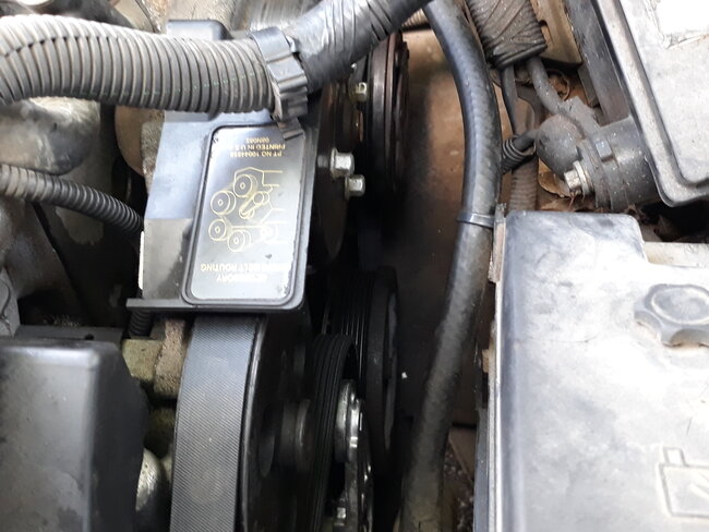

I put the old belt back on and noticed the belt was riding off the side of the belt tensioner pulley a bit.
So, I replaced it with a new serpentine belt and a new belt tensioner. As soon as I started the engine after replacement, I could see the belt still rides off to the side of the belt tensioner pulley. It looks as if the belt tensioner is not exactly in alignment with the harmonic balancer and that perhaps is what is pulling the belt off a bit?
This is an automatic belt tensioner, so I don't think there is a way to align it in any way.
I'm perplexed as what is causing the belt to ride about 1/4" or so off the side of the belt tensioner pulley?

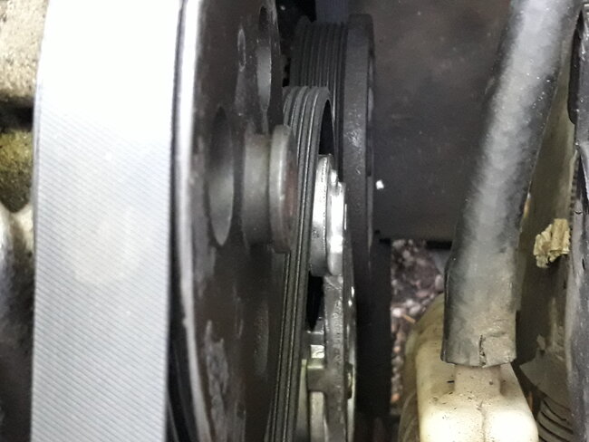

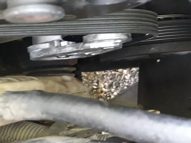

It looks like all the other pulleys are in line. I've attached some photos. If you're standing in front of the car and looking down, the tensioner looks as if it is a tad over to the right above the balancer and the belt rides about 1/4" off the tensioner to the left.
The tensioner seems to be installed correctly, there is only one way to install it with a bolt, correct? The balancer also seems to be okay. I don't see it wobbling any when the car is idling, I have not taken it off.

I do see the belt being off the tensioner quite a bit. I know it's a pain, but I would take the belt back off, and if you still have the old tensioner, you could compare the two and make sure they gave you the correct part number. Do you still have the box it came in or the part number of the new one installed? I can try to cross check the numbers and see if it's correct.
If you don't mind taking the belt off again, I would check the alignment of crank pulley to the rest of the pulleys, use something real straight to check them. If the crank pulley has broken the rubber section, the outer section of the pulley you should be able to rotate it or move it around by hand. You'll notice if it's broken. Especially if it has moved out that much. I have the OEM part number here, it's 12563084. I will look up some aftermarket numbers too.

Okay, then there has to be one of the other pulleys is off, it's difficult to see exactly from the pictures, this is the only section of the harmonic balancer I see off somewhat, Thats the trigger wheel for the crankshaft position sensor I think I see behind the pulley there. Somethings definitely not right there, the belt shouldn't be that far off the tensioner pulley. Take that belt off and check all the pulleys to make sure there isn't anything out of place. Is the Alternator bracket broken anywhere? It can really only be the Alternator pulley or Balancer pulley that would put the belt off some much like that.
There looks like there are a couple different setups/designs for this vehicle. I am coming across other people with the same issue with this vehicle, the belt is hanging over the tensioner exactly like yours is. Is the diagram below the correct routing for your engine?

It's difficult to tell from the angle if you can get your hands on the crank pulley and give it a good shake to see if the rubber ring has broken free. In this photo it almost looks like the AC compressor is in further. That trigger wheel I circled in purple is attached to the inside of the crank pulley and that triggers the crank position sensor, so it's in the right position or the car wouldn't start. But it can only be a few possibilities, like the Alternator Bracket (which I have seen crack before and was only holding the Alternator on by one bolt), that outer crank pulley or the incorrect tensioner. I know those crank pulleys do break the rubber section apart like the photos I posted. I mean that one is an extreme case, it's actually missing the rubber section that would be holding the center section to the outer pulley ring. Really the best thing to do is to pull the belt back off and check everything. Because whatever is causing this will eventually break and leave you stranded somewhere. I can see that belt coming off too,
One of the pulleys has to stick out at least a 1/2in more than the rest for the belt to be so far off the tensioner. I just don't want to see you get stuck somewhere. The Alternator bracket is pretty tall, so if there's a bolt on there that is not tightened all the way in on the lower section, which will cause it to pivot out up top.
